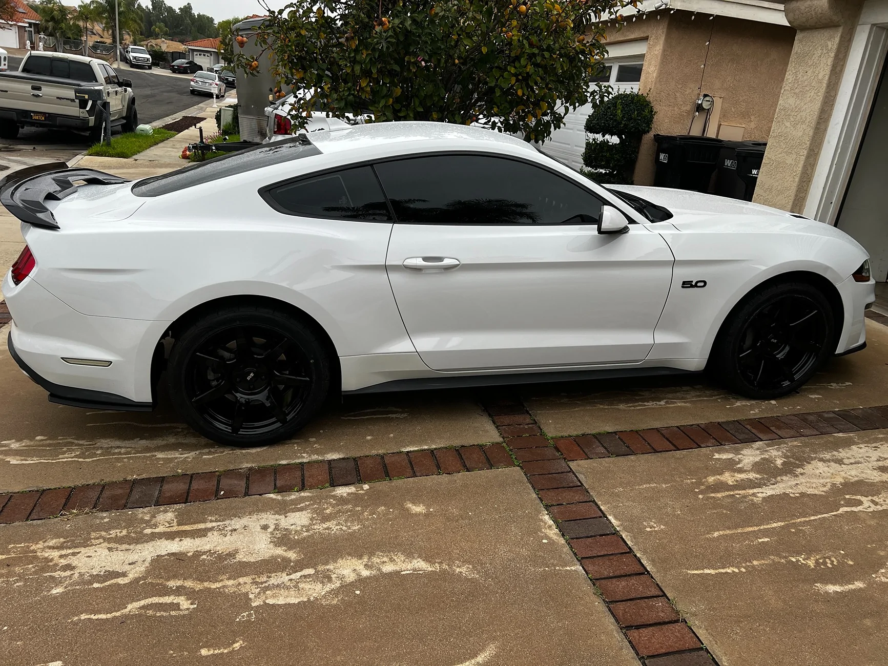

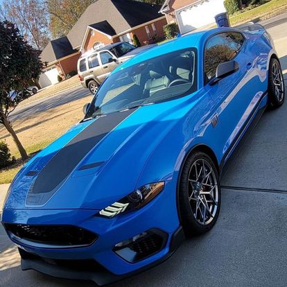

I’m running squared Shelby SB203’s (19x10.5 +45) with 20mm spacers in the front. Tires are Atturo AZ850s (285/35R19) and dropped it 1” with S&R springs.
2021 GT:

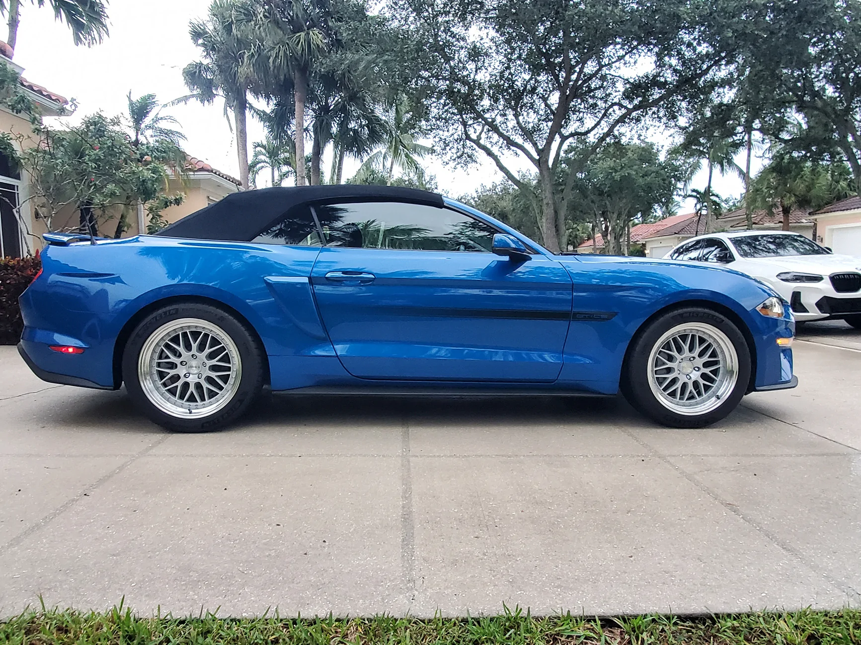

19x9.5 +30 with 275/40's fit just fine on stock suspension.

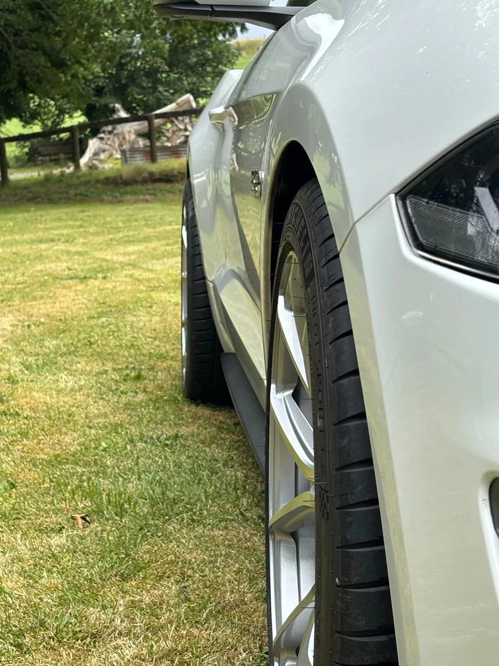

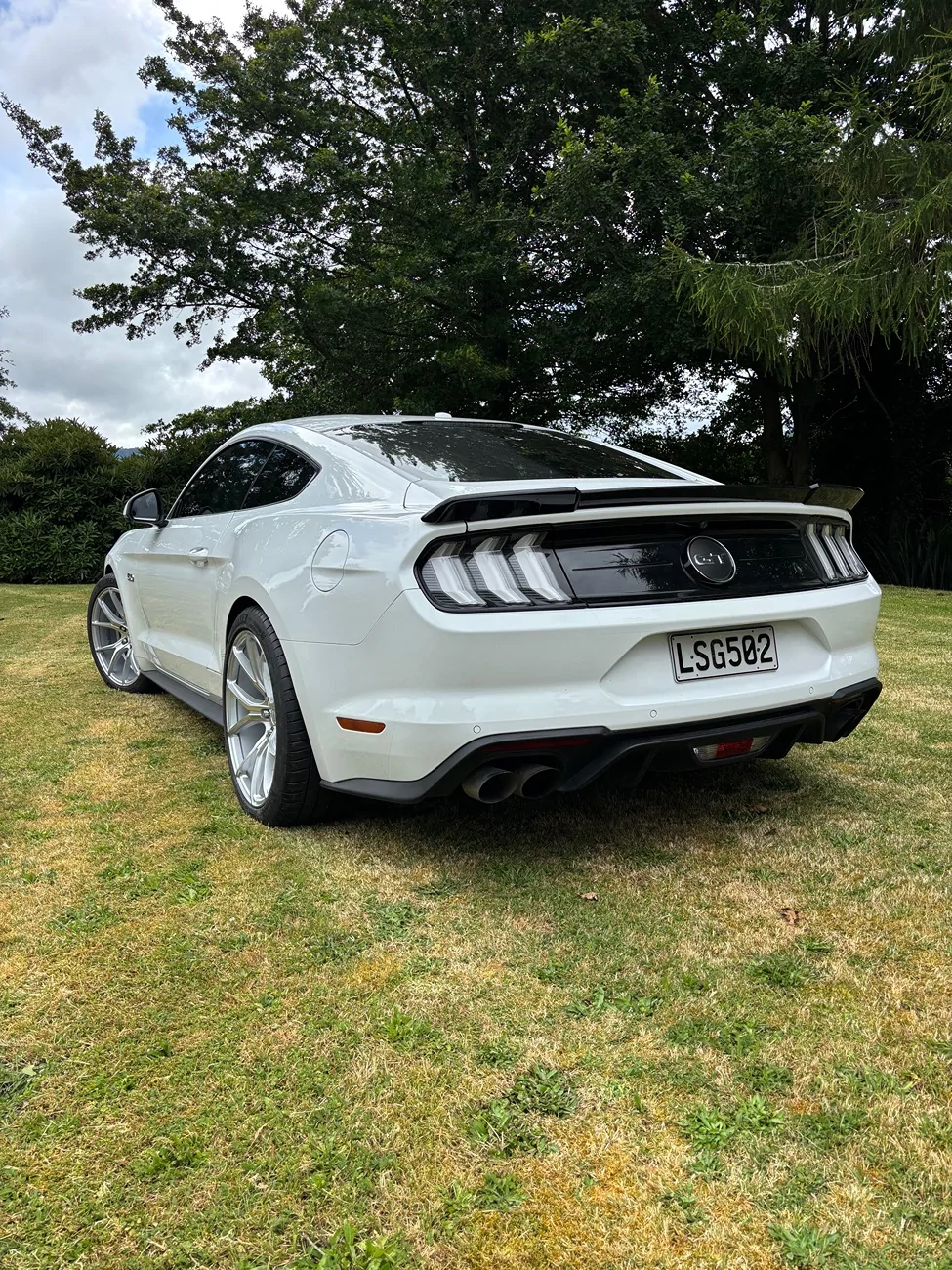

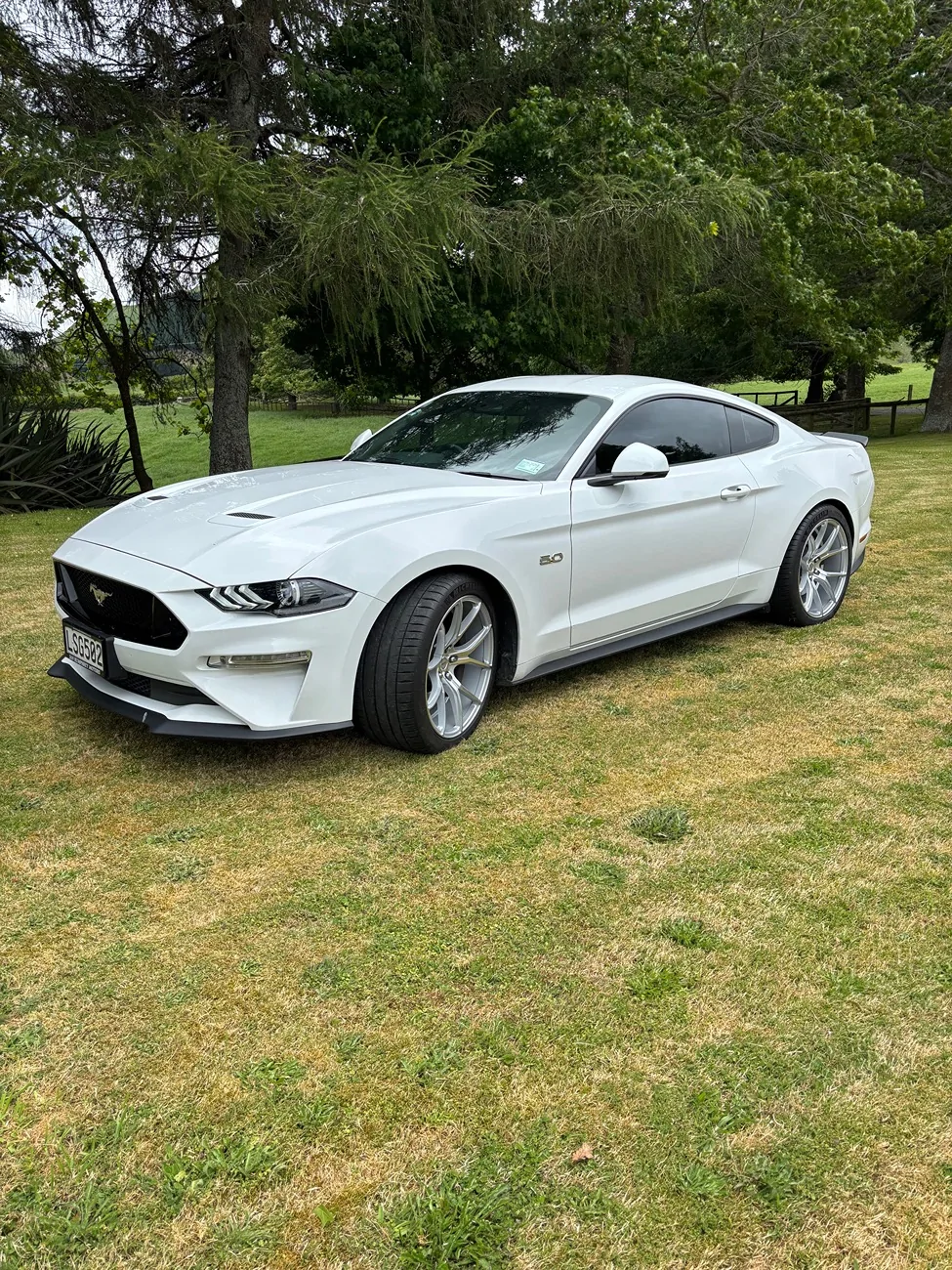

I know you are looking for pics of 19” but here’s some 20x10 et35 all round with 285/35 tyres. Stock suspension. No rubbing. Good luck with your selection.

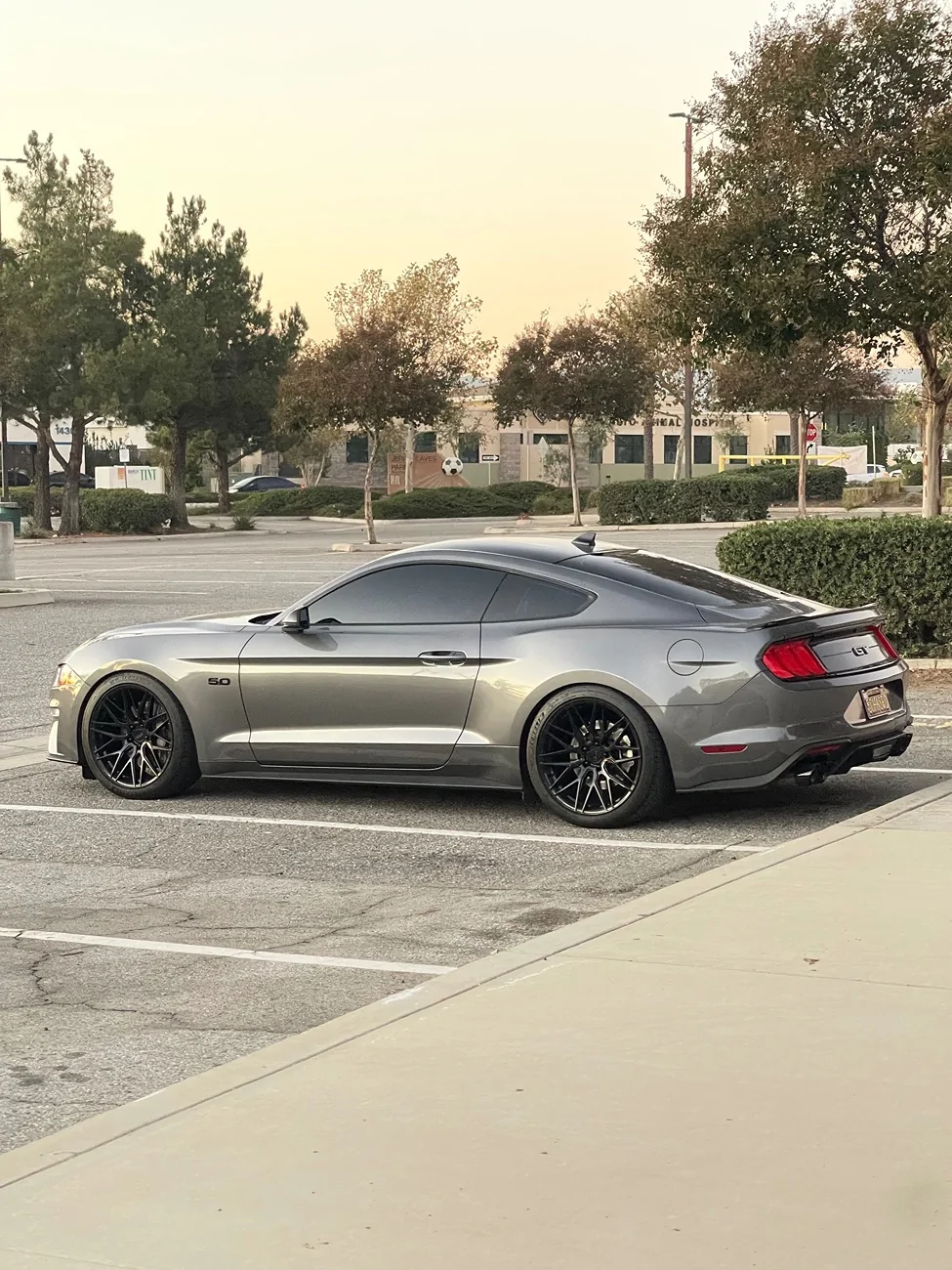

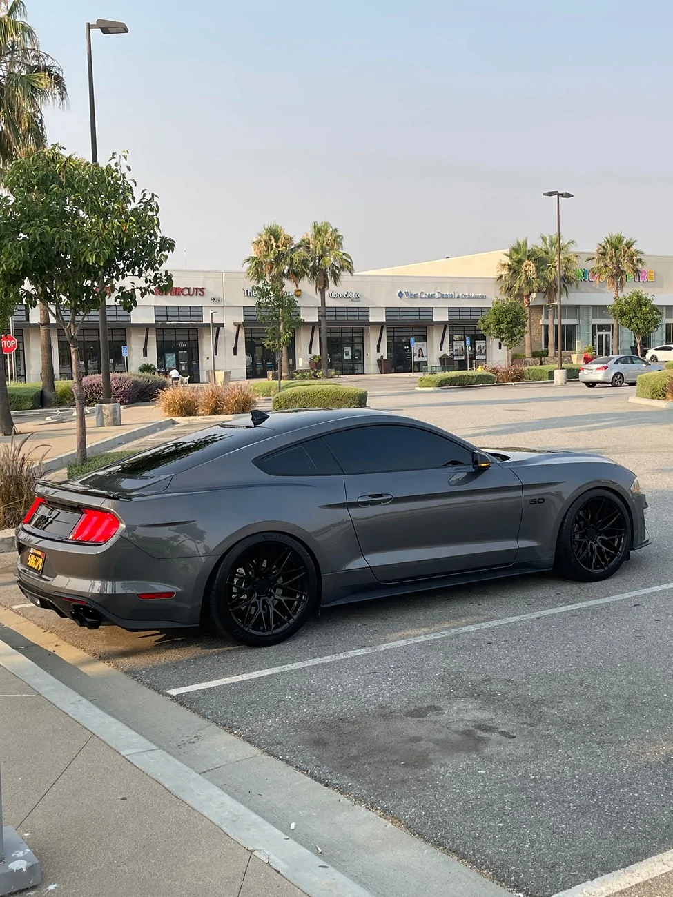

Thank you for all the responses and the reality check ;)

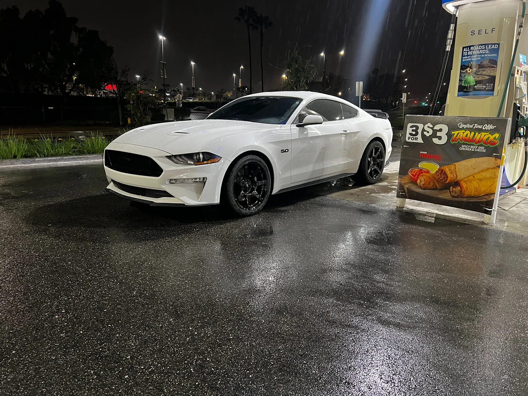

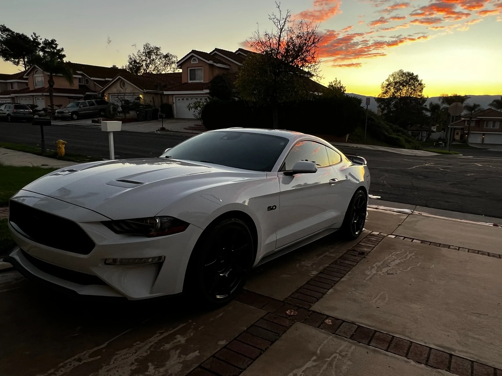

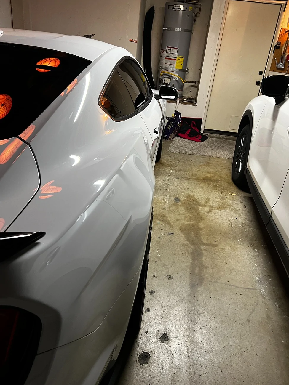

I actually had the SVE 19x10 / 19x11 package in mind to just have peace of mind and a more functional and flush fitment so your guy's comments pushed me to give up the expensive for no reason JDM wheels and go for it. Couple pics on stock base GT suspension.
