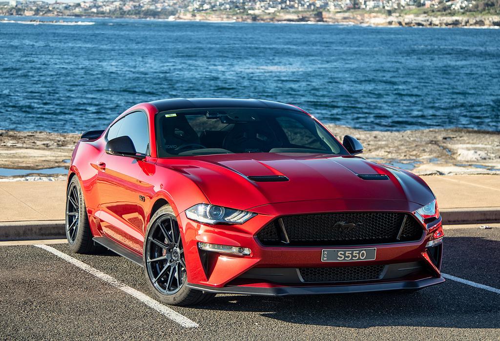

Either one will be fine, Magride doesn't change anything in terms of sizing. If you go 20s you will have to go with a lower profile, and sacrifice a little ride comfort.
I have an aftermarket set of 19s with the stock Michelins, which are great. Ultimately I will get another set of wider wheels down the track though, and it's a coin toss between 19s or 20s. Springs and sway bars are being installed today, so that will probably govern whether I need the extra sidewall for daily driving

Hey there, I have the exact same car in Magnetic. Which wheel brand/design did you buy, and are they the same offset as the factory Performance Pack wheels (9" fronts with 45mm offset and 9.5" rears with 52.5mm offset)?

I have a set of Koya SF04 in 19x9.5 +30 and 19x10.5 +45.
Thanks, looks sharp. I'm guessing you have less offset to allow for the wider rims. No problems with clearance anywhere?

No clearance issues. These widths are no problem at all. I had 20x9.5 +30 and 20x11 +55 on my last car.
