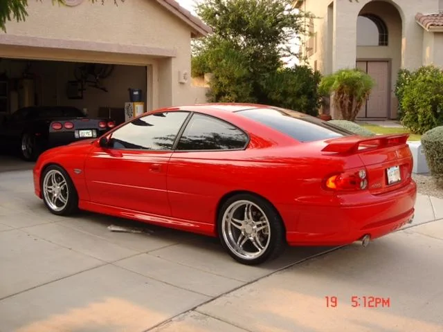

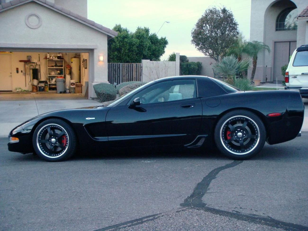

I did the same thing on my GTO and my Corvette and was thinking about it on my Mustang. Every time I speak to a wheel dealer they do everything to persuade against it. If you go with a deeper concave wheel on the rear and they are both the same diameter the rear wheel will tend to look smaller. I would like some of the wheel dealers to explain why they try so hard to dissuade from using two different diameter wheels.
