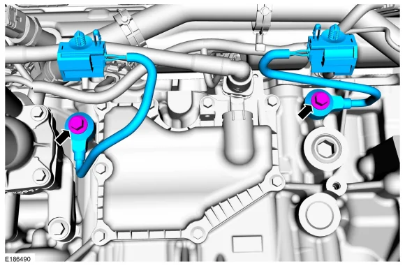

It's mainly when it's misfiring that it gives random codes. When its just jerking and stalling it doesnt throw a code. Every now and then when It stalls it'll misfire pretty good. The only code I get consistently is p0332(knock sensor 2). A location on that sensor would be great. Other than generic codes for the bcm and rcm (completely different issue) there are no consistent codes. I was able to pick up that the knock sensor was fluctuating way more than it should as well as the low pressure sensor was fluctuating higher than it was supposed to. These are the only issues my scanner has been able to pick up.

There are 2 knock sensors on the 2.3L both being under the intake manifold with sensor 1 between cylinder 1/2 and sensor 2 being between cylinder 3/4 as seen in attached image. You likely have a bad knock sensor 2 that is giving erratic reading causing misfires and stalling/jerking. It's the one at rear side of engine to the right in pic.

Thank you for the location. Ive been looking for it for a couple weeks now and all i could find were locations that didnt make sense.
