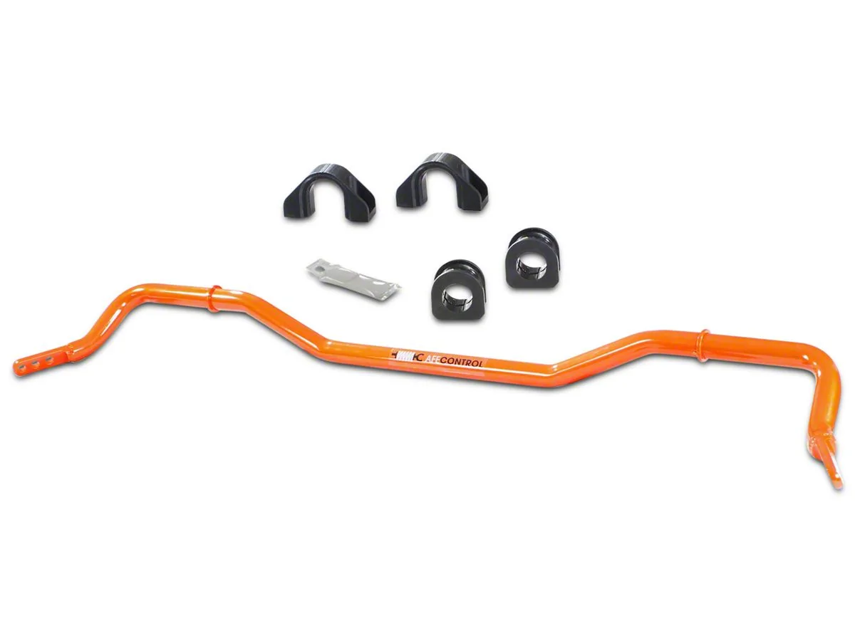

Afe rear sway bar 32MM HOLY CRAP!

I wouldn't touch the rear sway bar unless you had a BMR lockout kit or Steeda IRS supports first and if you're that damn good of a driver. The rear bar seems to be well matched to the car. Maybe rear sway bar end links

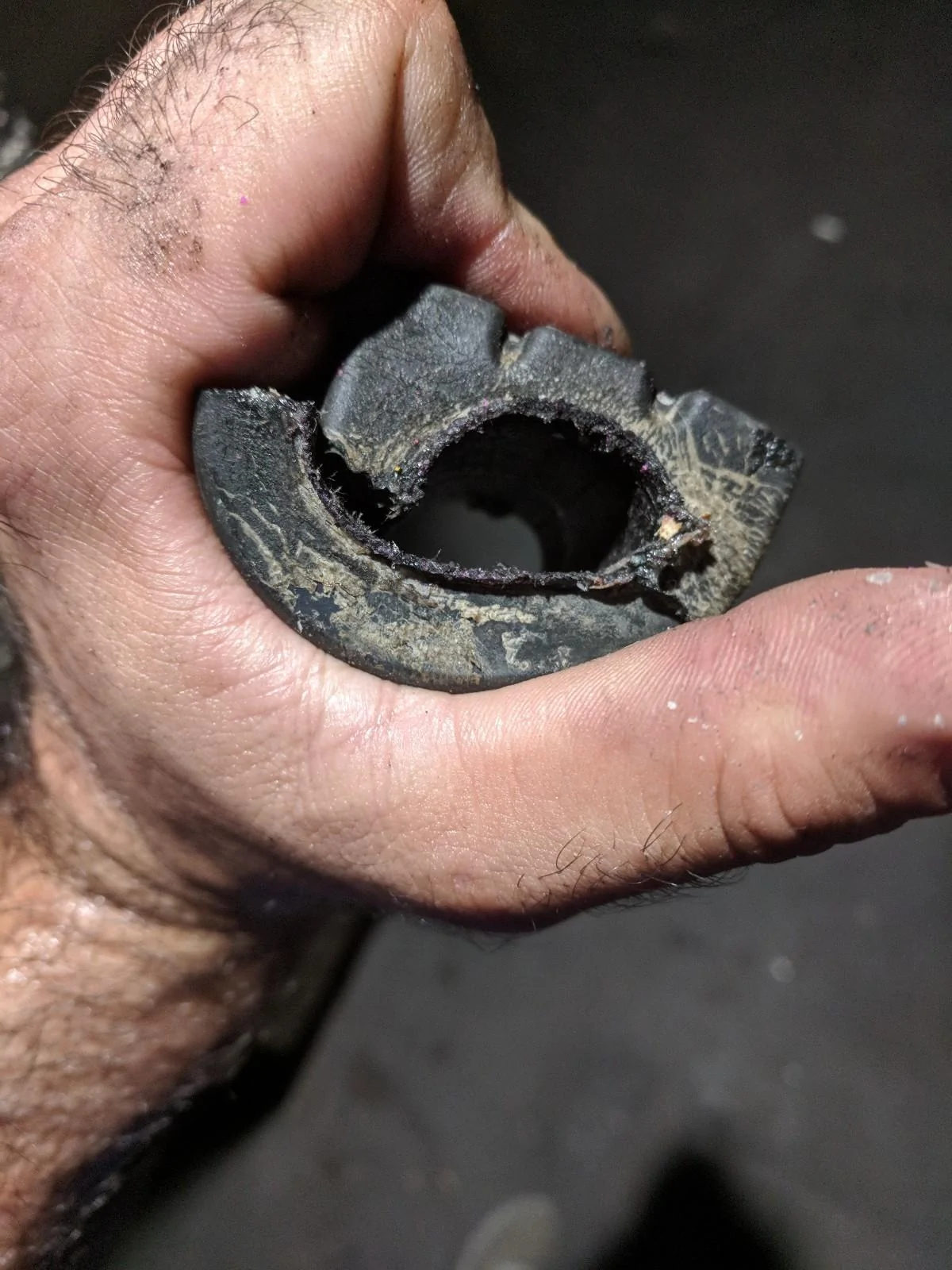

I have the frpp sway bars and steeda rear support. But the bushings flex Big time on the rear sesy bar and the brackets are undersized.

That is a big bar. I would start out full soft.
I'm considering slightly more rear bar on my car but I'd want to couple it with more rear aero. At my home track the car doesn't like to rotate in the slower stuff but at speed it pushes the back end. I think extra aero and a heavier bar might help out in both places.

No bushings at all for the frpp 25.5mm. when the car is jacked up I push down the sway bar and you can see the bushings flexing.
Either the steeda 28mm bar with derlkn bushings or the afe.

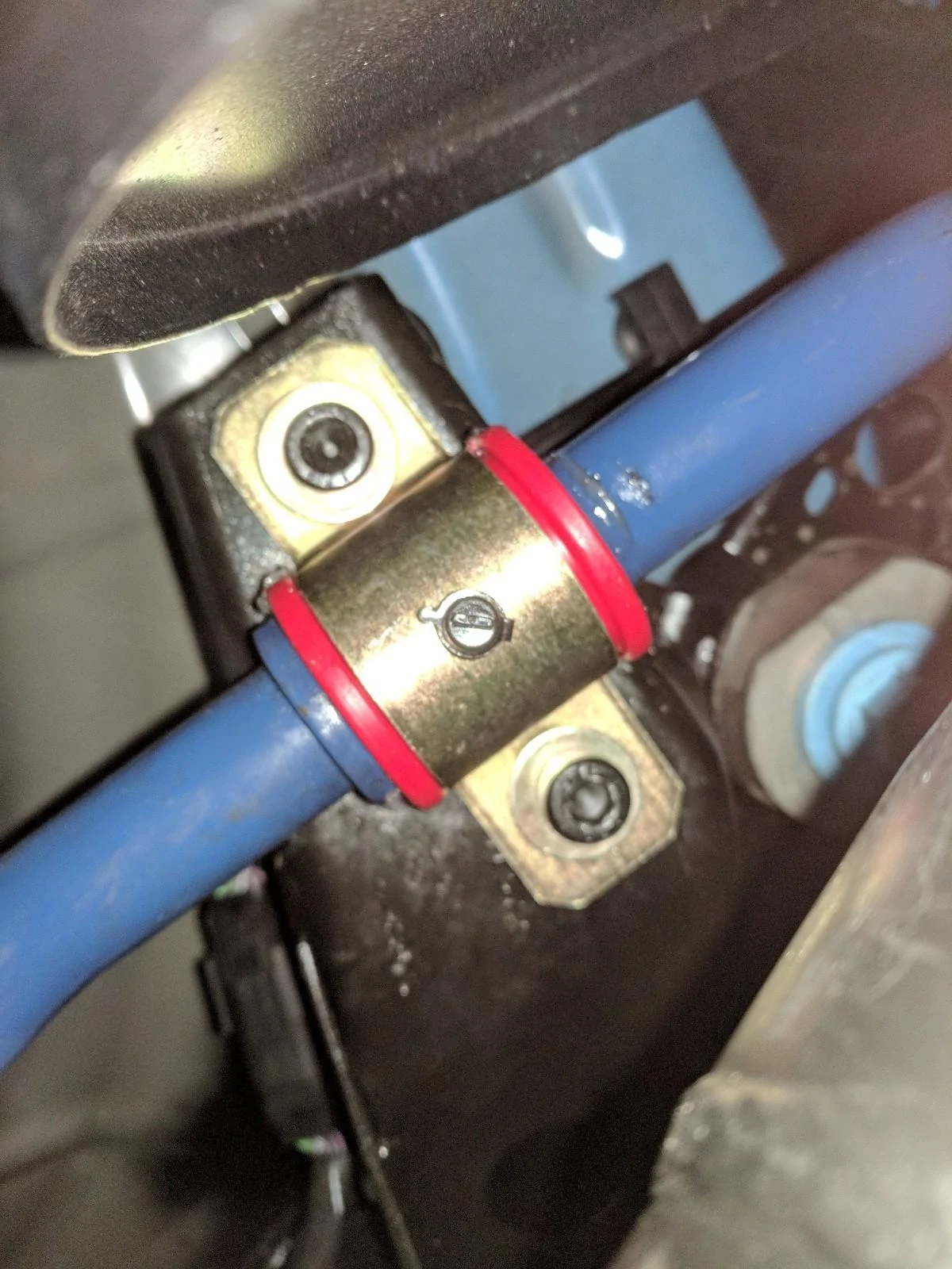

Garbage frpp bushing vs prothane. Frpp rear sway bar is 25.5mm. prothane is 25mm and it fits perfect. $22 from AutoZone fora pair with brackets.
