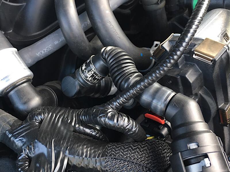

Anyone install this and have an issue with the engine side hose being too long? Note the crimped bend?

Until I can get out to check, I remember that like most people here I had to invert one hose. Can't remember if it was driver or passenger though.
Edit. It was passenger.

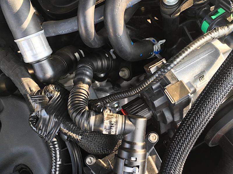

Inverting does look better. Still slightly nervous about airflow thru this bend:

Indeed. I have the FP passanger side as well, was my first mod, and I have had zero issue so far. Did the exact same thing.

Thanks for the picture of the inverted hose on the passenger side. I did mine today, and that works better!

I wouldn't be concerned. That hose is on the vacuum side of the intake; a large percentage of the time, it will be sucking like a....
