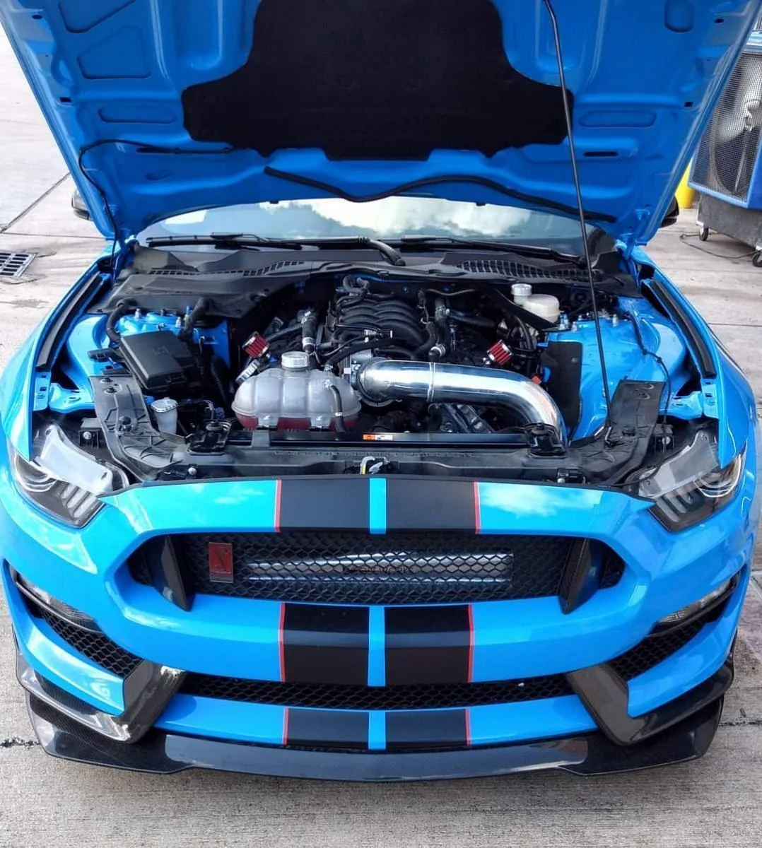

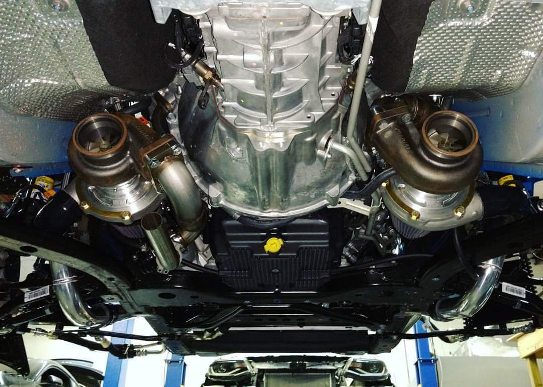

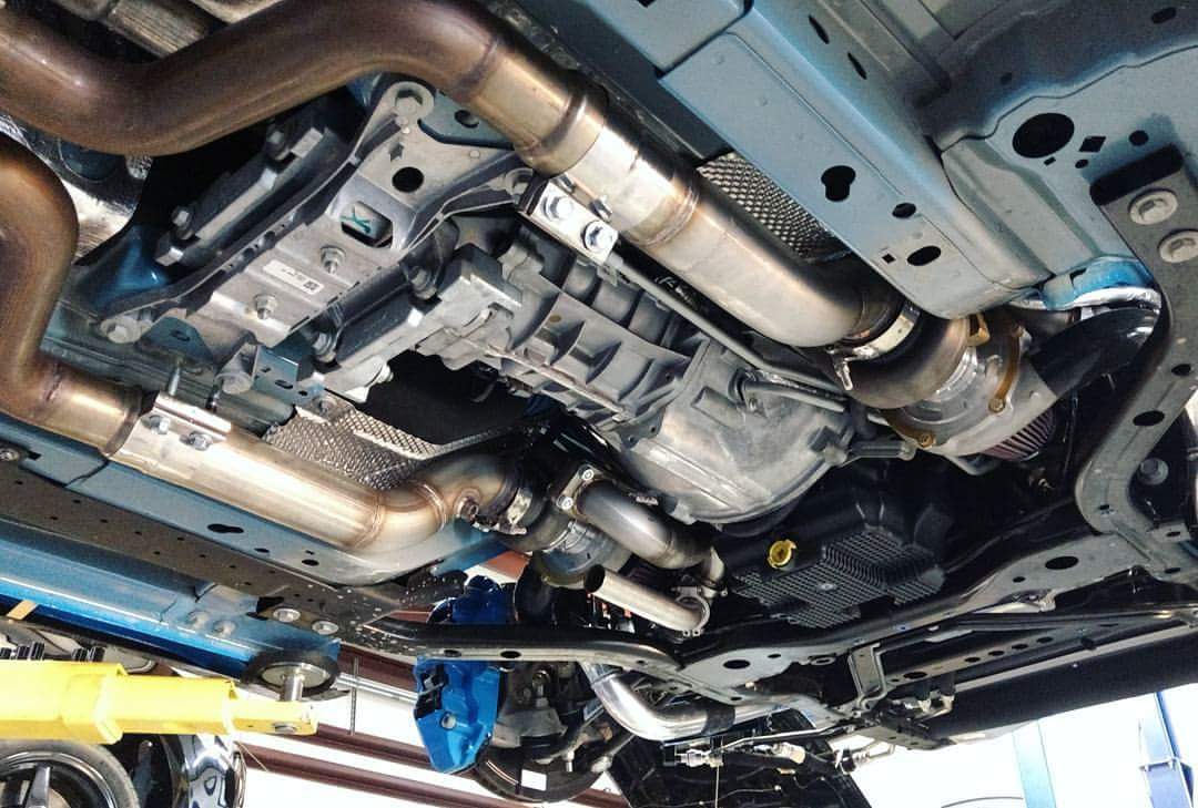

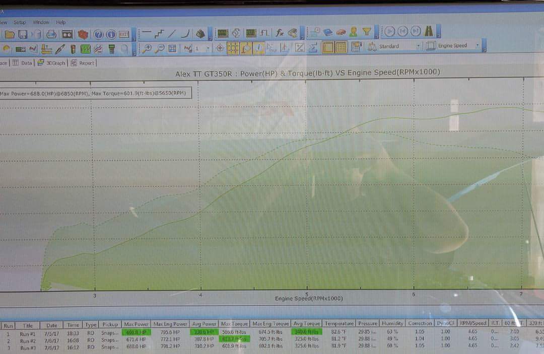

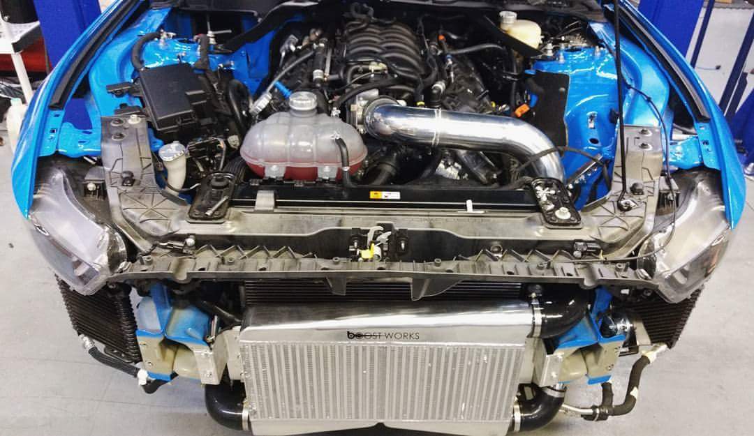

Just finished up another twin turbo install and tune. Car sports our stage 1 twin system at 6.5psi on 91 octane. 688whp/601wtq @ 6.5psi on 91 octane!

Very cool. 6.5psi is barely moving those snails, would be cool to swap a yote under the hood and turn it up.

Question in the pic, what is that little pipe on the left side sticking out ?

Yeah, it's crazy how efficient these 5.2's are. This is our 4th 350 twin turbo build and they have consistently made 675-800whp on 93/E85 and 6.5-9psi.

Will that run ok under wet conditions with air filters mounted that low?

Absolutely.. they're tucked up high enough that you would have to drive through a foot and 1/2 of water before you had to worry. At that point, you have bigger problems. ;)
Rain is not a problem.

Yeah, I like the way they sound with the 4-1 manifolds. It doesn't lose anything from it's original sound and sounds close to what a long tube GT350 would sound like.
