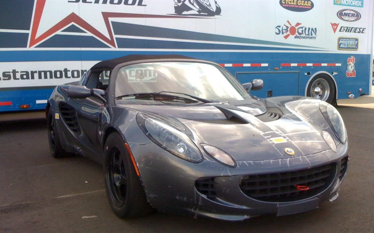

Getting things in order to drive the R home when it arrives. Roughly 600 miles
I was planning to tape up the front of the car with painters tape, but have been considering Trakk Tape. It states that it is safe for use on new vehicles, but wanted to hear some real world reviews. The car has matte black stripes, so I am also curious if it will be safe for those as well.

I used it to drive my car across the country home. I also have the matte black stripes. It's really thick, and because of that it won't take curves well. The guy with that lotus must have spent a bunch of time getting it to look even that decent. So just expect a lot of folding and bubbles, but since it's temporary that doesn't really matter. I left it on my car for a week, and it left residue on the matte stripes that at first I couldn't get off, even with tar-remover. I thought that section of stripes might be ruined. What actually got it off though was just letting some soapy water soak into the residue, letting the residue dry, and rolling it off with my fingers.

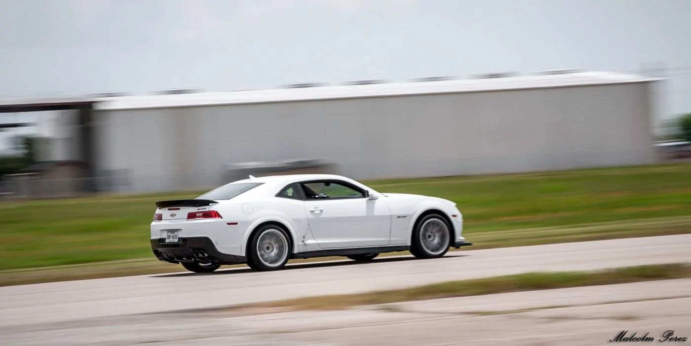

It works great. As others have said, be sure the leading edge is flush with the body panel. Here you can see the dirt it will pick up when the tape starts to lift (on the rear gills).
