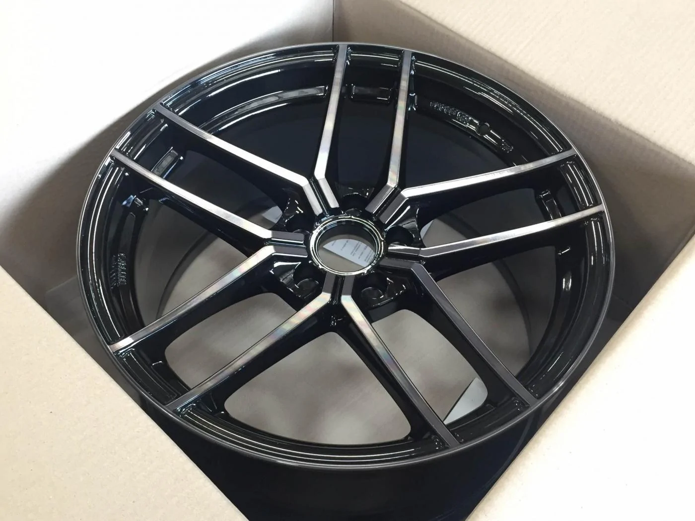

I am happy with my purchase of Enkei TY-5 Pearl Black wheels,
shod with BFG Comp2 A/S tires
from Jason [MENTION=11223]GetYourWheels[/MENTION]
Review includes appearance, size, and track day performance issues
REVIEW
I have a square set in BFG Comp2 All Season tires in 275/40 on my Enkei TY-5 in 19x9.5”. The wheels are roller-forged barrels and apparently pass Enkei’s stringent strength tests.
SHOPPING FOR SEVERAL MONTHS
I window shopped wheels for several months before choosing these wheels and tires. Silver wheels was the obvious choice for my yellow car, but I felt that then the car would look too much like yellow Camaros and Corvettes. The pearl black finish was gloss black with mirror-cut spoke faces, followed by tinted clear coat. So even that was a compromise between yellow and black, and this style is in vogue now.
I think they have a unique style feature. The wheels achieve their concave look by way of the ten inwardly curved spokes, which then dog-leg into the hub area. So that is a true “dish” shape! Furthermore, this helps the spoke to reflect light more often, since there is not just a single angle of the spoke face that will reflect light. I felt it was tricky to choose a wheel that was not too retro, or too radical, or too Euro, and so forth. These fit the bill for me.
Edit: Another nice feature of the TY-5 is that they come ready to go. The bolt pattern and offset comes from the factory - they do not have to sent to the custom wheel shop before they get to you. All they need are hub spacer rings.

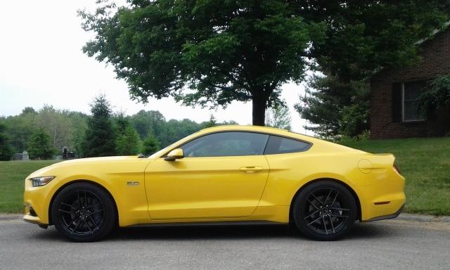

FITMENT
I get compliments on the wheels and their stance. I only run a 5mm spacer up front to even out the stance a little but without exceeding 7 threads engagement. (They will clear the hub dust cap with no spacer.)
While I took my time shopping for wheels, tires, and size options, I extensively relied on my favorite size calculator www.wheel-size.com.
I also chose this size because I thought that 19” wheels were the best proportion to the car, and the 275/40 sidewall height provided a good compromise between performance and comfort. Apparently this tire has a reputation for a stiff sidewall, and really good traction compared to other A/S tires. They run around $200 each.
For a time, I was bent on running 10” wide wheels with 285/35 tires. In the end there was just more options available in the 9.5” width, and so I did not obsess about the loss of 1 centimeter in tire width.

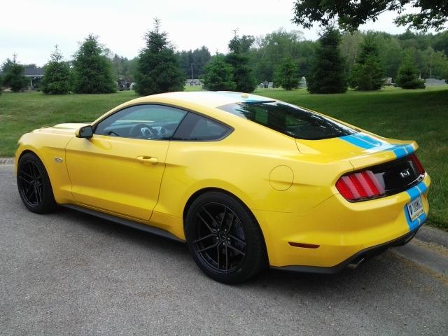

PHOTOS
Here are some photos. Forgive me for not having higher quality photos. I know how to take good pictures with a proper Nikon, but I have not had the time to do a nice “photo shoot”. And it seems that my cell phone camera does not reproduce yellow very well.
