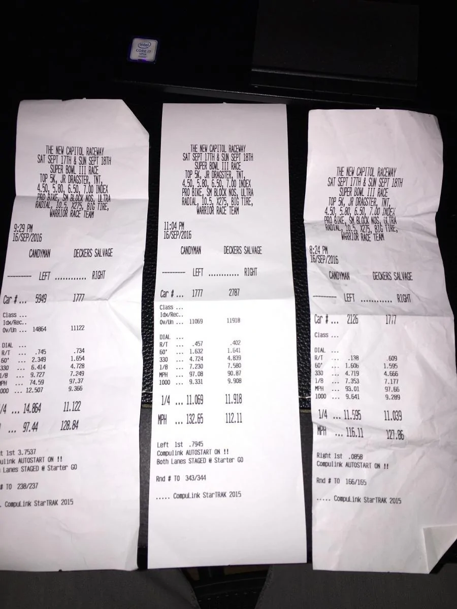

Looking at the time slips (car 1777) you might think the runs were pretty good. The car feels dead in the middle of the track and feels slow for the times it's running. I'm thinking the 1/8 mph should be at least 100mph on a car going 132 through the traps. This was in 500ish DA. Anyone else think something seems off? Going to send Whipple the logs to look at and see what they say.

logs are all that matters, nothing anyone can really say without seeing a physical log of the car,
the 60 is good, and the mph is good for some 10.7s to 10.8s

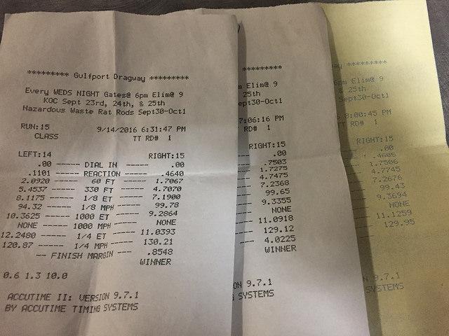

For reference here are my slips from the other night. Not too different.
