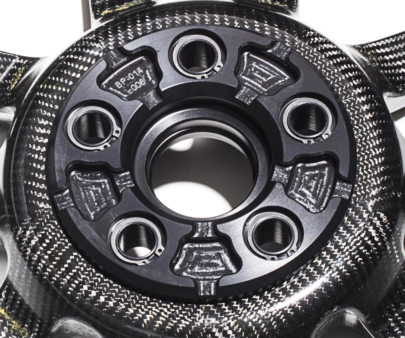

Here's a couple of pics of the lug nut inserts from the backside on the R Carbon Fiber wheels. They have a snap ring. First image is front (deep inset) and second is a rear.

Nice, so it's basically a barrel with depressions on either side that's pushed in and snap rings applied to prevent it from going either direction. Seems a bit homebrew, but, sure, why not?

I just wanted say, I studied these wheels in detail when they were announced and searched everywhere for information that would help to sketch them in CAD.
I modeled the inserts by scaling photos and by looking through CR's various patent applications.
Never once did I see a photo or hear mention of a snap ring being used to retain the insert. Thanks a lot for providing the close up shots of the area.
Out of curiosity, can you rotate the inserts by hand or are they a very tight fit?

Same here. I never seen or notice it on the other carbon fiber R wheels. Are the lug inserts aluminum or steel?

Sorry, I've been out in the garage and have remounted the wheels on the car before I saw these questions. I can't answer them.

Saw my first R at a dealer yesterday and checked out the CR wheels for the first time. I saw the fronts had some kind of white coating on the innerside of the barrel that had a rough, crystalline look. Since it was only on the portion of the rim under the rotor/caliper assembly, I assumed it was some kind of heat-shield material. In your research and examination of the CR patents, did they mention this coating material? I just wondered what it was.

Yep. It's ceramic coating to protect the carbon fiber from heat. All the R front wheels have that white coating.

I figured it might be ceramic. Looked like it would be a b!tch to clean after a day at the track!

Oh yeah.
FoMoCo said:
During track testing the extreme performance capabilities of the braking system developed heat which required the maximum technology available in from Carbon Revolution. When brake temperature measurements were taken, it was revealed Shelby GT350R’s ultra-powerful brakes were creating rotor temperatures in excess of 900 degrees Celsius. As a result, the wheel design was elevated from a road car specification to a thermal standard more suitable for motorsports.
For decades aerospace companies have treated turbine blade materials subject to extreme heat with ceramic coatings to help improve durability. The technology is also used in top-tier open-wheel racing environments. Athermal barrier coating system developed by Carbon Revolution uses this same technology.
Created specifically for motorsport and aerospace applications where extreme temperature conditions are encountered, Carbon Revolution’s thermal barrier coating system uses a multistage, multimaterial coating cocktail that provides an excellent thermal barrier. Using a plasma arc gun to liquefy a ceramic material, the wheels are coated at critical points around the inner wheel “barrel” and on the back of the spokes. The result is an incredibly thin, nearly diamond-hard coating that reliably shields the resin from heat – reducing maximum wheel temperatures and allowing continuous track use by even the most aggressive drivers.
From here.
