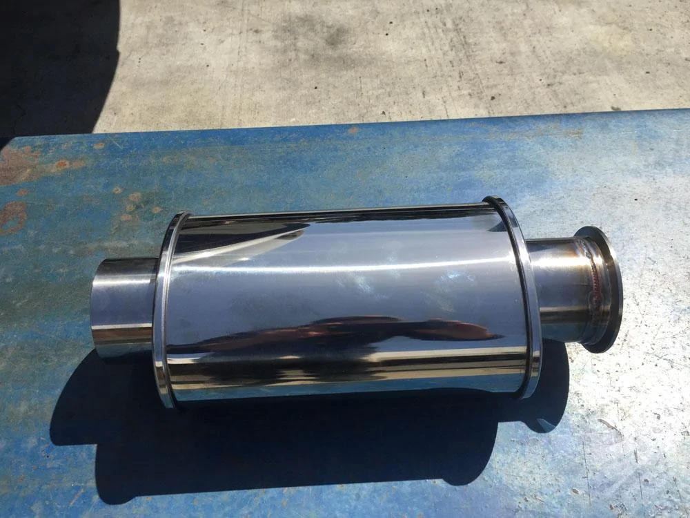

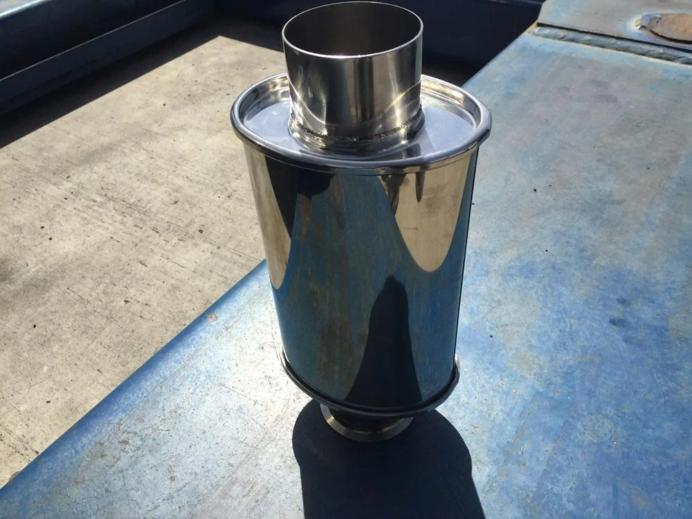

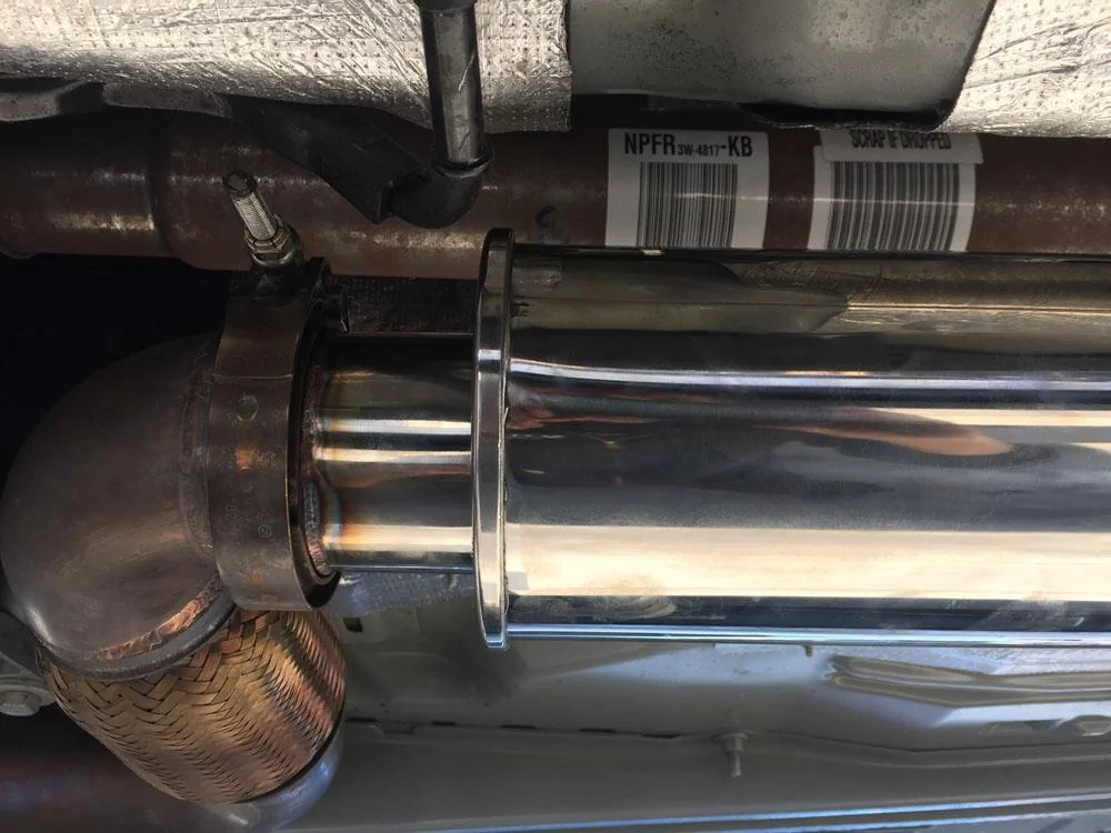

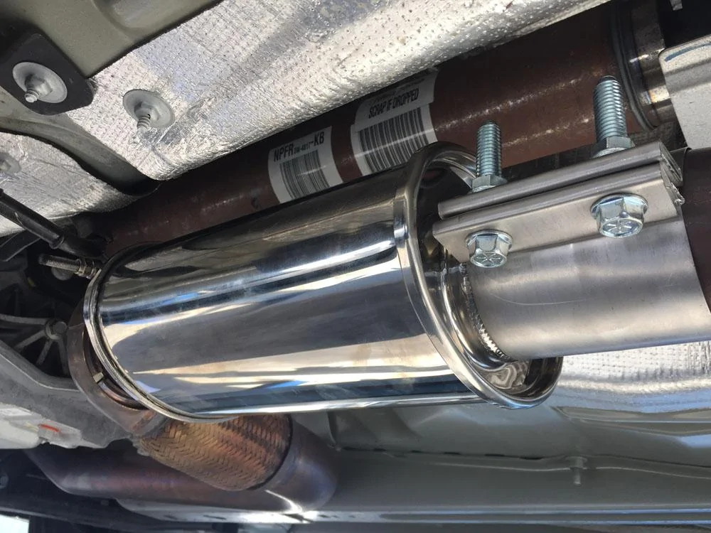

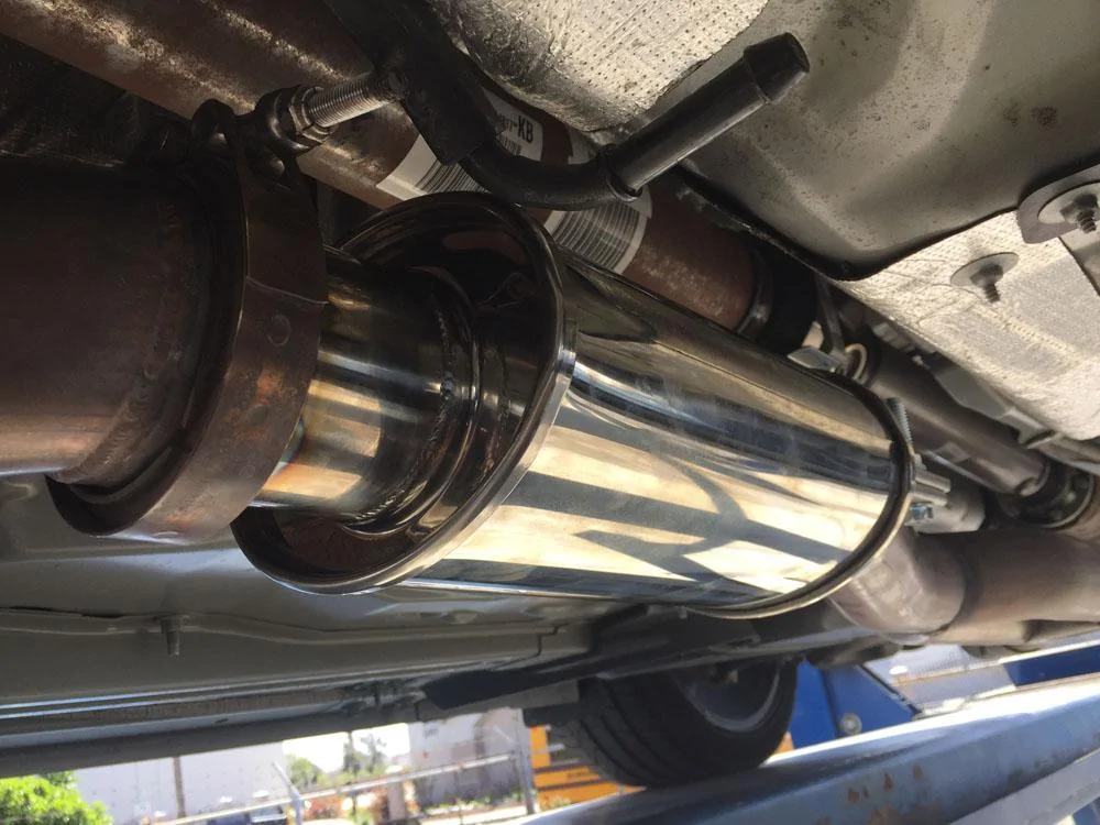

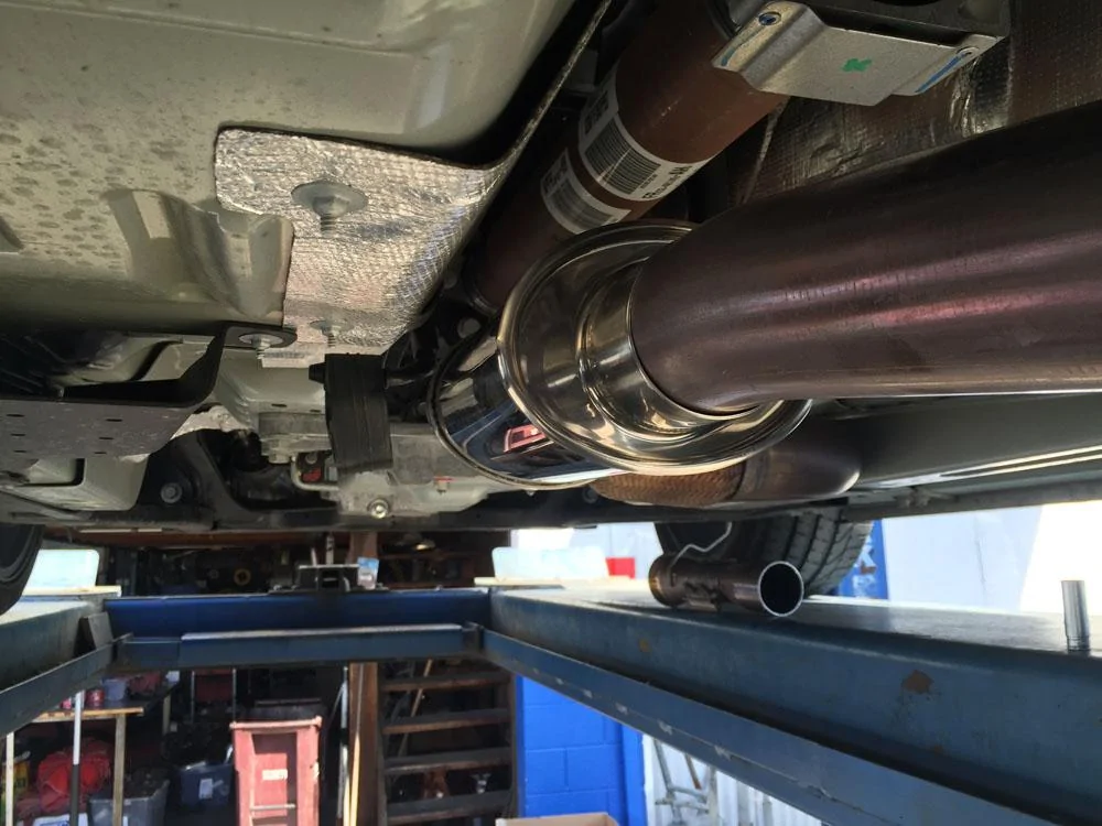

After installing Stage 2 our our project Ecoboost shop car, we were honestly shocked by how obnoxious the exhaust note became. It was unbelievably loud, at all times including idle, and would rattle windows under full throttle.
We took matter into our own hands, and using a simple Vibrant 3" Ultra Quiet resonator the car is literally night and day. Its extremely civilized at idle, no more drone anywhere, and the exhaust note is very very nice at WOT. One of my favorite changes we have done yet.

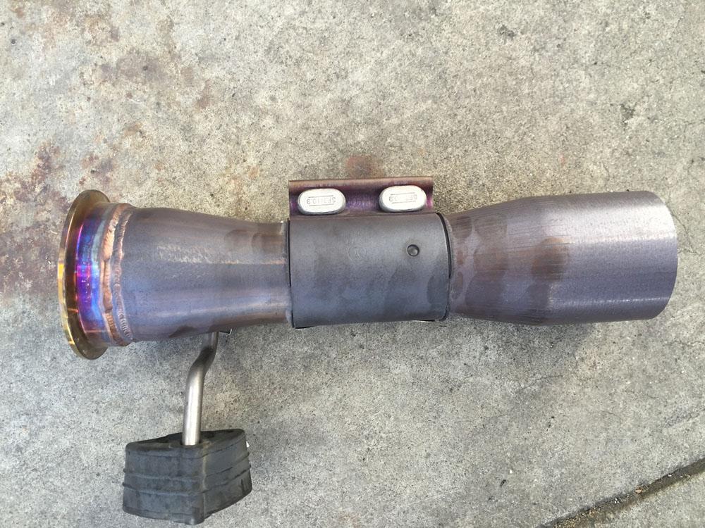

Side benefit, you get rid of that stupid 2.25" factory neck down. Running a 3" full exhaust but it necks down to 2.25" in the middle. You are running a 2.25" exhaust..:)

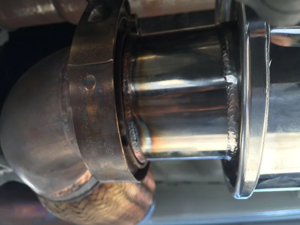

We are running the 3" ATP downpipe so all we had to do were put a V-band to match the downpipe, and it become plug, and play
Basic steps to implement this are.
Buy the resonator link below
Buy the Vband clamp depending on what DP you run
Buy the 3" flat clamp
Have the V-band welded to the Resonator
Measure the exhaust, and cut it off the Resonator is designed for 3" tubing to slip into it
Slide the pipe side in
Button up the V-band,
Install the flat clamp, and enjoy your new found exhaust note.

The ultra quiets are really nice, they kill the tone quite a bit, but keep it sounding good. Should be a bolt on affair for you, just pull the normal one out, swap the UQ in.
