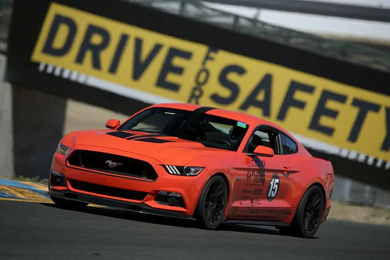

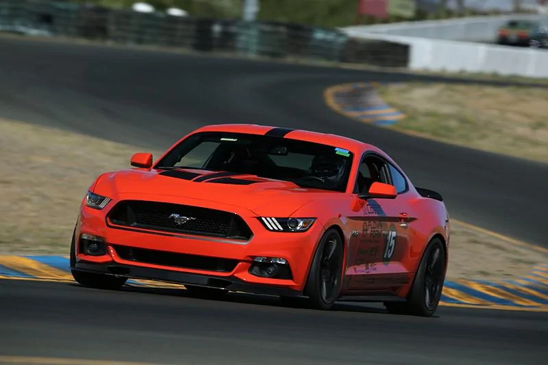

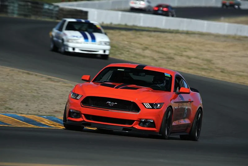

Cortex Racing just blessed my inbox with these drool worthy track shots of their S550 tearing it up at Sonoma Raceway.
Many have been asking for more shots of our 18" FF15 on car, well here you go!
This set up is the 18x10.5 et48 front and rear. They are running Nitto NT01 315/30R18 on all four in these photos. However, Filip from Cortex recommends the 305/35R18 as it is a bit taller and suits the S550 a bit better.
Another thing to note is that if you are not running a coilover like theirs, which is offset in board further to allow room for this fitment, you would need to run extended studs and a 10mm to 15mm spacer (dependent on tire size) up front to clear the strut.
Cortex Racing carries our 18x10.5's as well as our 18x10 et40 FF15 that is a direct bolt on front and rear.

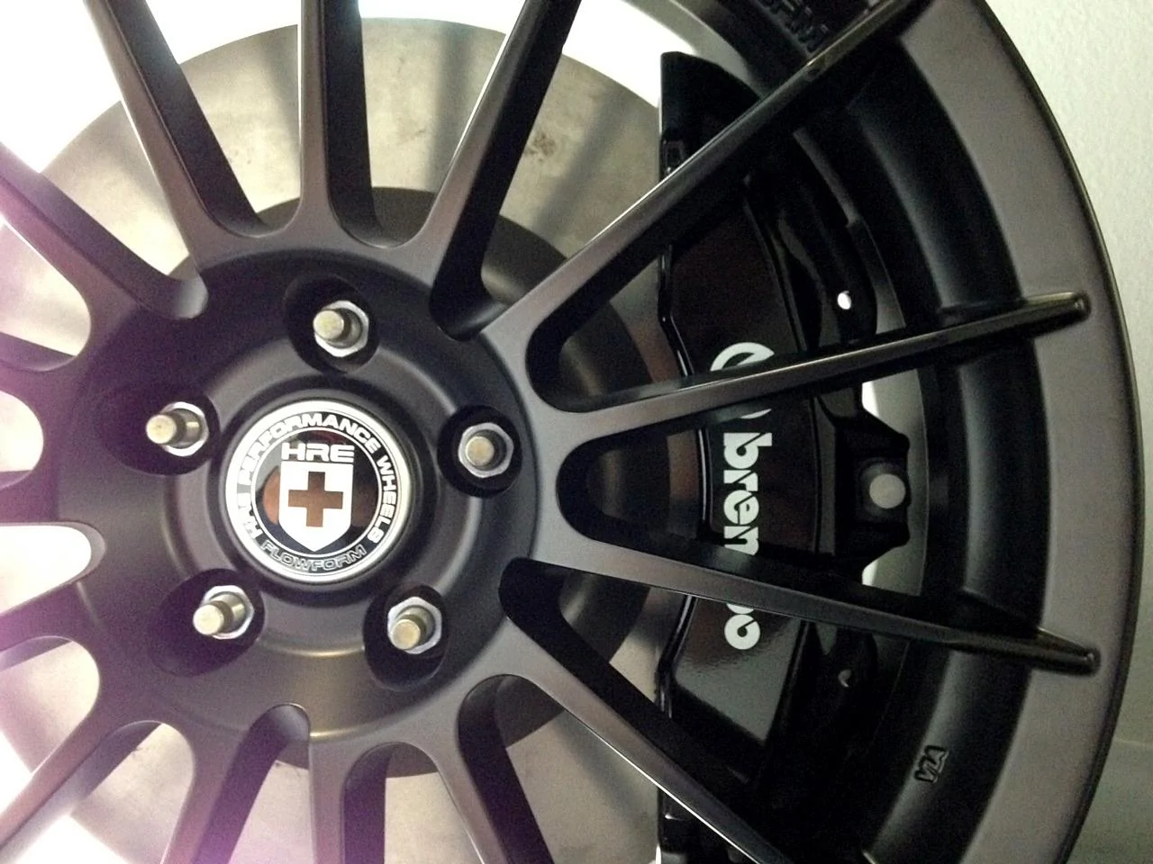

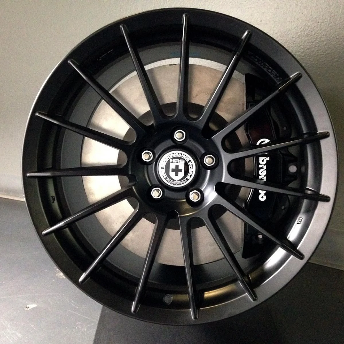

Oh and as many of you know by now...both of these clear the massive GT PP 6POT Brembo/380MM brakes. :D
