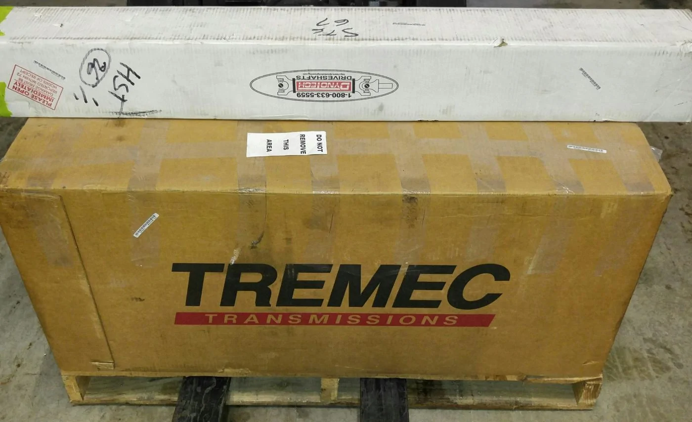

Car is here! Parts are starting to roll in.. :)
Engine comes out in a week or so, and we'll do a detailed tear-down with pics, so you guys can see the differences between the first and second gen Coyote. :)
