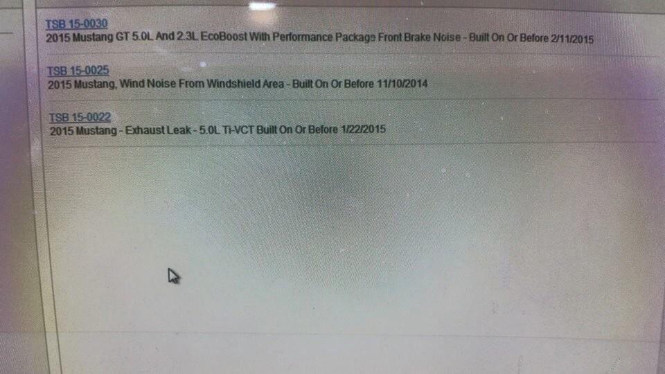

What's a tsb?
Mustang8
May 14, 2014
277
Tampa
2015 Mustang GT Premium
Mine used to, there is a TSB for it now. I got my brakes replaced the other day and not a sound from them since.
TSB stands for Technical Service Bulletin, basically tells the dealer/mechanic what the issue is and how to fix it.

Here. This is what you need to tell your dealer.

Does anyone have a copy of the TSB that can be printed out? I took my vehicle in for the front brake squeal but they said there were no TSBs that they could pull up for my vehicle and even telling them the 15-0030 number they were not able to find anything.
GT Pony
Mar 13, 2015
77
9,402
4,839
Pacific NW
May depend on when your car was built if their system pulls one up or not. Just give them the TSB number and they should be able to pull it up on their system. If they can't, then they shouldn't be a Ford Service Dept.
