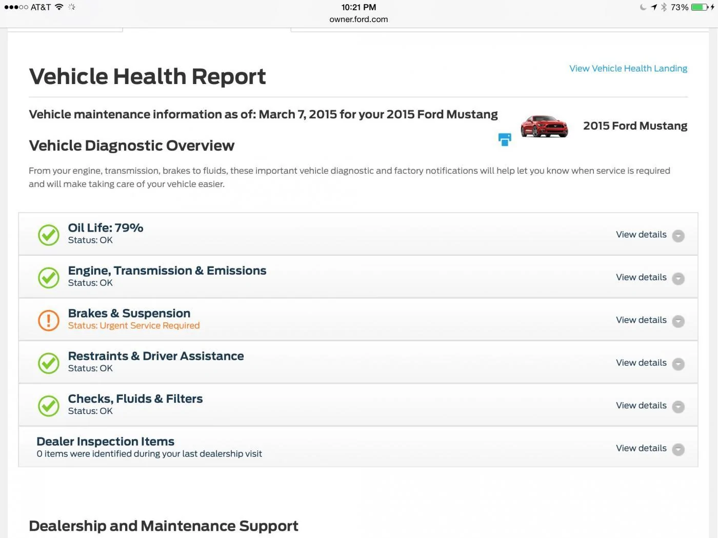

Just checked and my report submitted with no issues. The brake issue is that my parking brake was engaged.
