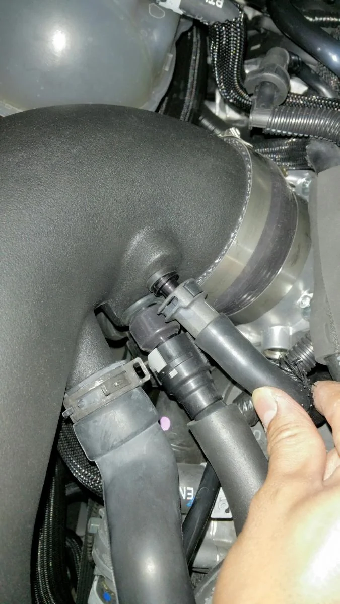

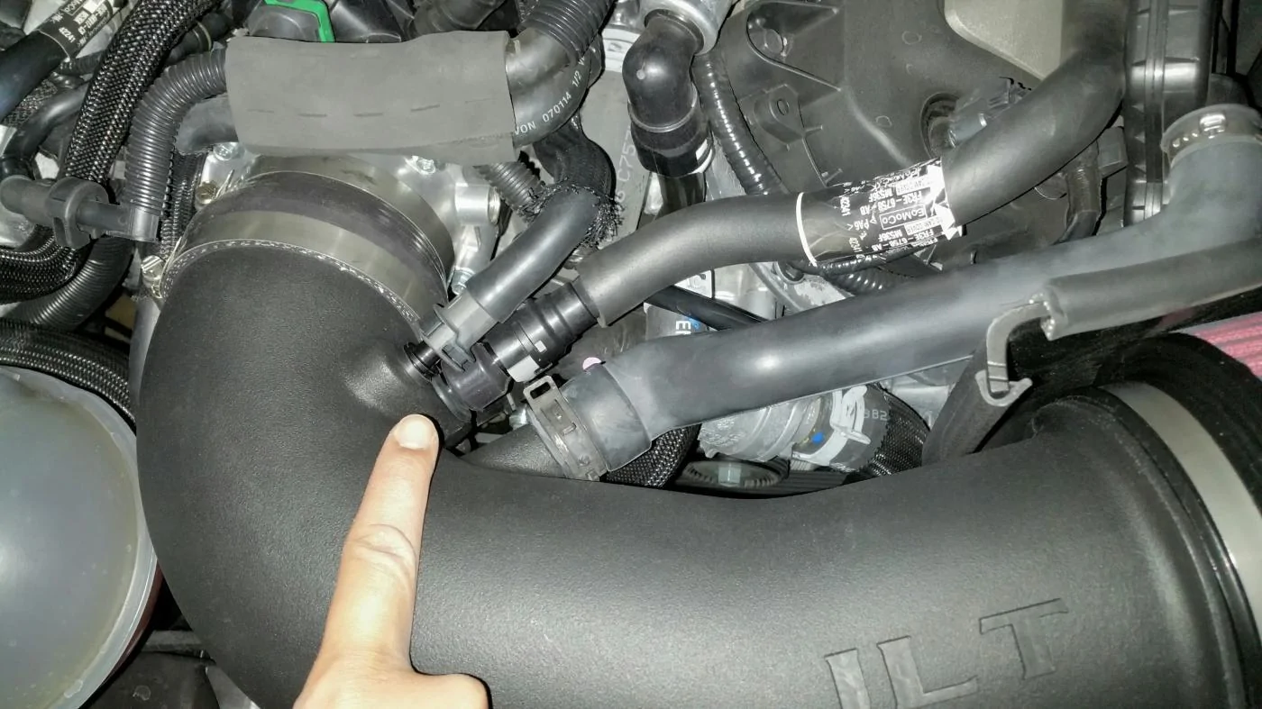

Thanks for the input guys! Purge valve seemed ok. I checked all connections once again and even re-did them. I deleted the code, so hopefully it doesn't pop up again.
The one thing I think is causing the leak is from 1 of 3 the connection pieces from the JLT. It wobbles a lot and honestly the whole intake is poorly made. I really regret purchasing this intake and wish I would've held out for the Steeda or some other company. Oh well, live and learn. Thanks again...

Todd15Fastback
Dec 10, 2013
80
10,523
3,883
Atlanta, GA
Todd
2015 Mustang GT PP Fastback
You should contact Jay @ JLT.
ATTFighter
Nov 4, 2014
39
494
38
2018 Mustang GT
Does not look like that piece is in correctly, contact Jay @ JLT he will help you sort it out or fix it i am sure.
fgonzales11b
Nov 17, 2014
San Luis Obispo, CA
Froilan
2015 Mustang GT PP
That's what I thought at first, but this is how kit came out of the box. Also the piece will not go in any further b/c of the ridge. I actually did message him a few days ago, but he only said check all the connections again and asked what tune I had, then never responded back. I appreciate the help...

fgonzales11b - I can't say nice enough things about Jay and Lisa - They're really nice folks and he's more than happy to get you some tech support on this!
If for any reason he thinks that it's defective let him you're working with Alex at AmericanMuscle, shoot me a PM with your order number and I'll have a replacement shipped out for you overnight no questions asked!
Call jlt.
He will take care of it.
Just like everyone's said he's really great to work with and again if for any reason he thinks there's an issue let me know and I'll get you a replacement shipped out!
I'll be watching the thread!

Just saw this thread. I will say this is the first we have heard of this issue.
We'd be more than happy to send you out a replacement tube free of charge if you feel it's a faulty part.
email me @ [email protected]
