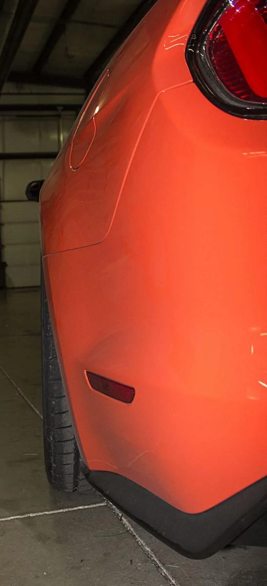

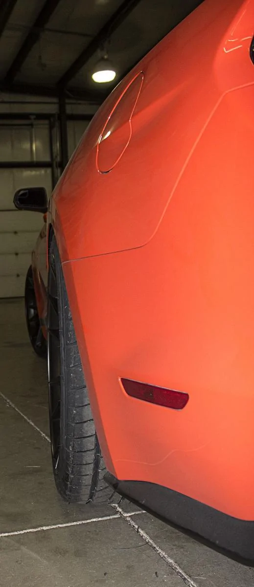

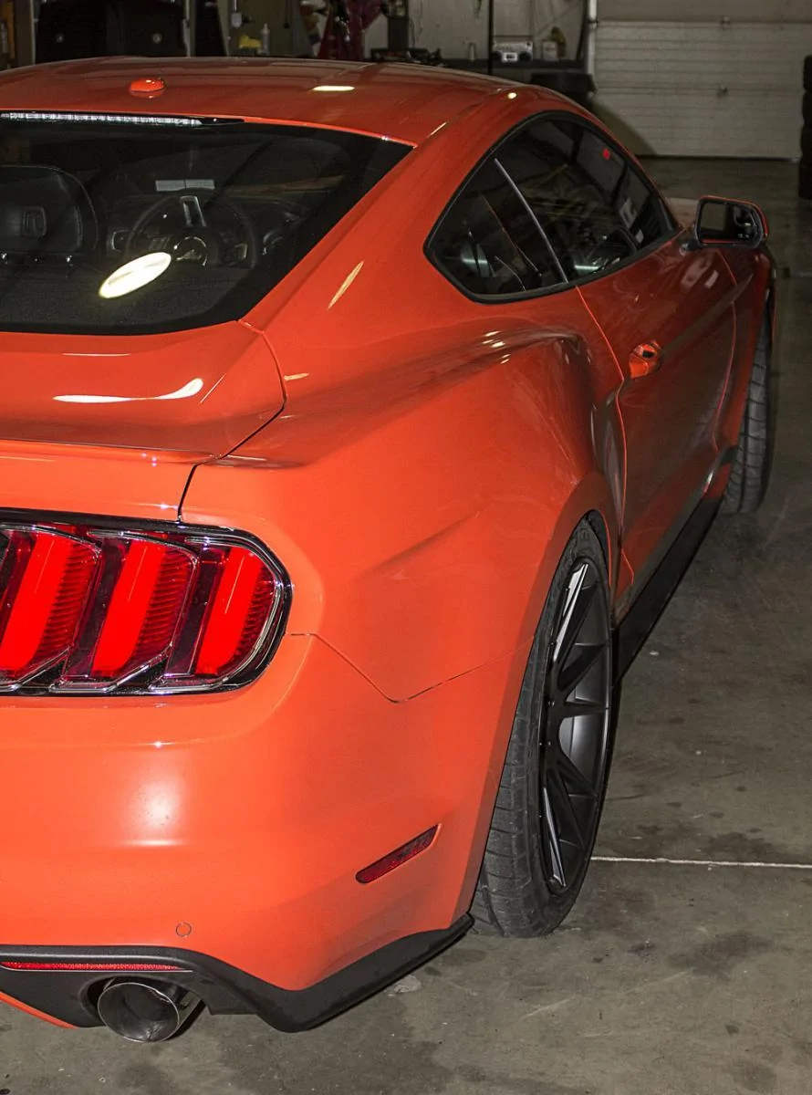

Thanks for the diy, I ordered a set from you because of this. Do you have any side pics showing how flush your wheels are with the fenders? Does it look weird sitting a little lower in the rear? How is the ride quality on this compared to the gt with the pro kit? Any chance I can get pro kit for the rear and sportlines up front? Or do I have to buy both? Any rubbing with your wheel setup? @Steve@CJPP
you would have to buy both kits to get that set up you asked for.

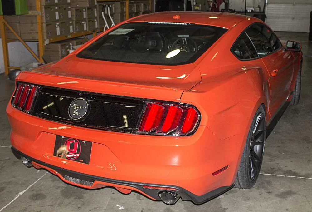

Hmmm rear end looks lower (or less wheel gap) than the front end... Hope that is just the angle, or I might have to keep my steeda rear springs and drop the front...

Still couldn't see if they stick out past the fenders.
I know I've posted these before just can't keep track on where I put them so here you go.
