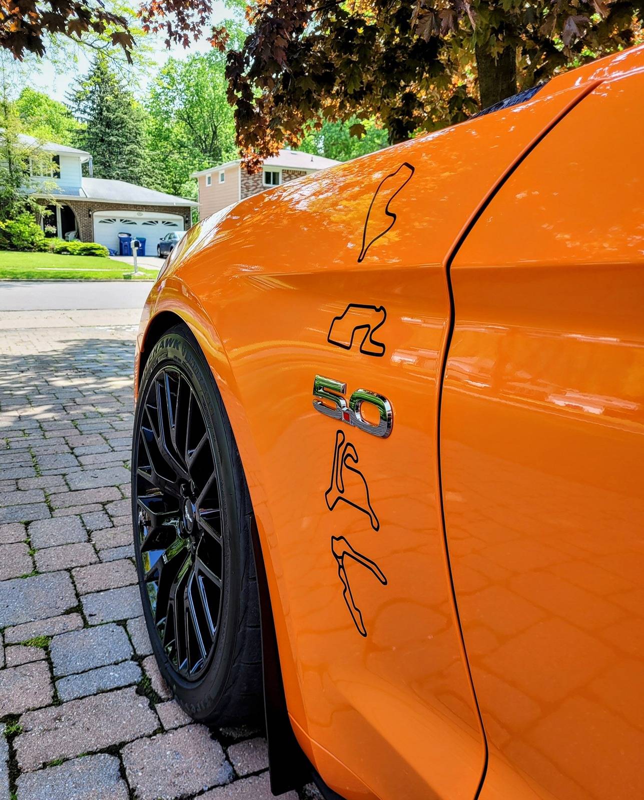

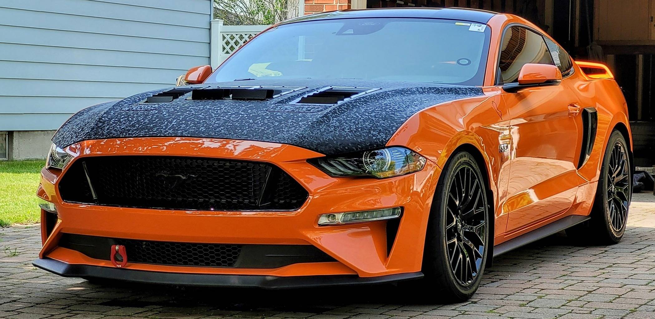

It is a mix of wheel offset and alignment. I don't know the spect of these wheels, but you can visually eyeball how much you want to add.
This should give you some idea - up front, this is a stock PP1 wheel with 255 tire and -2.7 camber and 25mm spacers. With stock camber, the wheel would be sticking out.
My other set of wheels are 11" wheels with 305 tires, and those sit mostly flush without the need for any lips. But again, cambwr and wheel offset are key factors.

Nice stance! Thanks
