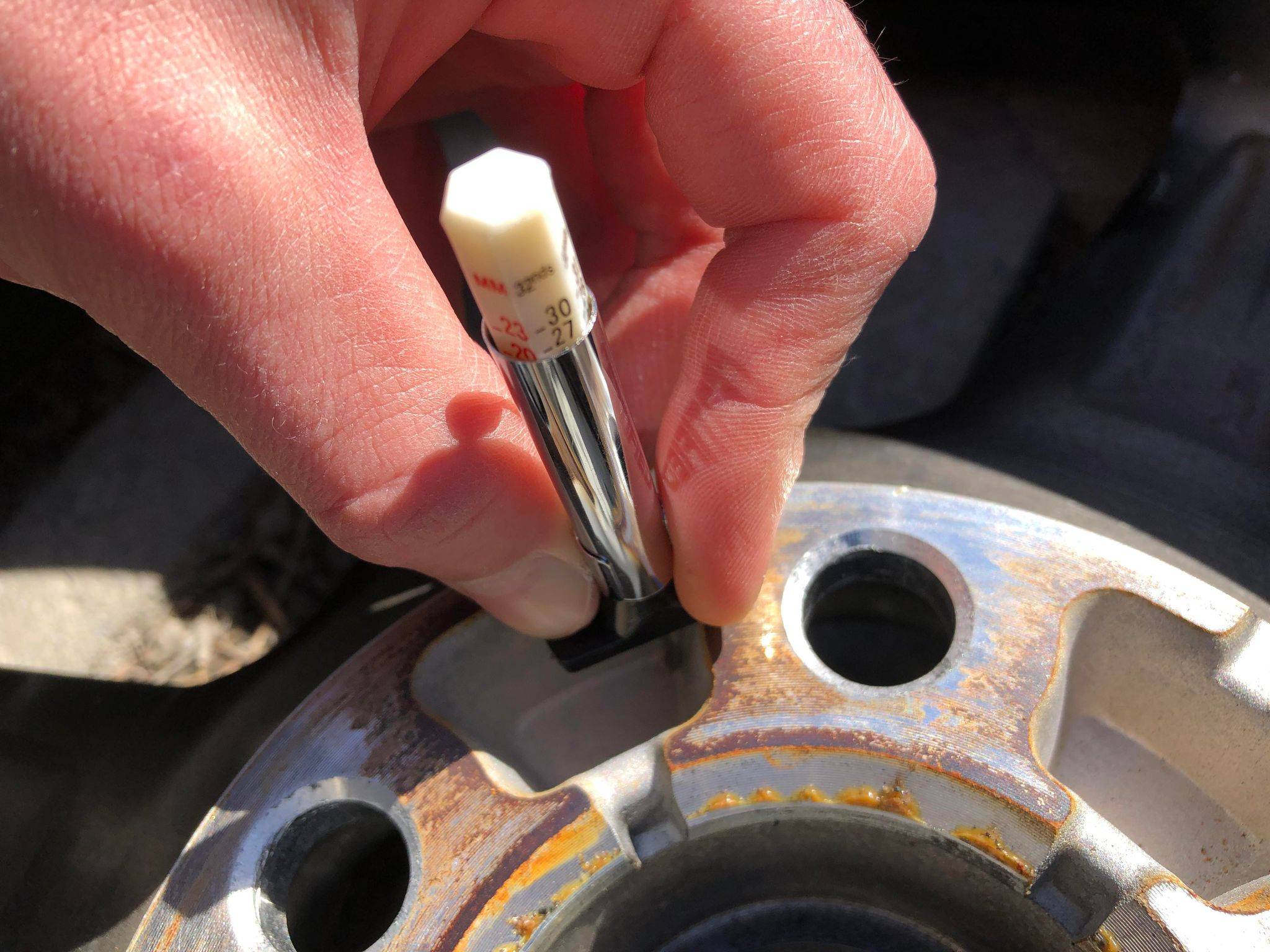

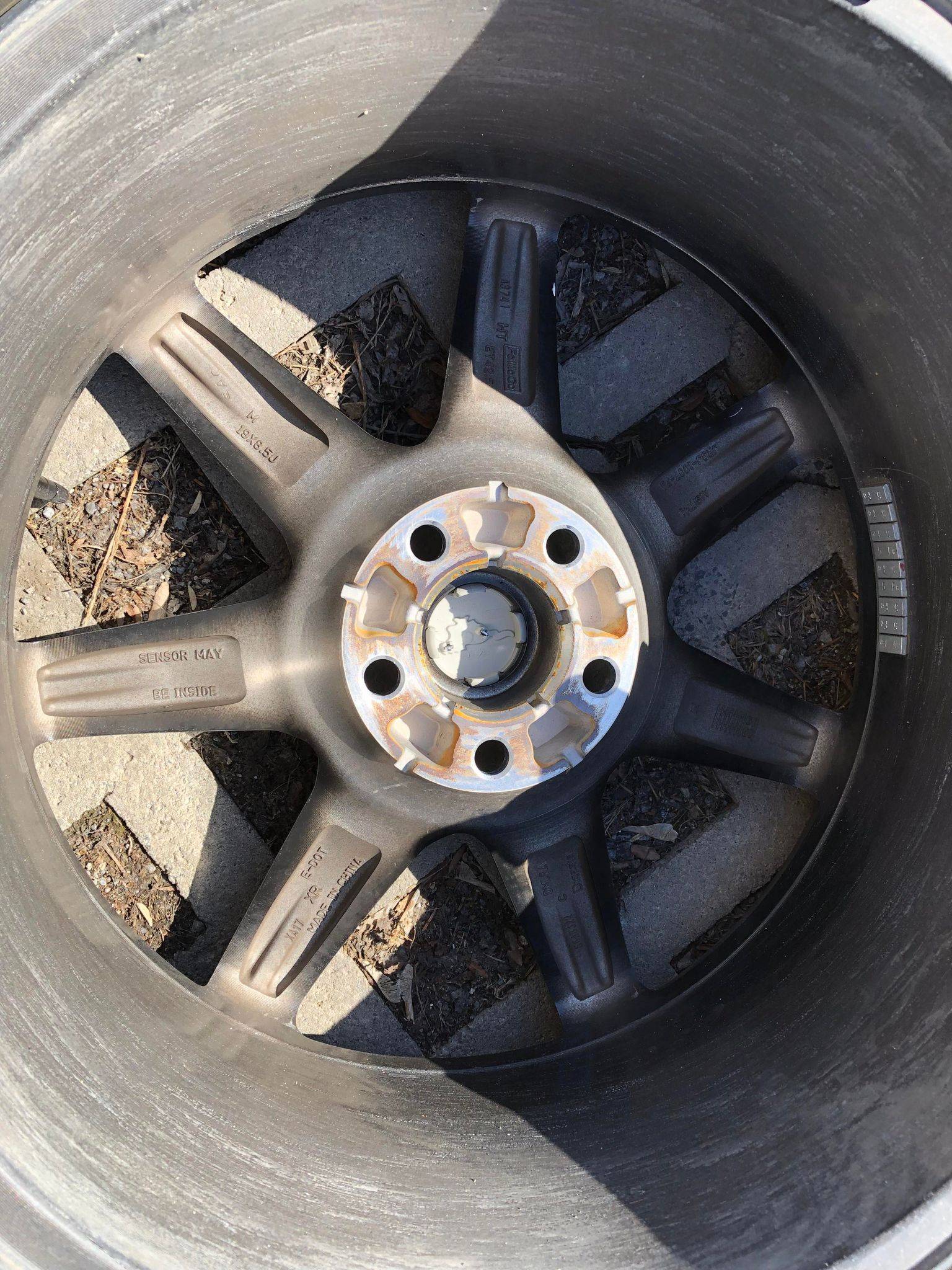

I took a wheel off today and it seems the black 19x8.5 5 spoke wheels pockets have at least 20mm of depth. So it should be more than enough for 20mm spacers. Here are the pics:
I think I'm gonna order the steeda 20mm spacers today, they're about 100$ cheaper than the eibachs for 4.
Will report back once installed

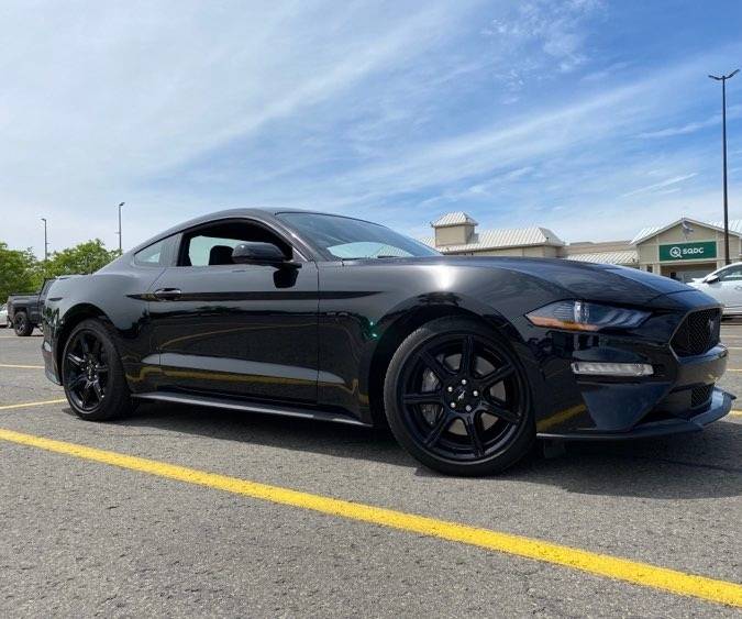

Glad I went with the 20mm ones. fit is exactly what I wanted with my 19's. Didn't have to cut any studs.
