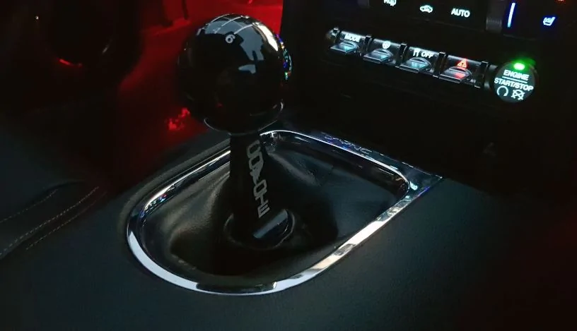

Please do a report on the Barton, very close to buying One a few months back, what did Mike say about it ?Trip to modurstang yesterday,
Barton short shifter!

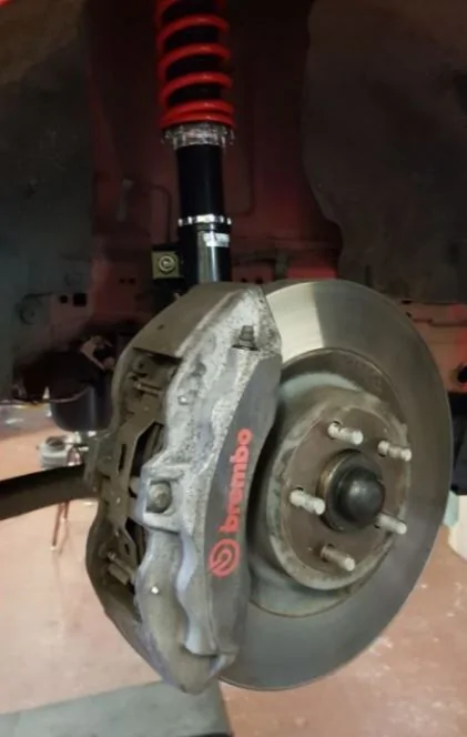

& Pedders coilovers!
Like a new car :clap2::clap2:

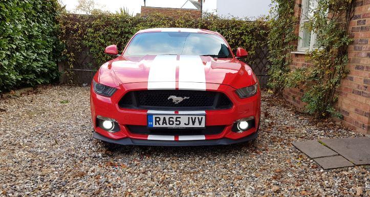

finally braved the coldhere's one
1) Turn wheel inwards for side you're doing
2) remove all push pins (3)
3) stick hand in and twist clockwise 180* the connector and pull out
4) push connector in and remove bulb
5) put new bulb in
6) test it works
7) put in and twist counter clockwise to lock in
8) repeat on opposite side.
Now go do it :lol:
God damn, I love the red/white stripe combo. Almost makes me wish I had gone red, almostfinally braved the cold
look ace!
(oh, and it was anti-clockwise :doh needed pliers to get the damn thing out in the end.
yeah I just took it to local vinyl signage place with a picture of a gt350 and said do thatGod damn, I love the red/white stripe combo. Almost makes me wish I had gone red, almost
Where are your stripes from by the way? Custom? How wide are they? I have in mind the same sort of thing for mine - wide, but in matte black. Just researching at the moment
I found it was a bar steward to get the connectors off & I also needed pliers to turn the holder. Manders advised me & yes it was worth it.finally braved the cold
look ace!
