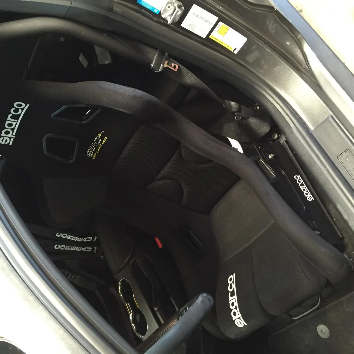

Dropped a few more pounds and added a more track friendly seat. I loved the factory Recaros but it was time for a more confining seat. These are the New Sparco EVO II us with steel side mounts. I made custom brackets to adapt them to Corbeau seat brackets with double locking sliders. This setup is not as light as it could have been, but allows the seat to be adjusted for different drivers. All in all I saved 14lbs a seat. (The factory Recaros are parent light considering they have airbags in them)
