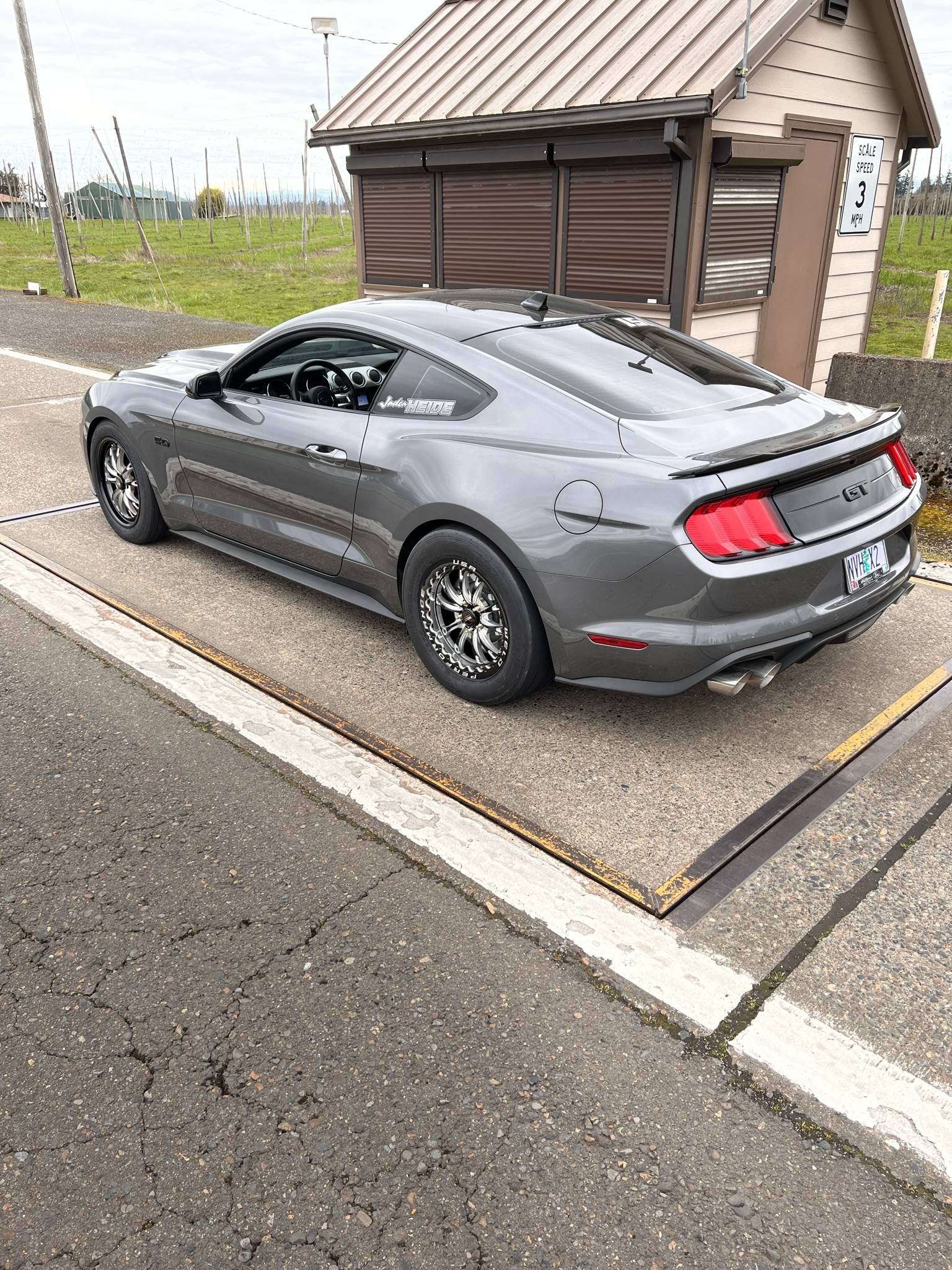

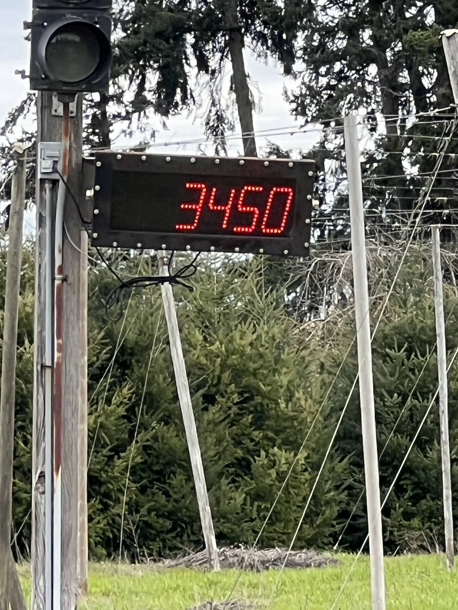

Finally got the car weighed. 3450 with 1/2 tank E85. We typically run with less then 1/4, so that should save us another 20+ lbs.
No back seat, no passenger seat, muffler delete, resenator delete, Baer front drag brakes, 1 piece driveline, wiper and motor delete, no wiper fluid, antigravity battery, Steeda front crash bar, no spare tire. Also saved 14lbs switching front tires to MT ET Fronts. That’s all I can think of now.In case I missed it in a prior thread, what exactly did you guys do to shed so much weight?

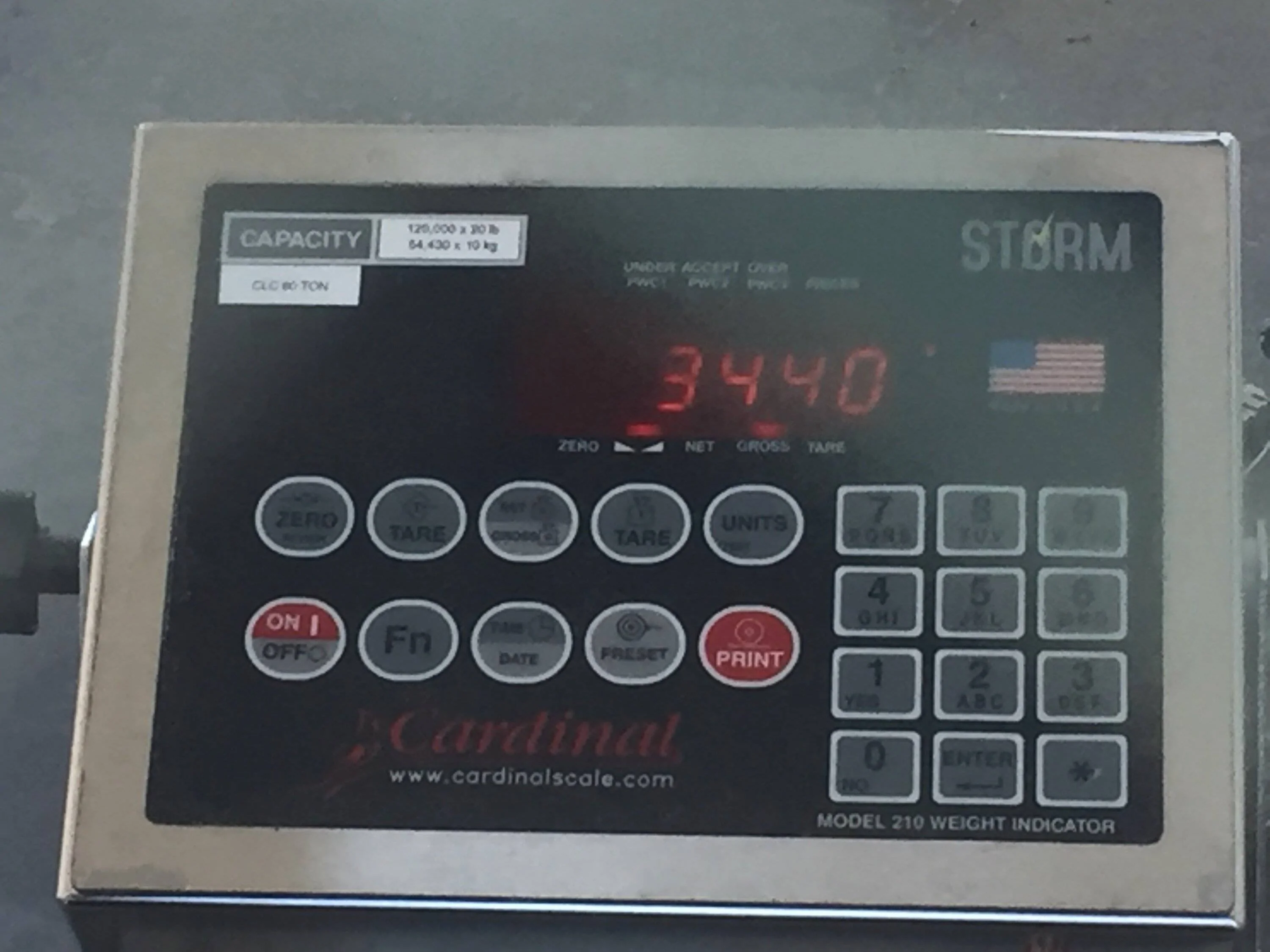

Wow.. Ford really porked up the 19's and up base models. Or that 10r80 has a 100lbs on other transmissions. My base 17' MT82 with a rear seat delete / wheels / axleback / h-pipe weighs 3460lbs.No back seat, no passenger seat, muffler delete, resenator delete, Baer front drag brakes, 1 piece driveline, wiper and motor delete, no wiper fluid, antigravity battery, Steeda front crash bar, no spare tire.
