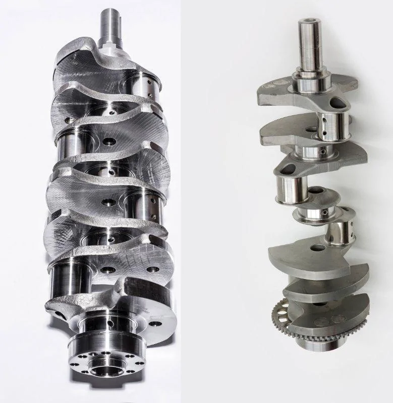

He may have been talking about a modified coyote crank. You're probably right.Pretty certain the Voodoo crank is lighter. Did i missunderstand your statement?
The Voodoo crank is not lighter. A flat plane cranks needs more counter balancing than a cross plane coyote crank. So true the voodoo crank is hollow to save weight but so is the coyote. However the voodoo crank has more weight by mass on the counters weights and are more in number as the voodoo needs center weights and coyote crank doesn't have any there. Look at the center of the crank the voodoo on the left and coyote on the right. Also the end weights top and bottom on the voodoo are a lot thicker whereas the coyote only slightly thicker.Pretty certain the Voodoo crank is lighter. Did i missunderstand your statement?
I thought I read that before also and I look for an hour and can't find anything.Ford has said on many occasions the voodoo crankshaft is lighter than the coyote and some discussion have said by over ten pounds. There have also been countless post discussing this and verified weights confirming fords comments.
Most of the weight reduction is from the spray in liners and heads. 13 pounds lighter than a coyote If memory serves rightI'd have do some searching to locate but a quick release from Ford on the engine has this and also talked about weight saving as a benefit of the FPC.
"The forged-steel flat-plane crankshaft is “gun drilled” to reduce total engine weight and to improve bay-to-bay cylinder breathing. ”
Totally agree with that if your going FI. I just saw the weight conversion and it got me curious again, it's been talked about so much but has one been weighed side by side.My point was the shop i was speaking to said if u want huge power with FI the FPC is not the way to go bc of inherant vibration. They recommended the coyote CPC swap into the Voodoo. The cranks they were talking about were modified and lightened to less than the Voodoo crank.
