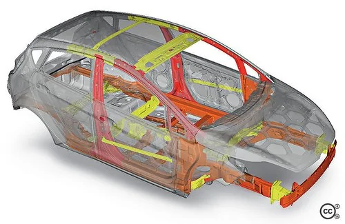

Here's the changes made to the 2011 Fiesta required none of what your suggesting... The '11 was carried over (introduced in '08) but, had the structure updated with 50% Boron. This saved 88lbs in the cage alone. Again, no real changes and since Ford can change the gauge of the metal used without retooling (see Hydro-Forming), making panels thinner is pretty simple. Also, the 2012 Focus received the largest Boron change over in Ford history, it was introduced in 2010... weight savings is classified :)
Here are all the pictures... Remember folks, neither the S197 or the CD4 uses very much Boron and NO Aluminum. Lots to be saved but, I am betting there will be some major performance enhancements to offset that weight loss.
Over 50% of the new 2011 Ford Fiesta’s body structure is constructed out of lightweight, incredibly high-strength Boron steel. The use of Boron Steel is borrowed from Volvo. However, the super steel compound was only used in select key areas, including the Fiesta’s floor structure, front rails and beams, and the integrated “body-side reinforcement.” Essentially an extremely complex roll cage, the primary structural components of the body-side reinforcement include the slim A-pillar, the intrusion-resistant B-pillar, the rocker panels to which the B-pillar is fixed, the stabilizing rocker baffles, side roof arch and the lower A-pillar.

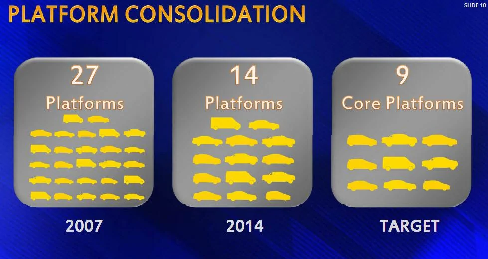

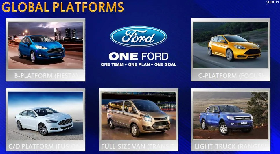

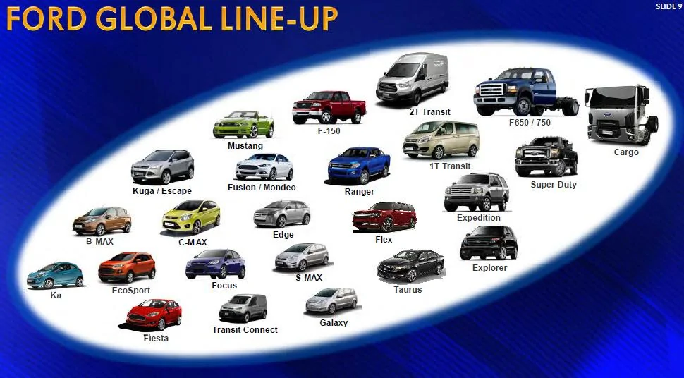

I thought it was already known that Ford will NOT have a separate GRWD platform for the Mustang? Ford has already said it's ultimate goal is to have 9 core platforms, 5 of which are global:
B - Fiesta
C - Focus
C/D - Fusion
Light Truck - Ranger pickup
Commercial vehicle - Transit van
Remember this presentation? The one that leaked the 2015 Edge....
http://corporate.ford.com/doc/ir_20130115_Deutsche_Bank_Global_Auto_Industry_Conference.pdf
Missing in this whole presentation is mention of the Mustang platform. They obviously wanna keep that top secret for 2015 but doesn't 5 global platforms tell us there's no room for a global RWD unless you're thinking the Mustang remains on a regional platform (and sell globally) due to expected low volume of global sales.
