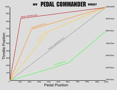

This is all it does.I don't think I've heard anyone clearly explain/prove what this device actually does?

If someone logs the correct PIDs you'll see no difference other than the input to output curves of the pedal.

All I'm seeing from the graph is that it increases throttle response. If that means scaling the pedal output by reducing impedance or what have you, it's still increasing throttle response. All I see you and the critics who most likely haven't tested it, is theorize about the end result and ridicule the product and our experiences. It can't be accomplished in a tune (fact), what sport mode does is not the same (fact), and just because I'm not an engineer and can't produce a graph doesn't void my testimony.Lemme guess, you work in sales?
I'm an engineer. I work in the auto industry. Engineers are data and facts people. You have provided no data, just feelings. I actually KNOW what these devices do. I have used them before. There's no magic. It's scaling the pedal output. That's it. It doesn't speed up the throttle body. It doesn't change engine response to throttle opening value. All it does is change commanded throttle for a given pedal input. That's a nice thing for many, particularly those with the auto who feel its a bit mushy during transients and the torque converter isn't locked. Please stop trying to sell based on provably false claims. The product has value, but don't misrepresent it.

the engineer provided the graph. It increases throttle output in the way only it can increase it, not like a tune or how it's done in sport mode. It doesn't alter the PCM in anyway. So you're not making more power or torque. You're not changing any tuning settings. What gives man?So far you'd rather show inability to use any technical terms or show any data than won anything. If you're claiming it speeds anything up, provide evidence.
