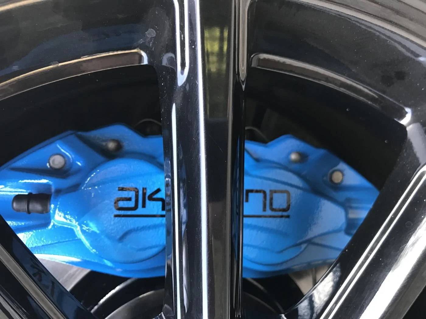

Just pained mine in grabber blue.

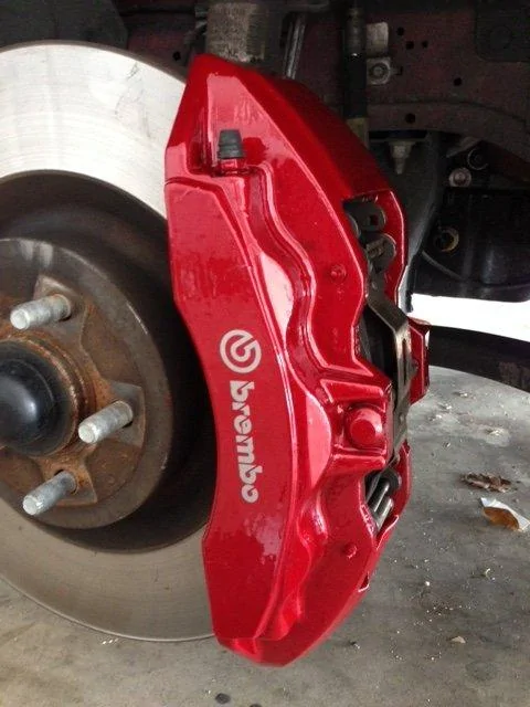

Just finished. Three coats and handsome paint left over. It looks pretty good now but I'm hoping it'll look even better once it cures. :cheers:

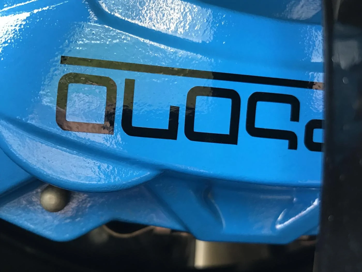

Could you post a close up pic of the quality? Did you sand them down before at all? I want to do mine but I'm scared the texture of the caliper will show through.
I didn't sand them down at all! I'll post some close up pics when I get home. At the in laws getting drunk.

Put the decals on a few minutes ago and removed the masking tape. After I put the wheels back on and get her cleaned up, I'll post a few pics.
The G2 paint is a good product. Once it cures overnight, this is how it turns out.
Didn't need to sand them down, just cleaned them really well. First I washed them with soapy water, then used the provided brake cleaner and a wire brush. The texture does show through a little, but it still looks good.

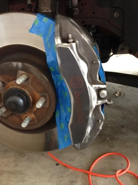

I agree. I used a wire wheel on my drill motor and a hand held wire brush. Then cleaned them with the supplied spray on brake cleaner.
On the first one (the driver's side front), I went a bit overboard with the wire brush and drill motor and got it down to bare metal in some spots. Then I realized I didn't need to do this. Just brush them off good and used the brake cleaner.
Here's a pic of the first one cleaned and ready to paint.

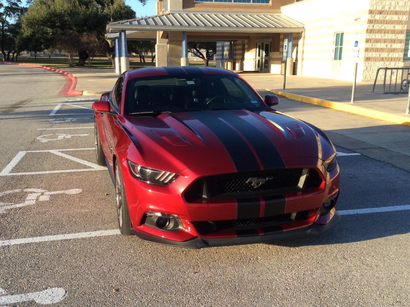

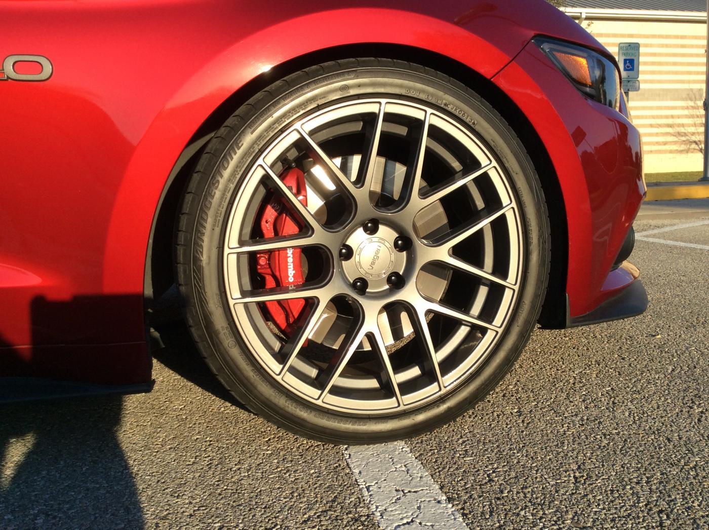

Cleaned her up and took a few pics today. I'm liking the painted calipers. :cheers:
