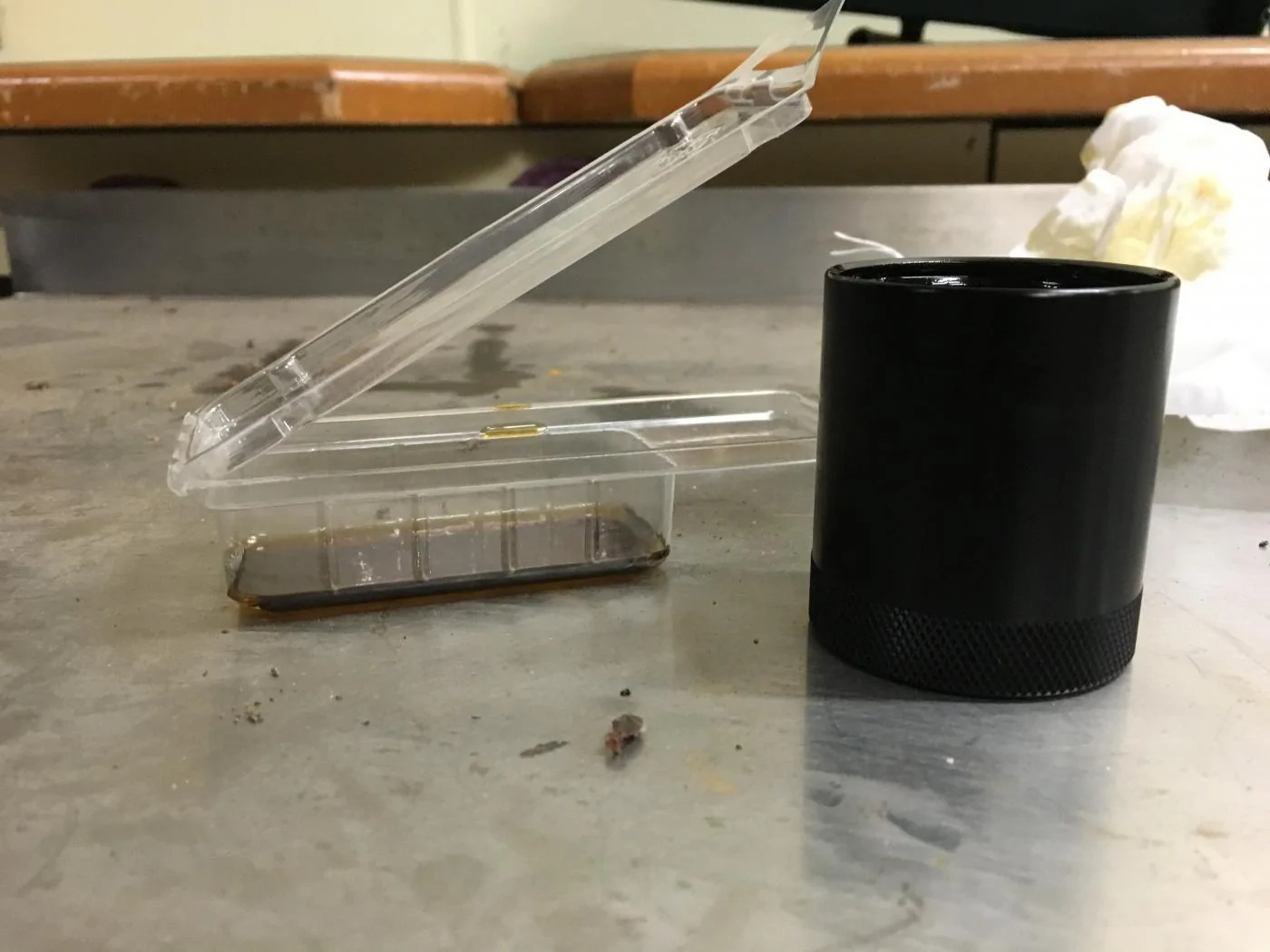

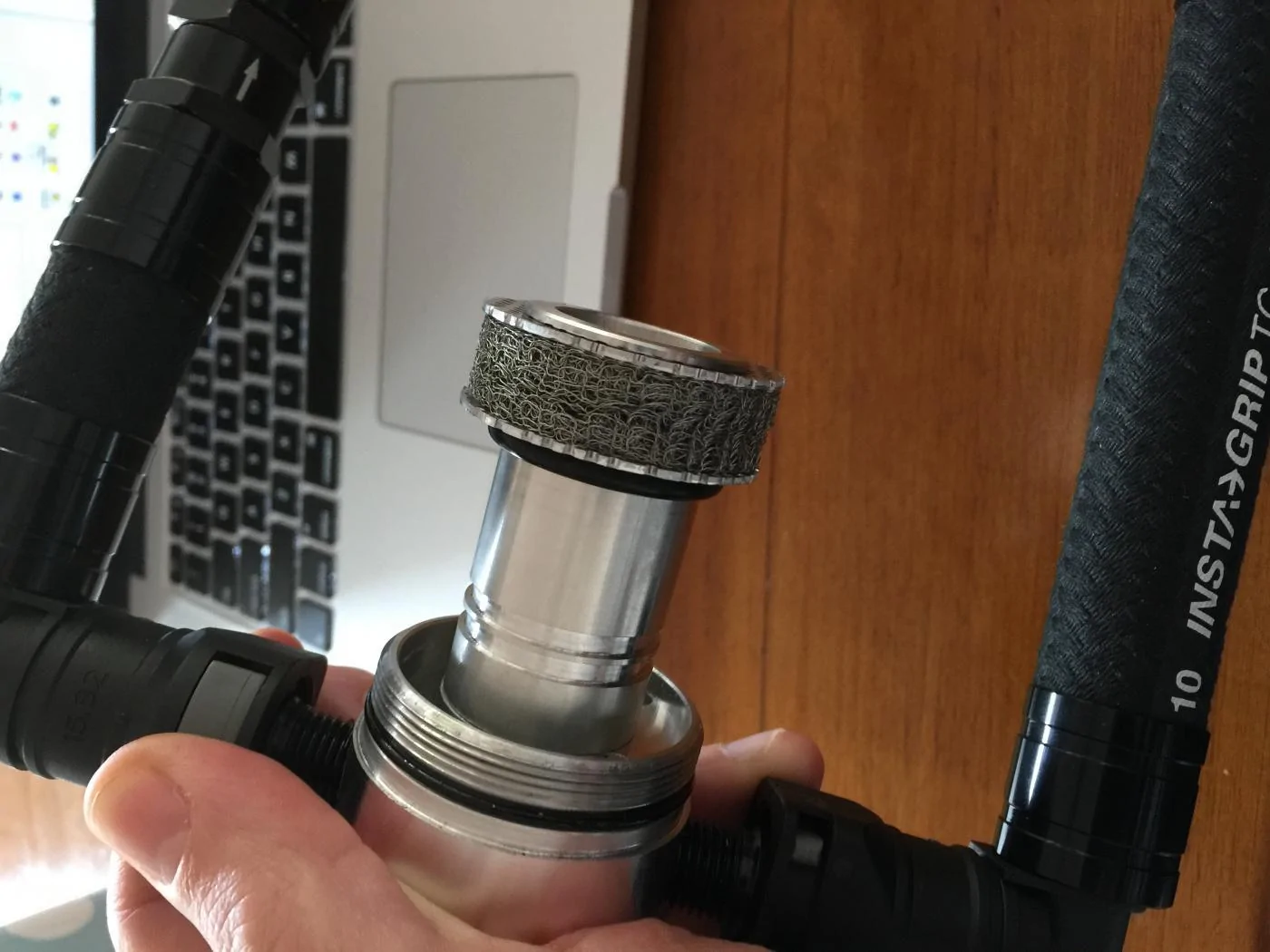

I just put mine on at about 280ks, will see how it goes

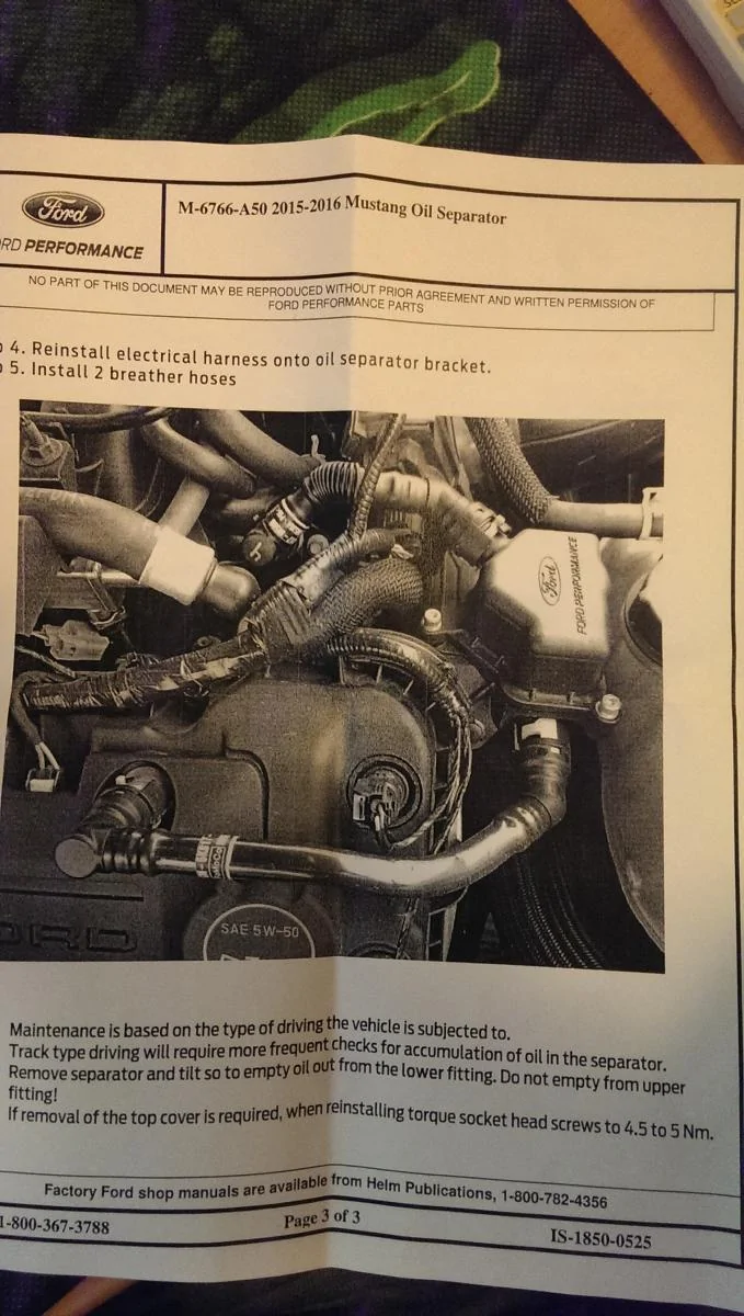

The JLT looks like they splice the filter into one of the existing Ford hoses, so its exactly the same fittings as the standard part, which is nice.
