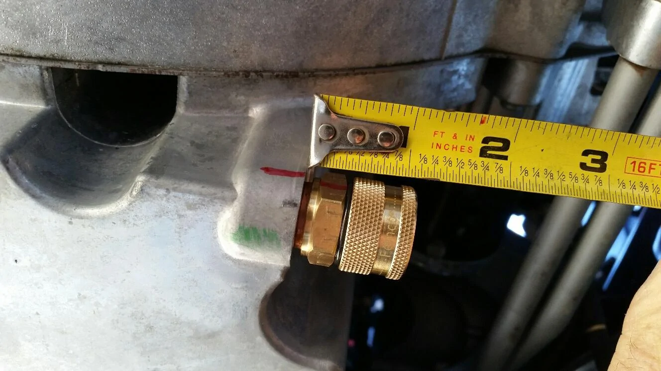

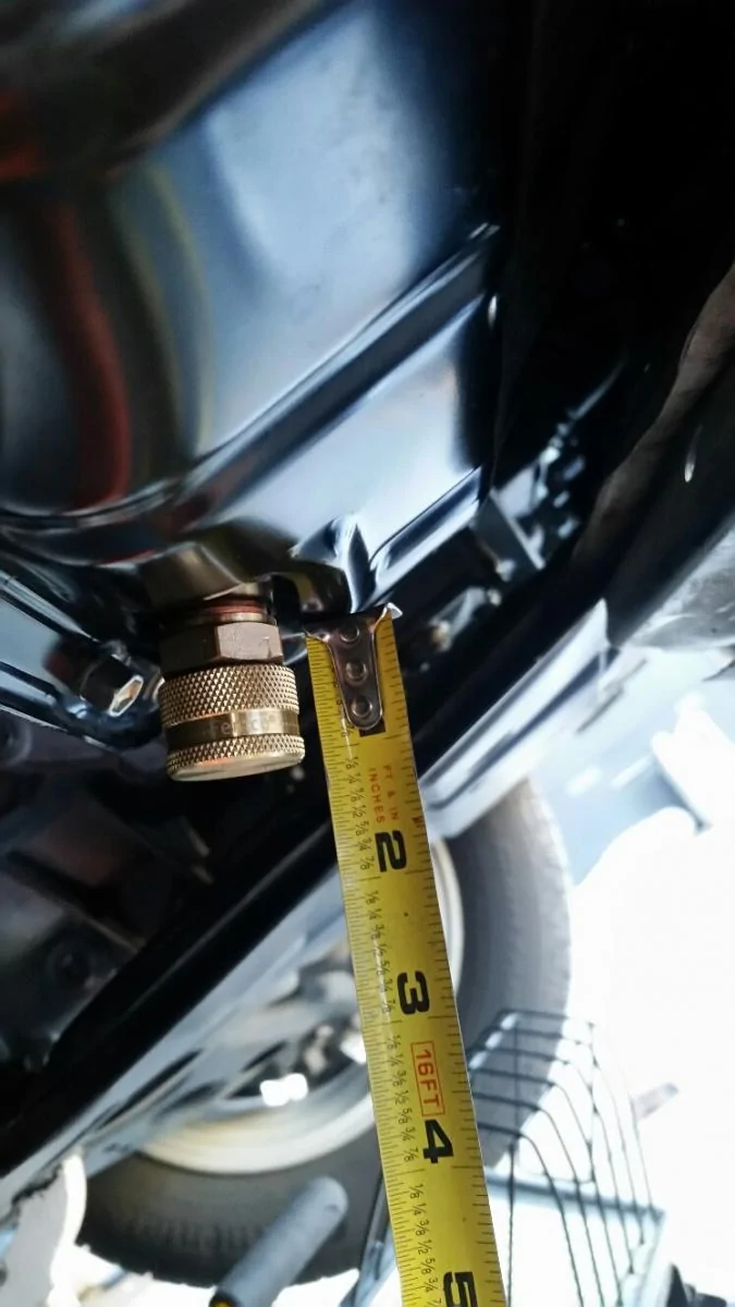

David at Femco basically said what you have been saying. They sell 9mm because most are for vertical applications. They just don't get asked for 12mm, so they carry fewer of those. I've OCD'ed enough. I ordered (3) 9MM valves for our three vehicles.FWIW: As I posted before, 9mm was the thickness of the GT pan PLUS the washer. 9mm will be flush with the inside of the GT pan. Look at the pictures in post 41. The pan itself is ~4 threads thick as shown by the unpainted portion of the factory drain plug. The 9mm thread length Femco valve has 4 threads past the washer.
