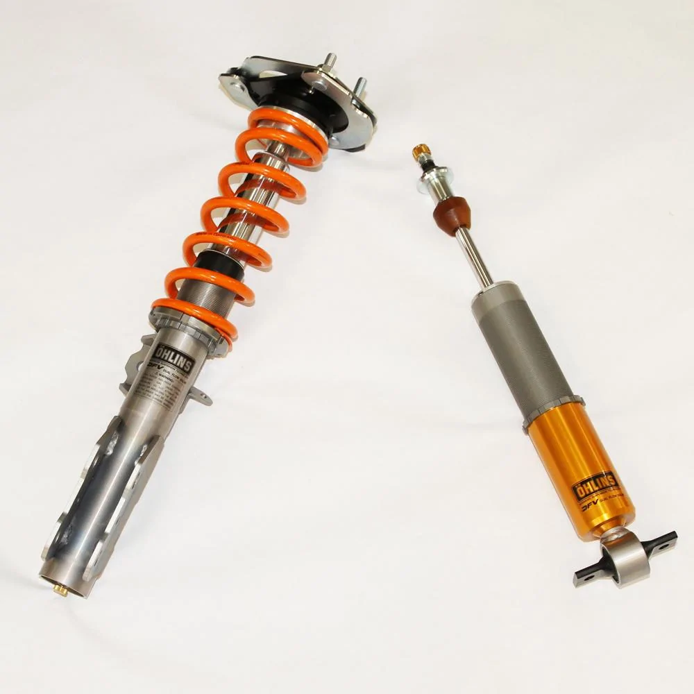

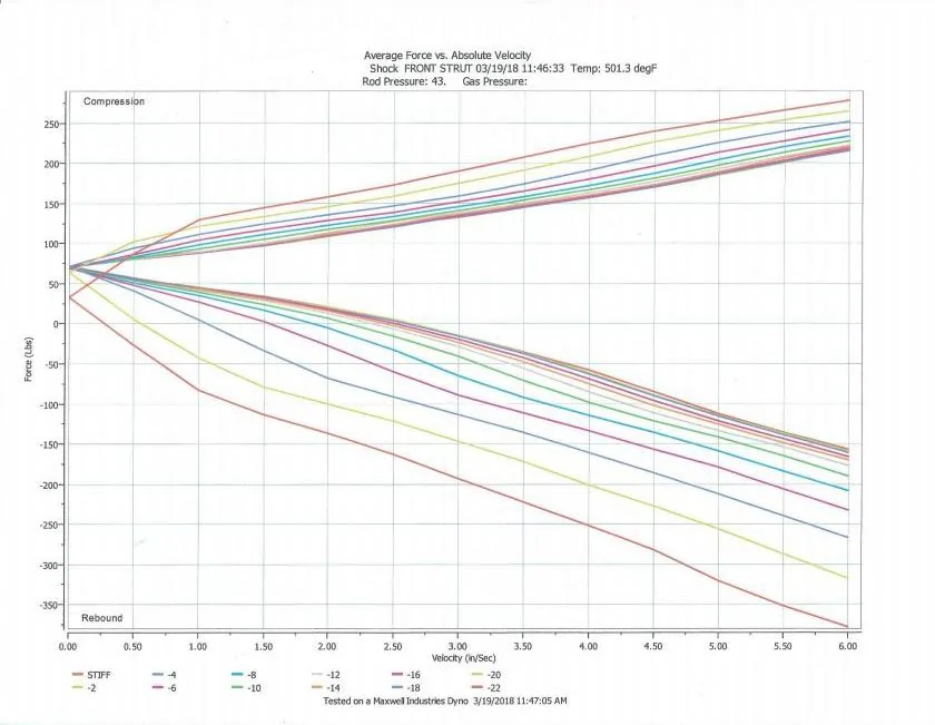

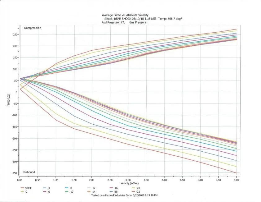

Here you go. We are waiting on the springs that Ohlins' wants us to run to try them out. Looks like these are setup to be a great street / autocross setup. If you want to road race with them we will need to re-valve the front rebound side.
Front
Rear
For someone who doesn’t currently understand these graphs, why would the front need revalved? Kinda silly these are called road and “track” not road and autocross lol
