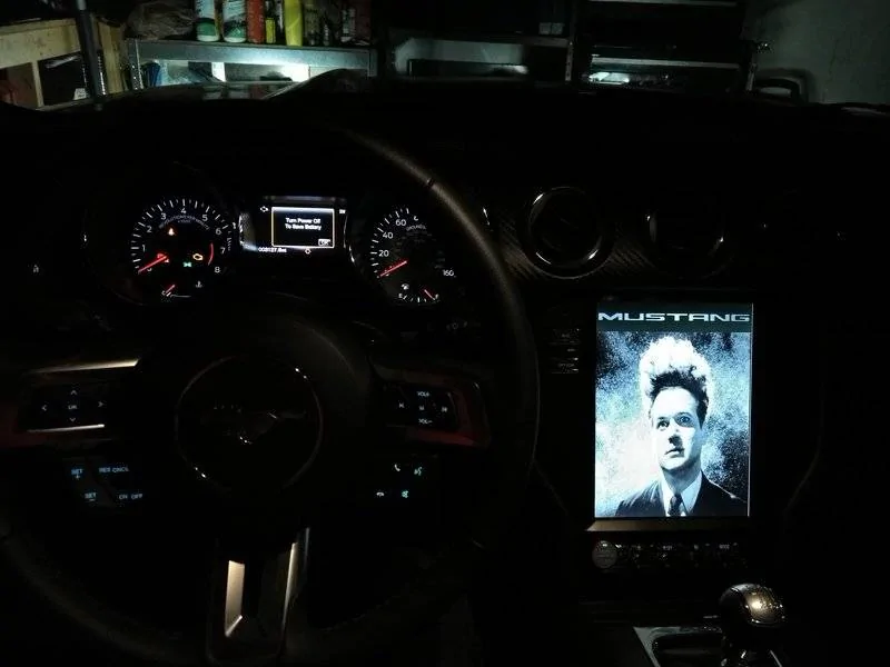

Bahahahaha. Undeniably my car.
Cars all buttoned up. G/Fs about tired of this project, gonna give it a rest until she's working this weekend.
