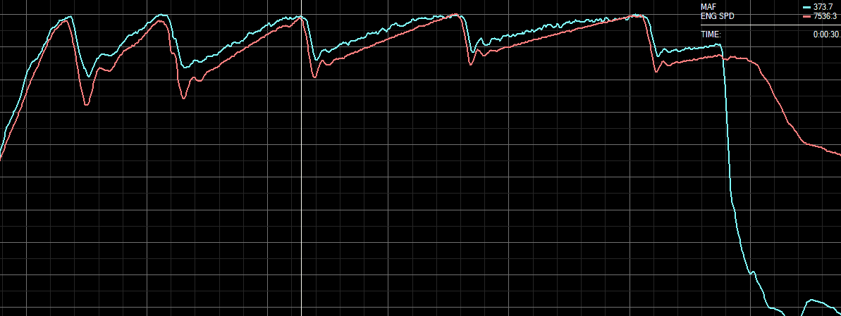

Probably, yes.The peak MAF value in this log is at 6574 RPM. I would assume HP peaks around 6600? The MAF goes down to 46.9 at 7k RPM where I shifted.
Depends. Yours may not possibly because stock manifold.Should the MAF always flow continue to go up after peak hp? In my case it does not. MAF actually goes down slightly with additional RPM.
With my livernois tune my maf peaked around 6600 rpm at 45lb/min around there and went down as rpm climbed. It's in another thread somewhere. Search the thread for exact #s before burning me at the stake lol.Should the MAF always flow continue to go up after peak hp? In my case it does not. MAF actually goes down slightly with additional RPM.

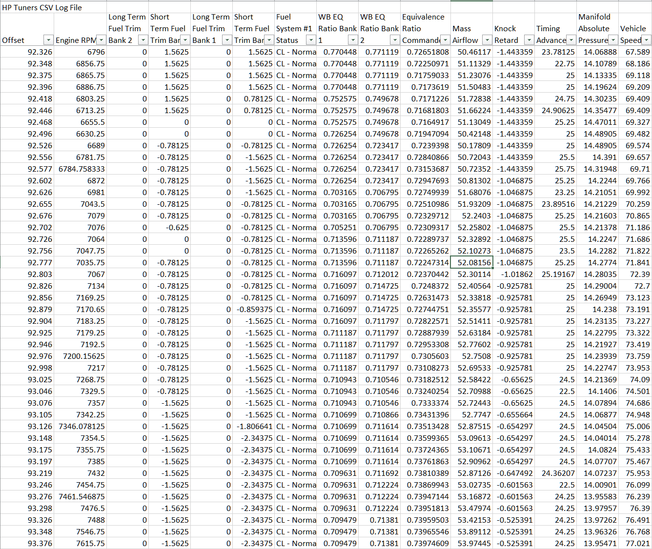

About to begin FBO effort on my new '20 GT A10 base. Only mods so far catch can & wheels/tires.
Will be self-tuning with hp tuners
Just did a first log. Nice cool air, but not ideal humidity and baro (about to drizzle out)
36deg F, 65% humidiity, 29.86 Baro.
3rd gear pull
Surprisingly high readings.
50.5 at 7050rpm and holds through nearly 7400rpm.
Maybe just short of 1% STFT+LTFT so adjustment would only be higher.
