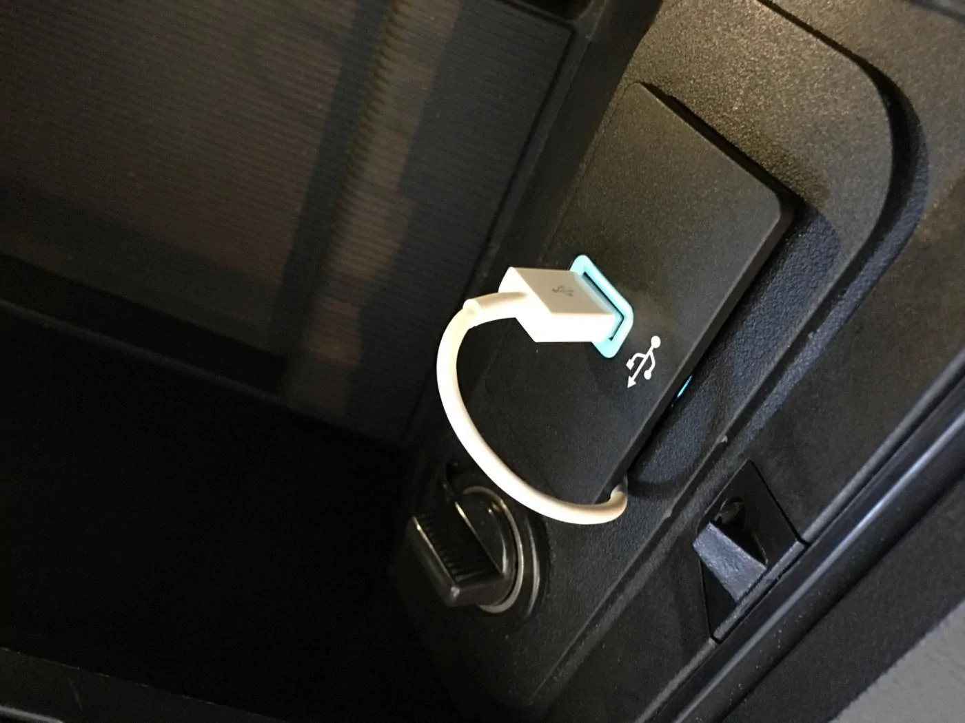

I'd assume for the 2-port part, if you ran an adapter out of the 2nd USB port (USB A Male to Mini Female), it would provide data and power, and you could connect that to the GC. You could just snake it behind the hub plate or modify it with a small slot/opening.
Hub > USB Port > USB A cable/male > USB Mini F connector or M with F/F adapter > Gray connector (would probably need a touch of modification to make the connection due to the factory harness, but simple)

You wouldn't have to hack up your console, just the hub from what I'm looking at - you'd just need enough clearance for a USB cable, that's not much.
(I'm a software engineer but do a lot of hardware hacking, some work in the CV space, I'm all about hacking stuff up :D )
Heck it almost sits flush without any modifications, just a little notch on the bottom side and you'd be good:

My single port part will arrive Monday according to USPS. A lot quicker than I originally thought. If it works before the other part ships I'll probably cancel the other part, but if the other part ships before I can cancel it we may get confirmation on two different single-port part numbers.
Unless you get into hardware hacking the dual-port parts that came from the f150, explorer, and Lincolns will render the front port as nothing more than a lint catcher. Personally, I always plug my phone into the console bin port so my passengers have easy access to the tray port.

If you could source a Male micro B to 2 Female micro B cables (splitter) this could be done behind the new 2 port hub and depending if Sync would allow, you would then have 2 in the console and 1 in the bezel.
I think you would need a chip in there... That may work, but it would be one port or the other. I don't think both would work at the same time

not if you upgrade to dual usb ports for center console :doh: iphone people should just get the single new hub interface and not lose the front usb
I don't know, I kind of dig on the idea of having two in the center console!
What I may do is just wire power into the front USB port for charging, but keep the two hidden port for data connection.
