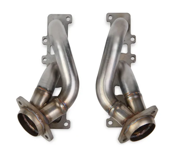

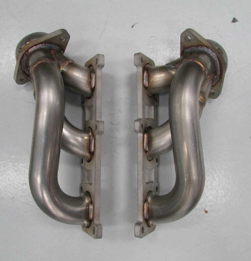

Until icarumba did an excellent job of documenting the loan of his car to Holley for developement of S550 V6 exhaust products for their Hooker/Blackheart line, I was not aware of their headers for our V6.
Many on the forum have added BBK shorties and some BBK long tubes to their V6's. Does anyone besides icarumba (just installed by Holley last month) have first hand knowledge of the Hooker/Blackheart headers?
The tube configuration of the two are pretty different. Specifically, BBK chose the rear cylinder to have the long forward then back path to the collector, whereas Hooker's back tube path is shortest going directly from the port to the collector.
A big plus for Hooker, is that they are in the process of posting dyno charts as well as sound videos for various configurations of their header/ catback/ axle back/ w/ & w/o mufflers. Some have been posted on icarumba's thread here:
http://www.mustang6g.com/forums/showthread.php?t=34924&page=10
JT at Holley promises more sound videos to be posted to their website, dyno charts AND even an interior video to confirm his statement that their axle back w/ mufflers has NO drone. The video will be done when icarumba gets his Rudy Red V6 convertible back to JT to get the AB's installed sometime this month. (they installed and sent him home with the shorty headers last month! THAT is a video I anxiously await!
Link to Hooker Shorties:
https://www.holley.com/products/exh...xhaust/mustang/v6_mustang/parts/70303302-RHKR

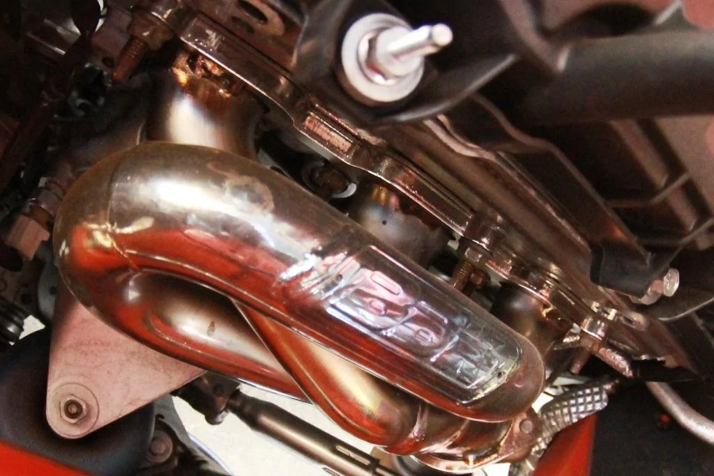

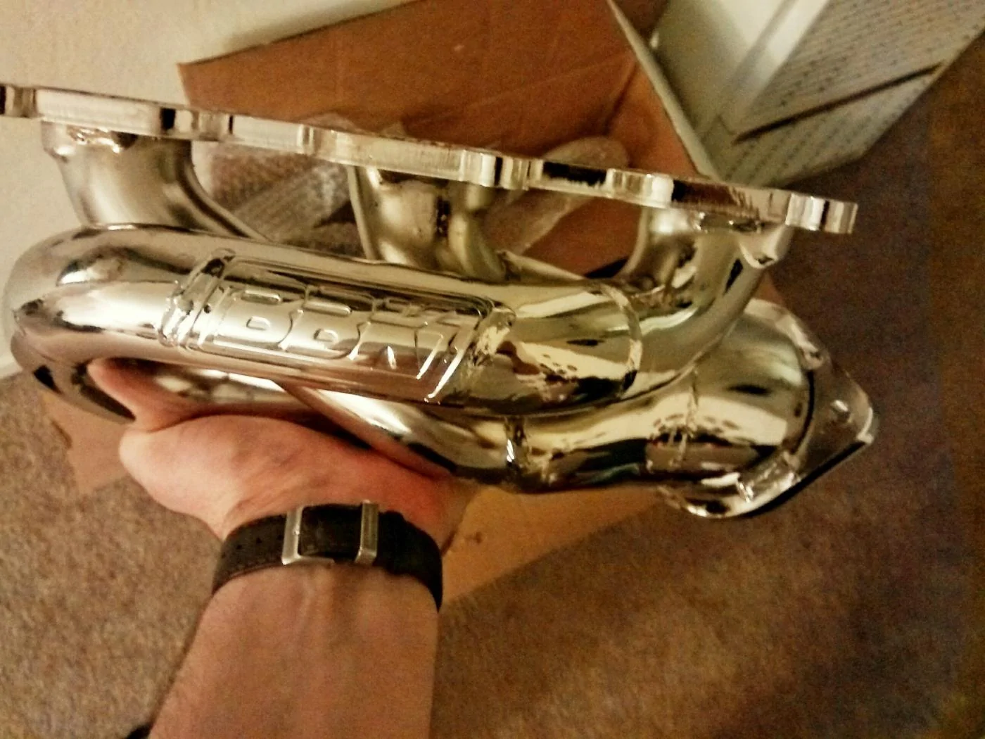

Update: Thanks to Russian for his BBK pics from his build thread!
