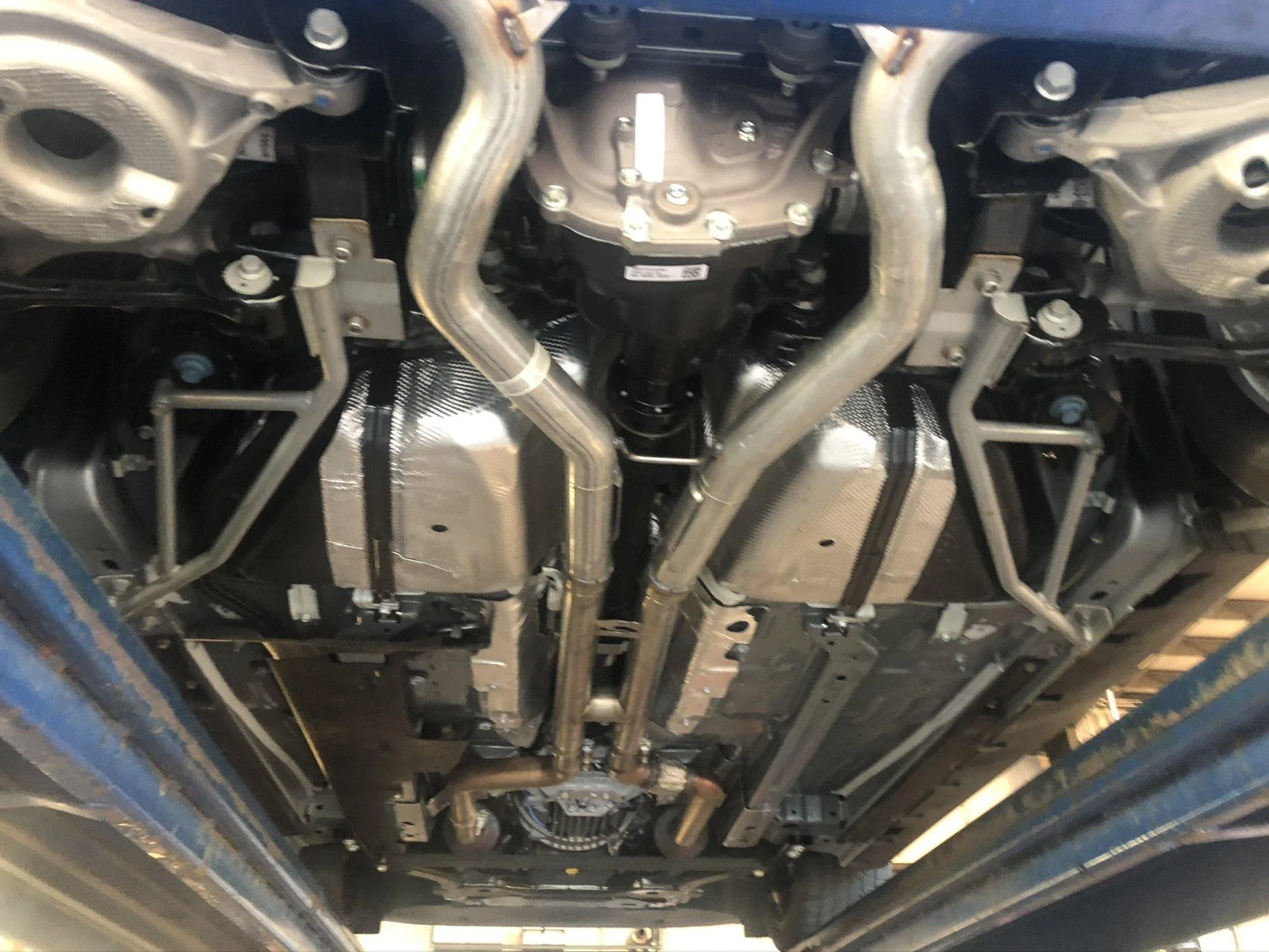

Picked up a '19 GT 6 speed base a couple of weeks ago. Like many have mentioned, the stock exhaust does sound really good for a stock system. That being said, I saw and heard a '18 GT coming out of a gas station the week before I got my car....it sounded great. Not annoying, not raspy etc. After he parked, I asked the guy what he'd done to the exhaust. He said he'd had a H-pipe put in - nothing else. So after some digging, I picked up the Steeda h-pipe.
Took the car by the exhaust shop I've used for years this morning. He welded on the h-pipe and as the crappy picture I took shows - he welded a small brace where the tailpipes split. He said it keeps them some moving around as much
The sound is great, again in my opinion - I know exhaust is a very subjective thing.
Cold start is a bit louder - a deeper growl. Cruising along at speed - it's really not noticeable over stock. Once you get into it, it's louder - but it's somehow deeper. Love the sound.
So in my book, well worth the minimal investment.

Nope. It mimics the factory exhaust - you simply loosen the clamps at the mid pipe, and drop the entire exhaust. I've done it on multiple S550s and it literally takes longer to get it up on jack stands than to drop the entire exhaust.
