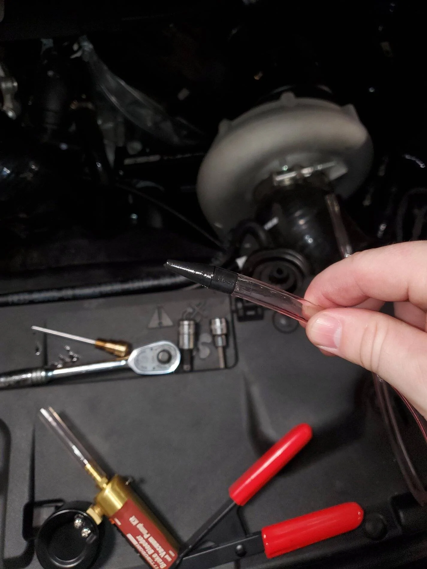

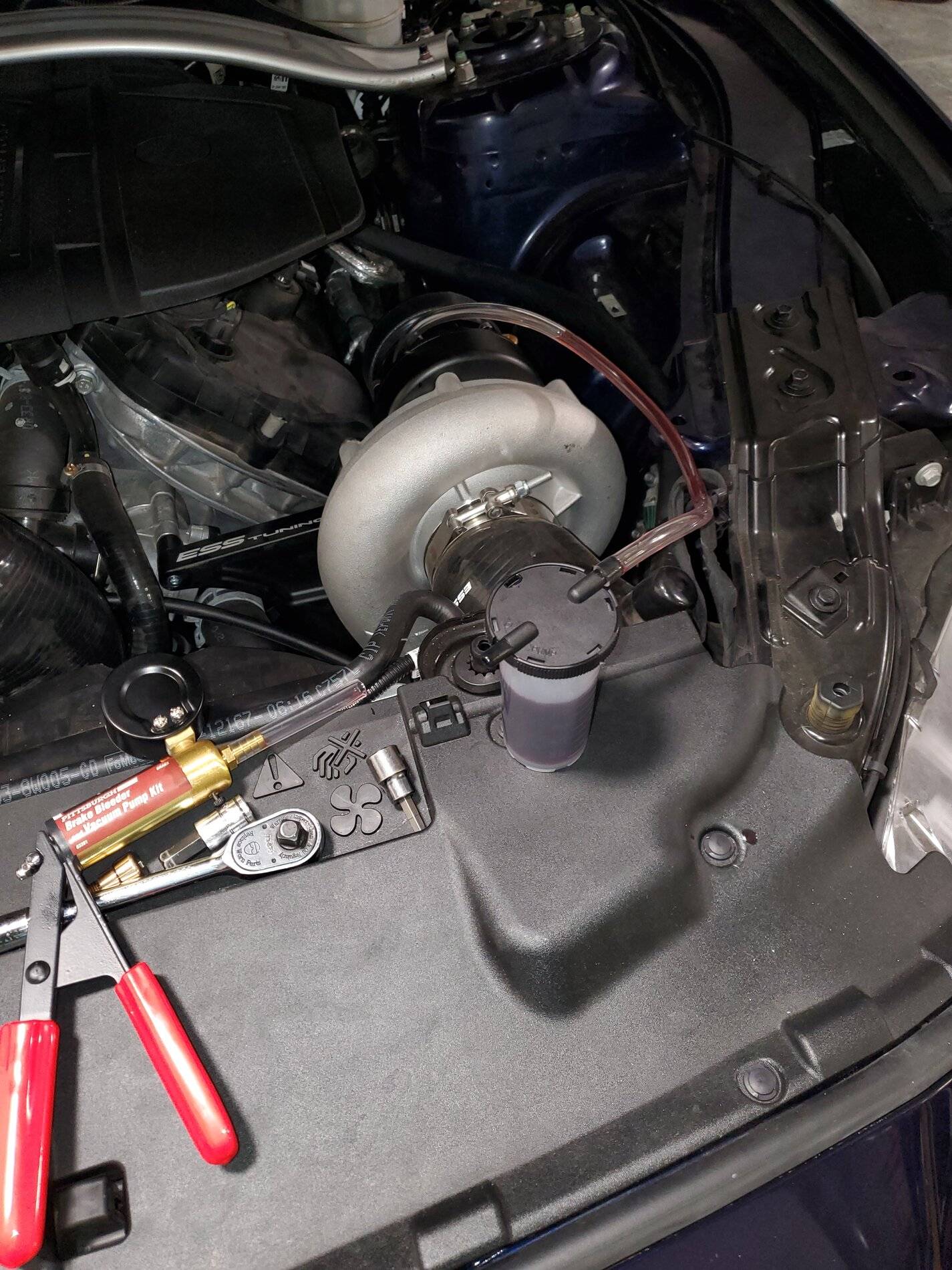

I found a really easy way to get 90% of the sc oil out. You can use a brake bleeder and pump it out. I used an adapter at the end of the tube that went in the sc to help get more out. I measured what I got out and filtered it. The gear oil looks great. I wasn't sure if the headunit needed an oil change after the first 500 miles but I wanted to do it anyway. The brake bleeder method is so easy vs taking the whole thing off. I got the most out of the fill side and kept the dipstick in to create more of a vacuum.
