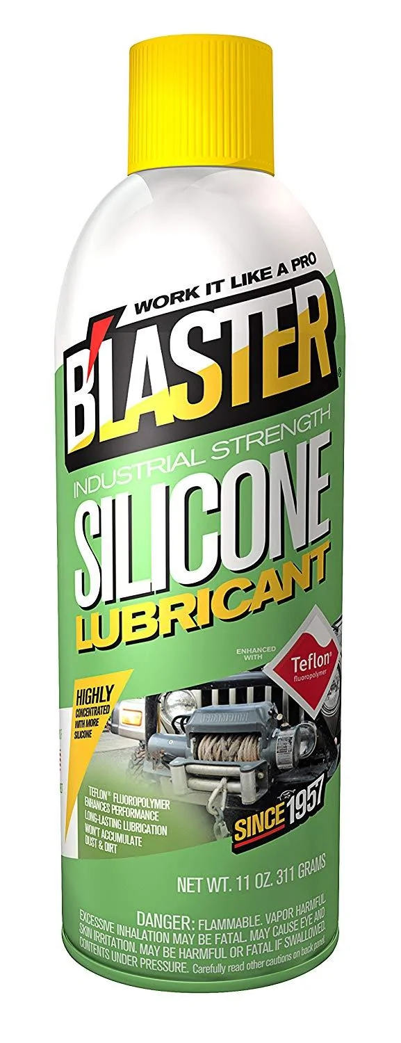

I found it highly annoy and frustrating whenever the rear windows don’t go up all the way. I scoured YT for a fix and not a band-aid to the problem. For us as owners, I don’t think we should have to use silicone lubricant, sunscreen, chapstick, or deodorant on the rear window just to think “I fixed it!” Or even pulling the rear window shut for that matter. I used to use silicone lubricant, but it got to the point that even the lubricant wasn’t helping anymore.

The only thing that helped at all was the silicone spray, and it only worked for a few days on the passenger side which had developed a gap of maybe a quarter of an inch. The gap on the driver's side is between 1/2 to 3/4 inch, and nothing helps except reaching behind me and pulling it shut.
Maybe I'll try more spray.

I had that early on, took it to dealer. they did the silicon but told me that the motors might need tweaking to close all the way. It was still gapping a little but I needed the car for my track dates. few days later windows went all the way up, pop! I saw the silicone the mechanic had put in, wiped the excess down and it's been good for over year. Weird issue, Ford could do better.
