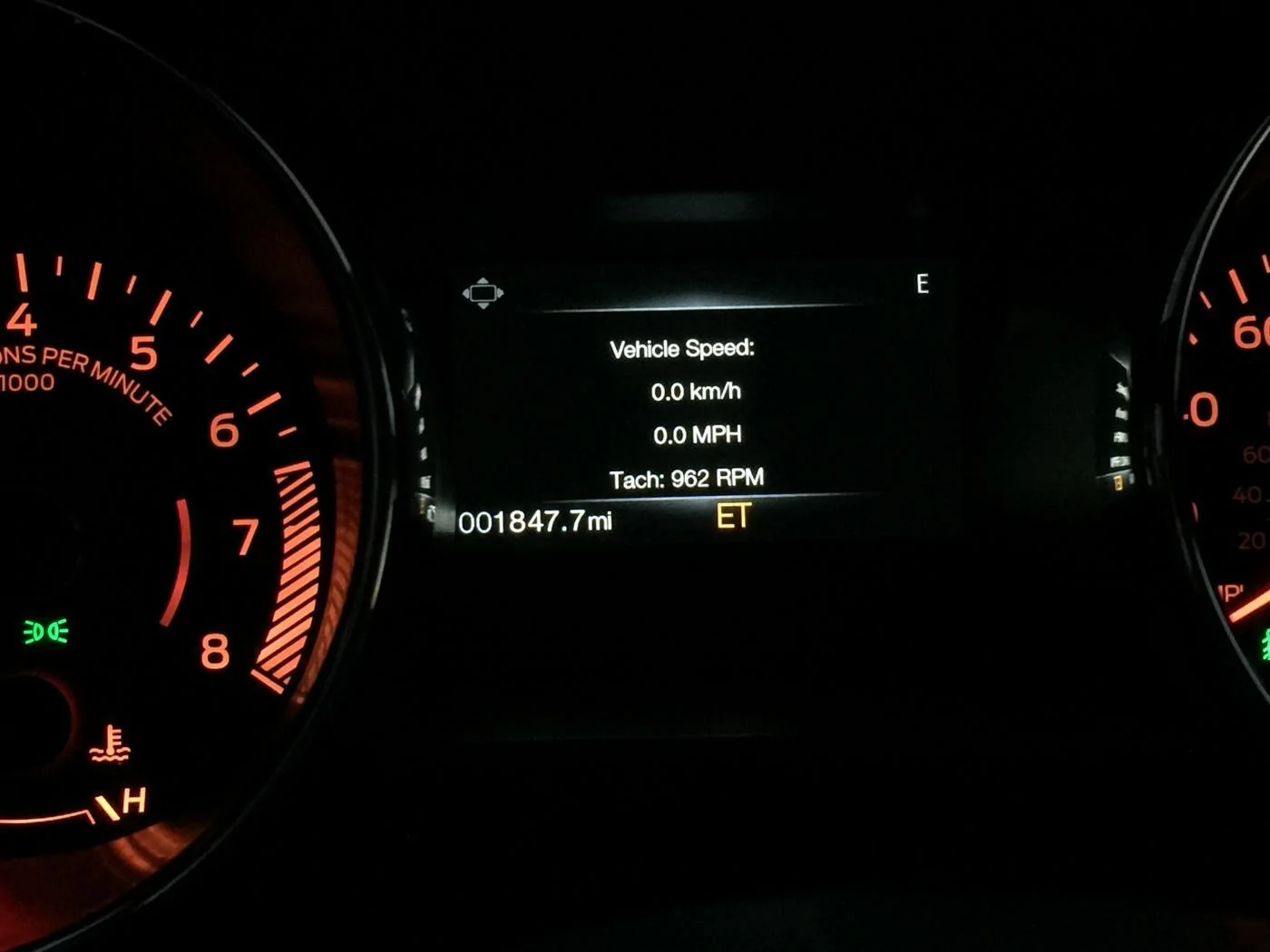

Hey guys i don't know if this has been posted but there is a way to get a digital speedo and tach on the screen in the center screen between the gauges.
If you hold down ok on the steering wheel and put the car into the accessory mode. You'll eventually see an orange ET at the bottom of the screen this will be the indication to turn the engine on. While still pressing the ok button turn the car on. This will put the screen into a mechanics mode. If you cycle through the menus you'll eventually come to a screen that has speed in both KPH and MPH as well as the rpm.
Hopefully this is new info for some. It isn't the fanciest of screens but it gets the job done :cheers:
