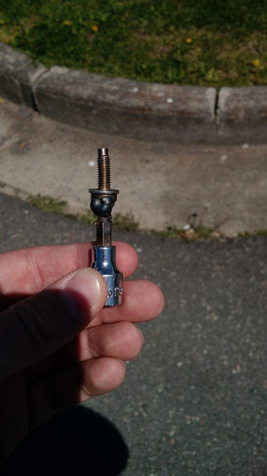

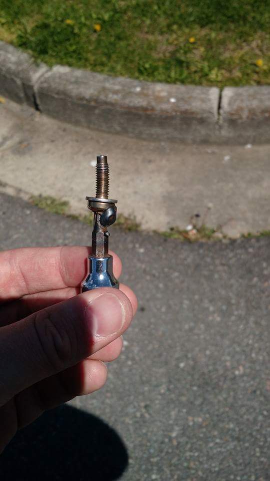

Removing the counter weight (what jbailer is referring to) and tacking the torx bit to it is going to be the easiest method. Trust me on this one. I tried a little bit of everything except for cutting the heatshield and I didn't want to do that because it still doesn't remedy the problem.
