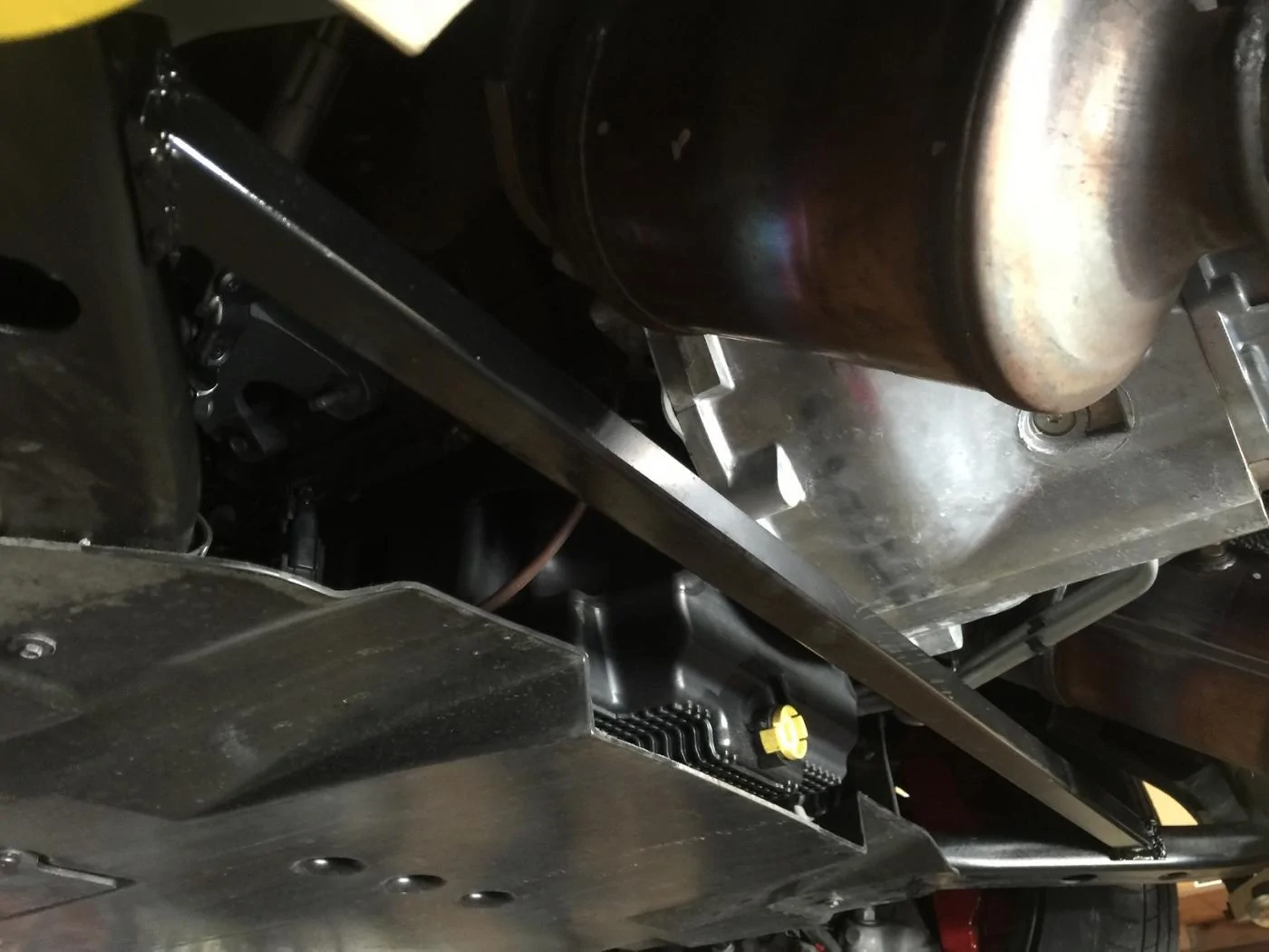

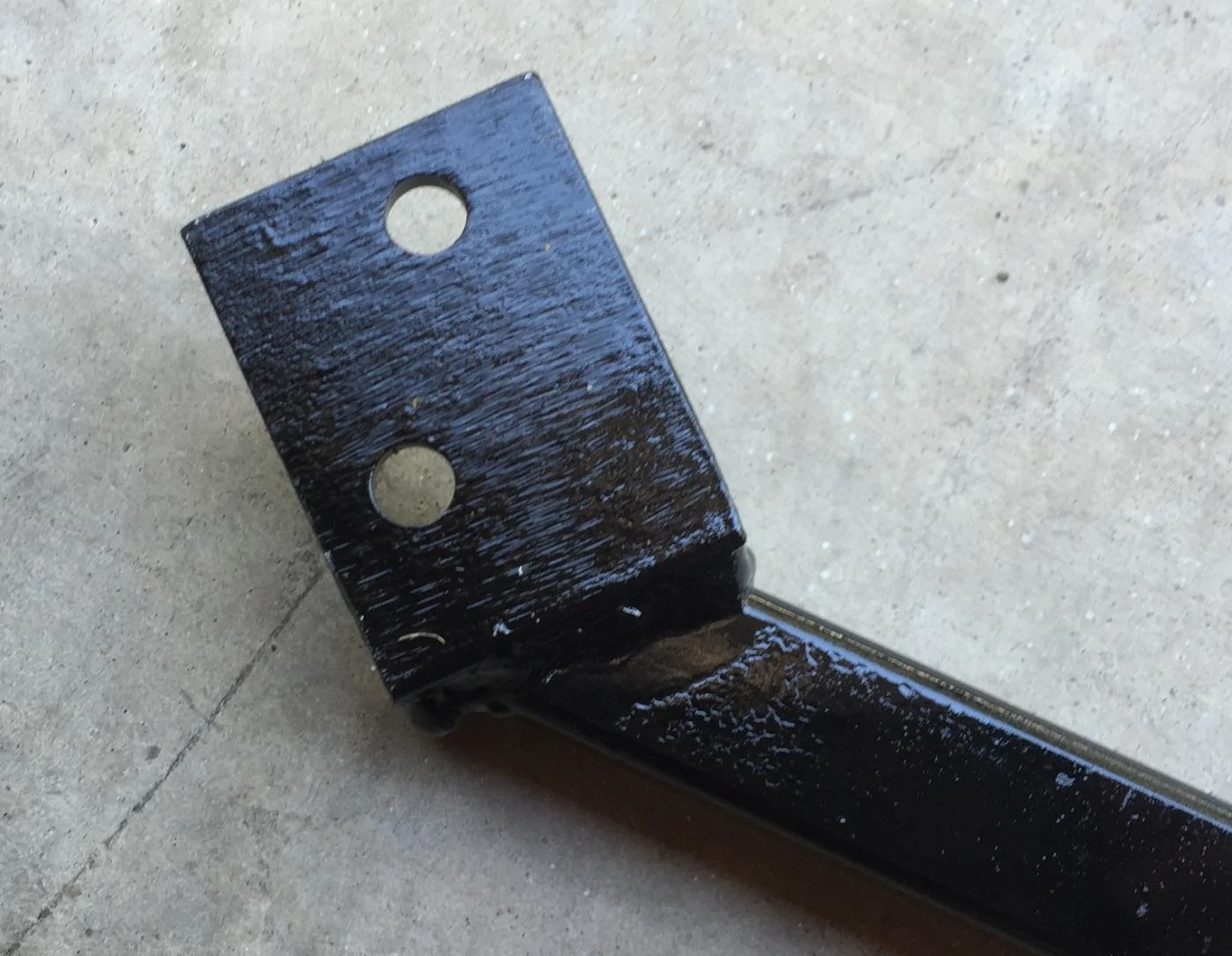

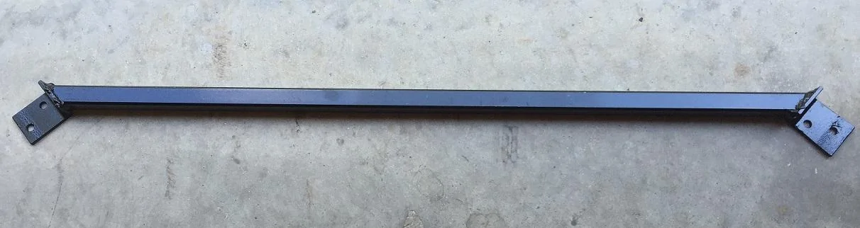

I built my own out of some scrap steel laying around the shop. I also went with a different mounting system than the Steeda brace. I felt like two bolts on each side would help keep the brace from rotating around the single bolt mounting position, although a flush mounting to the side of the brace probably mitigates that anyway.
I can tell a difference in tramlining, although it's not 100% cured, it is better. Car seems more solid in corners, but that may be psychological more than anything since the car is nearly perfect as is. Here are some pics:

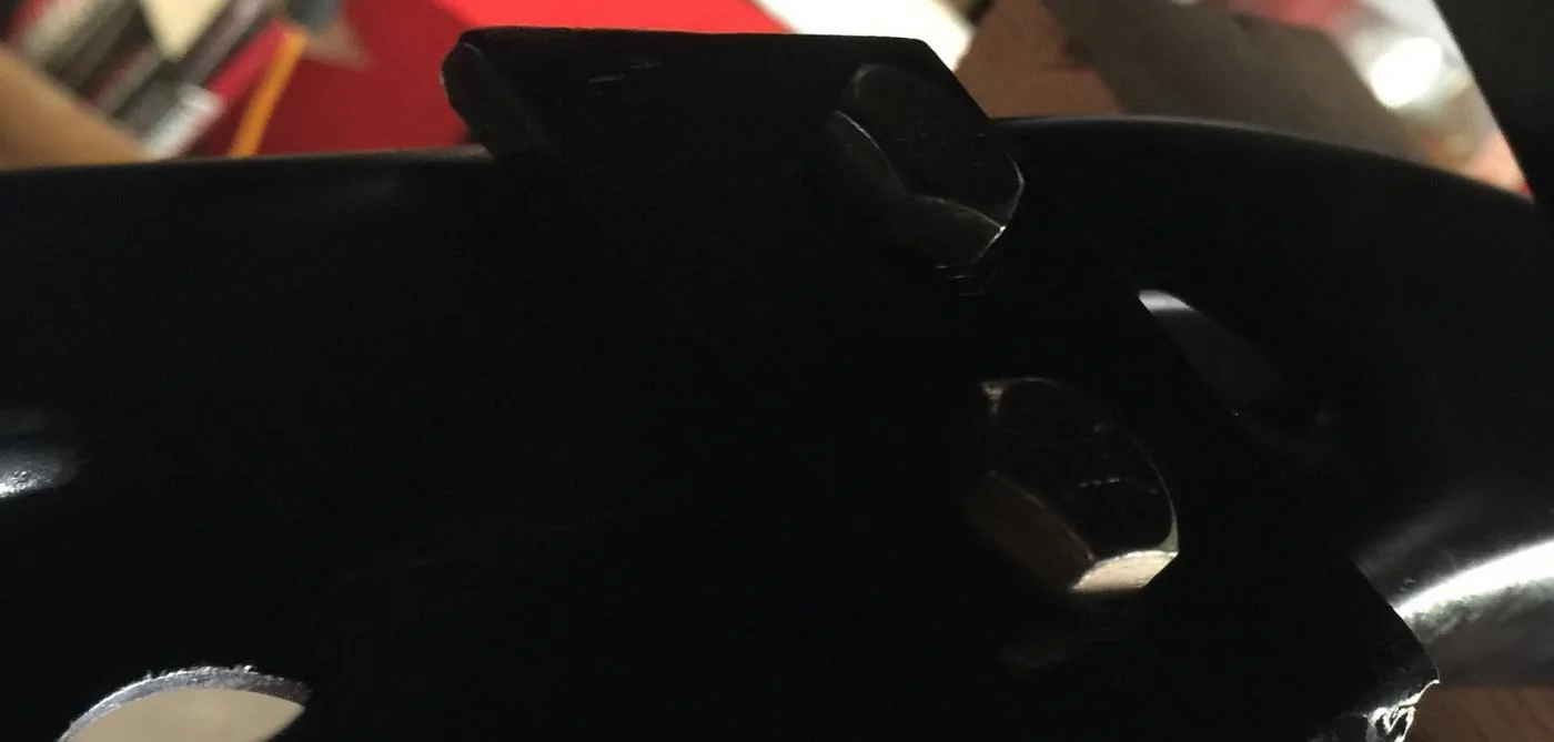

Curious on how you mounted this with the extra holes. Did you drill through the sub frame? If so, what did you use to re enforce the holes? I assume you realize you need a sleeve inside the sub frame for these bolts to go through. Without them, you can damage the sub frame. Or so I've been told.

There are two holes in the top of the subframe that I used with short bolts through the mounts on the brace. The spacers/sleeves are only needed if you're mounting in the rear hole that goes all the way through the subframe. Without the spacer, you could crush the subframe when tightening the bolt.
Feeding the washers/nuts into the subframe through the larger hole in the front was a bit of a challenge, but once started, I was able to get a wrench in there to hold them while I tightened the bolts from the top.
