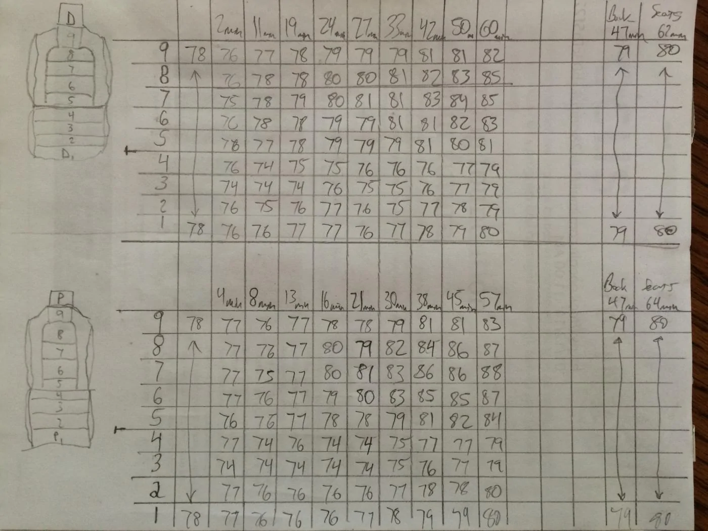

Experiment Results
Where I live, late summer temps can exceed 100 degrees F and the other day (~80 deg) I thought my seat cooler and seat (back) heater wires got crossed. So after finding and reading this forum, I decided to experiment.
Equipment:
2015 Convertible GT Premium w/ 50th Anniversary Appearance Package
Handheld Cen-Tech Infrared Thermometer
Initial Conditions:
Car parked in carport (and not started) since evening before
Car left in carport for entire test
Car started and convertible top lowered
A/C not started
Seats not occupied
Initial temps taken and then seat coolers started (all 3 bars lit)
Method:
Average temperature across each seat panel recorded.
Control:
Front seat temp taken prior to starting seat coolers.
Rear seat temps taken near end of experiment
Results:
See attached image.
Conclusion:
Seat coolers increase seat back tempurature (with convertible top down and with AC off).

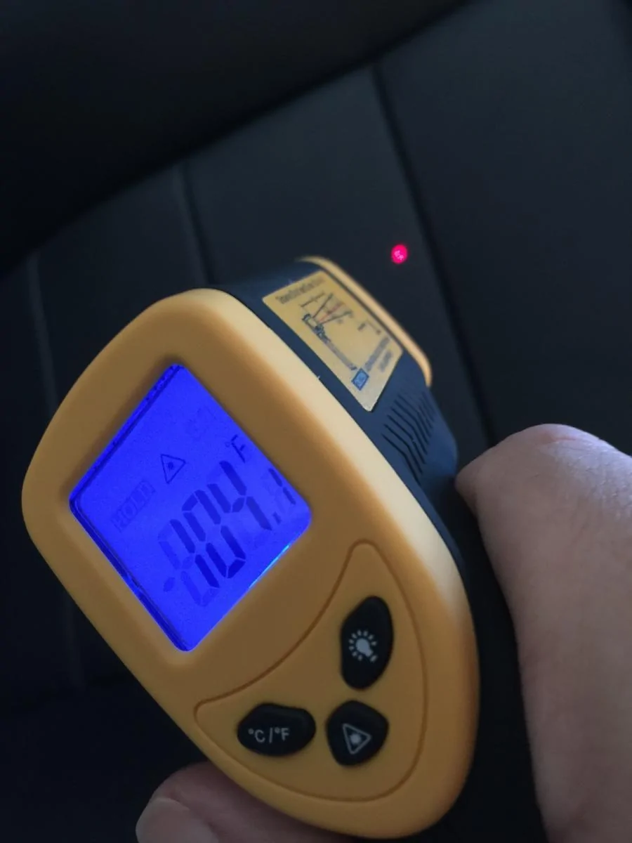

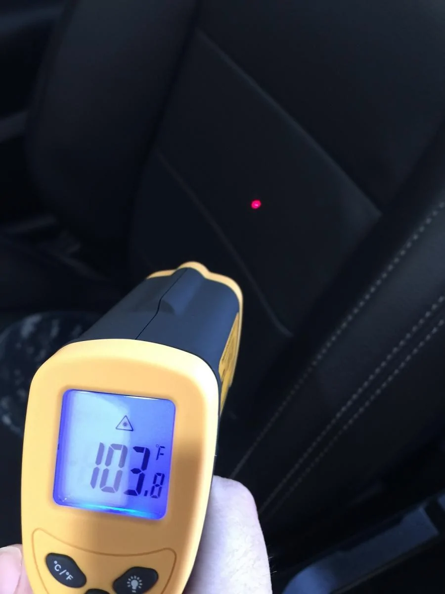

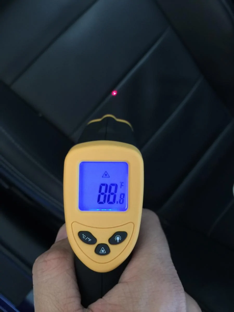

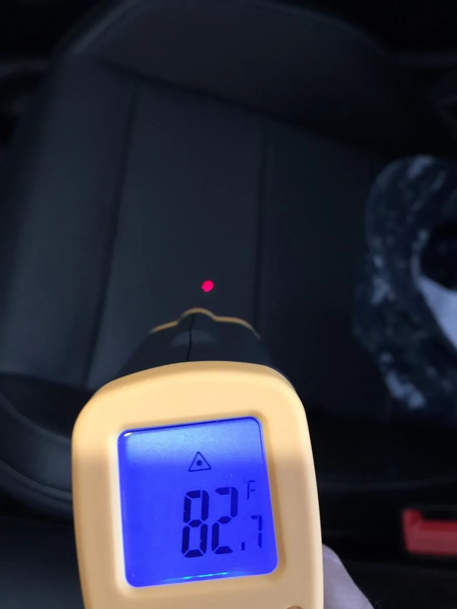

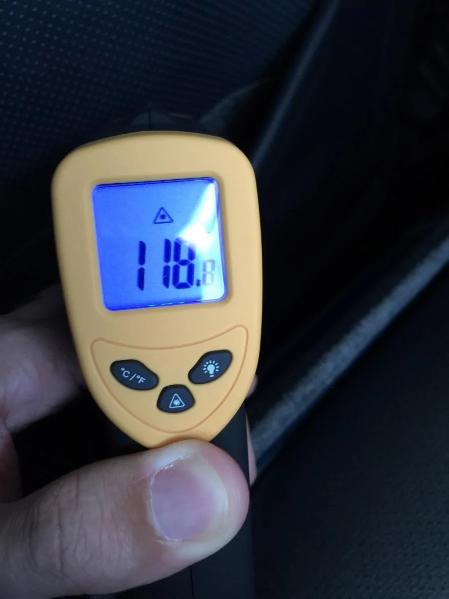

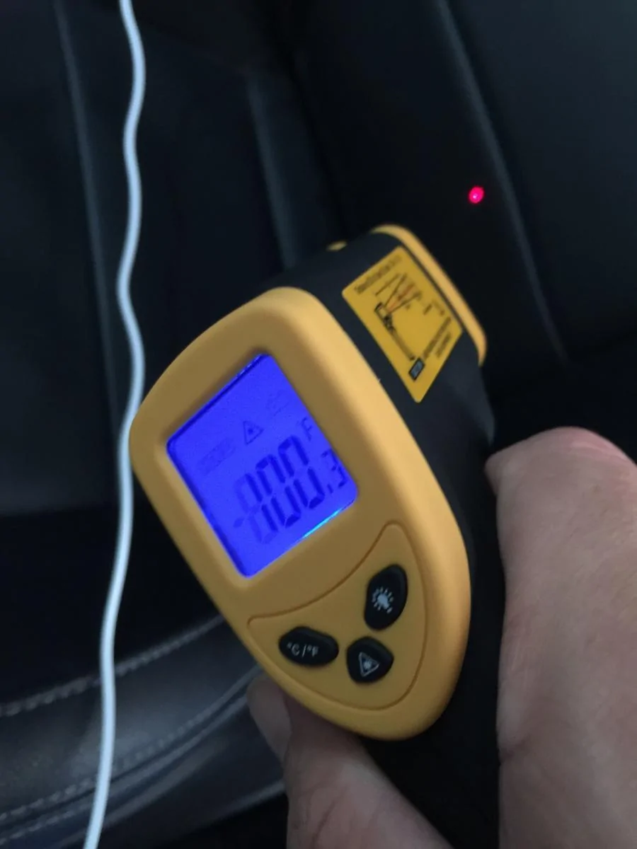

So, the weather and opportunity finally agreed and I was able to get some temperature readings. When I have another opportunity, I will be getting temps of the seats without the coolers on.
On a 90 degree day, after sitting outside with 35% tint and a sunshade from 8:00AM to 4:00PM I had about a 30 minute drive home with no passenger.
With climate set to 70 degrees and both seats on high cool (3 lights) for the entire drive I took the temp readings when I got home (again, 30 minutes of AC and seat cooling)
Driver's seat bottom - 88.8 degrees
Driver's seat lumbar - 100.3 degrees
Driver's seat back - 104.1 degrees
Passenger's seat bottom - 82.7 degrees
Passenger's seat lumbar - 101.1 degrees
Passenger's seat back - 103.8 degrees
There is NO reason a cooled seat should be above body temp.
Now considering that it only heats when the seats have had a chance to heat soak, that means the heat exchanger for the lumbar does not work properly. It is obviously intended to be doing something, since you can both hear and feel the fan blowing air.
Also an added note, I took the temp of the center of the rear of the seat back and it was a whopping 118.8 degrees. @FordService is this normal/expected?
Attached are pictures of all except the passenger lumbar, I missed that one. Apologies for the quality, phone was almost dead and had to be plugged in making it difficult.
I'm not quite following the part in red. Are you saying that since the cabin AC is set to 70 and has cooled everything down, and the back of the seats are not measured to be 118 deg, that you've concluded that the heaters in the seat backs are causing the seat backs to be warm? If so, then it almost seems like there is some reverse control logic going on with the system.
And yes, many members have notes that the fans are running in both the bottom and backs of the seats and they can feel some slight air flow through the perforated leather where the fans are physically located in the seats. As I asked in my post, I'm wondering if there really is an active cooling element (thermo-electric)/heat exchanger in the seat back ... or is the fan just there to blow cold cabin air (from the AC being on) through the seat backs?
Lot's of questions still need to be figured out before a real conclusion can be made on this mystery.
FeedtheNeed
Oct 5, 2014
85
2015 DIB GT Premium
What I meant by that was that when the car has not sat in heat for a while, such as over night/in garage/not a hot day the seats only blow ambient air.
This suggests that there is something within the system that is not in direct view that retains the heat on a hot day and subsequently is what is causing warm air to blow.
If there is supposed to be a heat exchanger for the lumbar portion, it does not work properly. If there is not, then I would like to know how the lumbar portion is intended to be cooled.
As far as the 118 degree spot on the back, it is definitely part of the heat exchanger system (can't have cooling somewhere without generating heat somewhere else). My question is whether that is supposed to be the case since it seems like a potential fire hazard or long term leather damage.
I'd really like to hear Ford's response to this. If the lumbar section really is suppossed to be a part of the "Cooled Seats" feature, this option is a rip-off. :mad:
