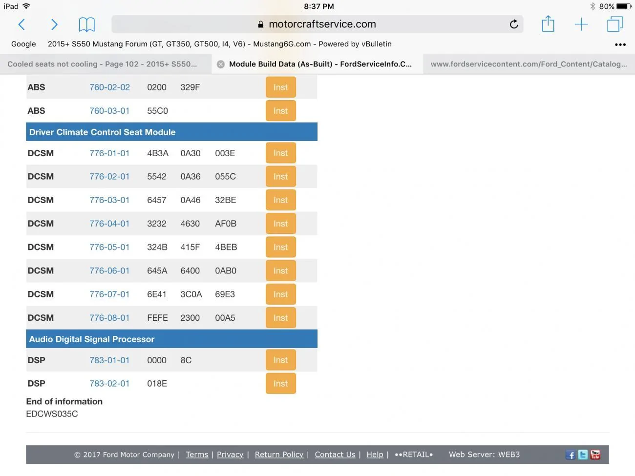

I just compared that to mine. The only line that is different is 776-03-01
Mine is 6457 0A46 32BE
Before just throwing some values in there though, maybe I'll consult some of the gurus in the as-built thread and see if they know already or can determine what that location modifies.
Does your car have automatic dual climate control? Not sure what else to ask to compare.
It would appear that value is the same in all GT350's that have cooled seats. Yours matches the value in my EB.
I have a feeling that this wouldn't be an as-built mod, but a software update to change the way the blower operates.
Help me understand your reply. Are you comparing your value for that address to mine and saying there's no change? Mine is a regular EB, not a GT350 and I would expect our values to be the same right? Or are you saying that USMC0341 value is the same as other GT350s but different than ours and that it being the same as others means it wasn't an as-built change?
The value for my EB matches yours, while USMC0341's value matches all GT350's with cooled seats. It's just a difference between the models, not something that was changed after a software update.
:brokenheart: Well that's disappointing... I was really hoping his would be different from others and it might lead to an answer.
I think I'm going to give up on these cooled seats. Ford obviously doesn't know how to cool seats. I spent the money for them assuming they did. Lesson learned. The TSB did almost nothing and from reading experiences from others about the DIY fixes, I'm not convinced that will make a measurable difference either. I really had my hopes up for a bit there...
Just curious how you came to this conclusion. I'm assuming you have access to additional data from other GT350 owners or something, but you didn't make that clear.
Perhaps USMC0341 could check the software version for the SCME module. They may have done a full software upgrade versus just a parameter change.
I only have access to the phone app for Forscan right now so I don't know if the Windows version provides more detail. It says the software version is V11 2009-12-07. It also says the strategy is BU5T-14C144AB.
You can get an asbuilt for any newer Ford model from https://www.motorcraftservice.com/AsBuilt. So I just searched Autotrader for all GT350's across the country, then narrowed those down by the ones that have cooled seats only, and pulled a bunch of asbuilt files to look at that specific module. All of them shared the exact same value.

Here's mine, different on at least 2 lines. I have a GT Auto Premium with dual air
I only see one line different and it's the same as mine. Just 776-03-01 right?

I just looked up my As Built info, and it's all the same as compared to RIBS and jbailer As Built for the "Driver Climate Control Seat Module". Mine is a 2015 GT Premium with dual climate control.
