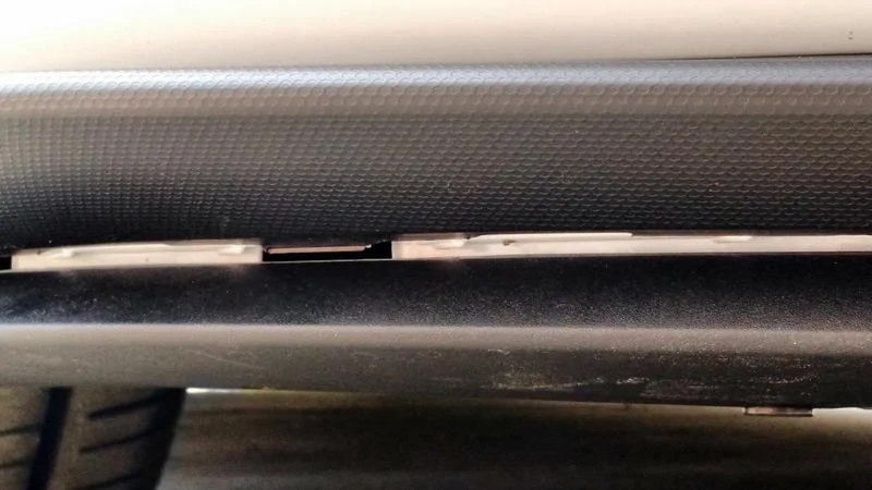

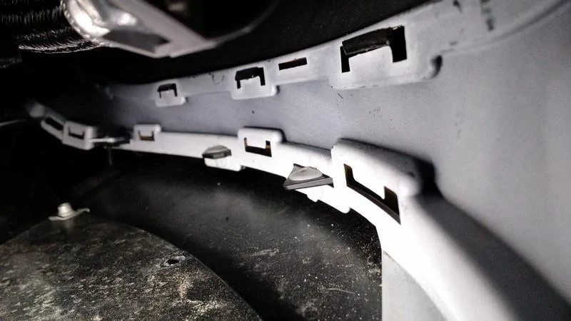

After removing all screws from underneath the splitter to see why there was a separation I discovered that the tabs were missing above the half moon clips on the short piece of the splitter( passenger side) and noticed there was a screw missing underneath as well.
