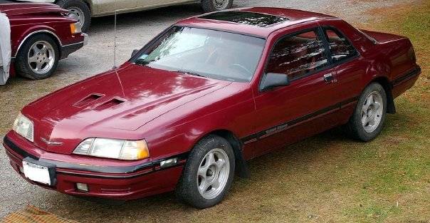

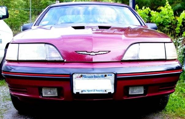

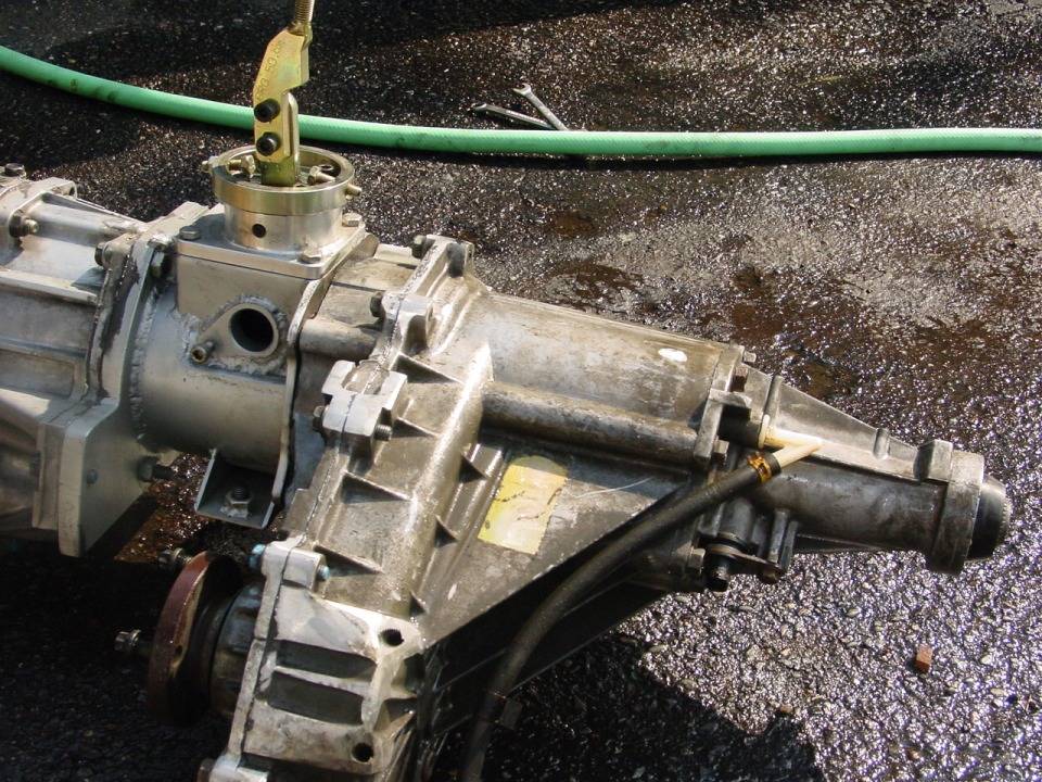

Here is my old project.
A couple of videos:
The Merkur has done a best of [email protected] in the quarter on pump gas and street tires. It is a stick

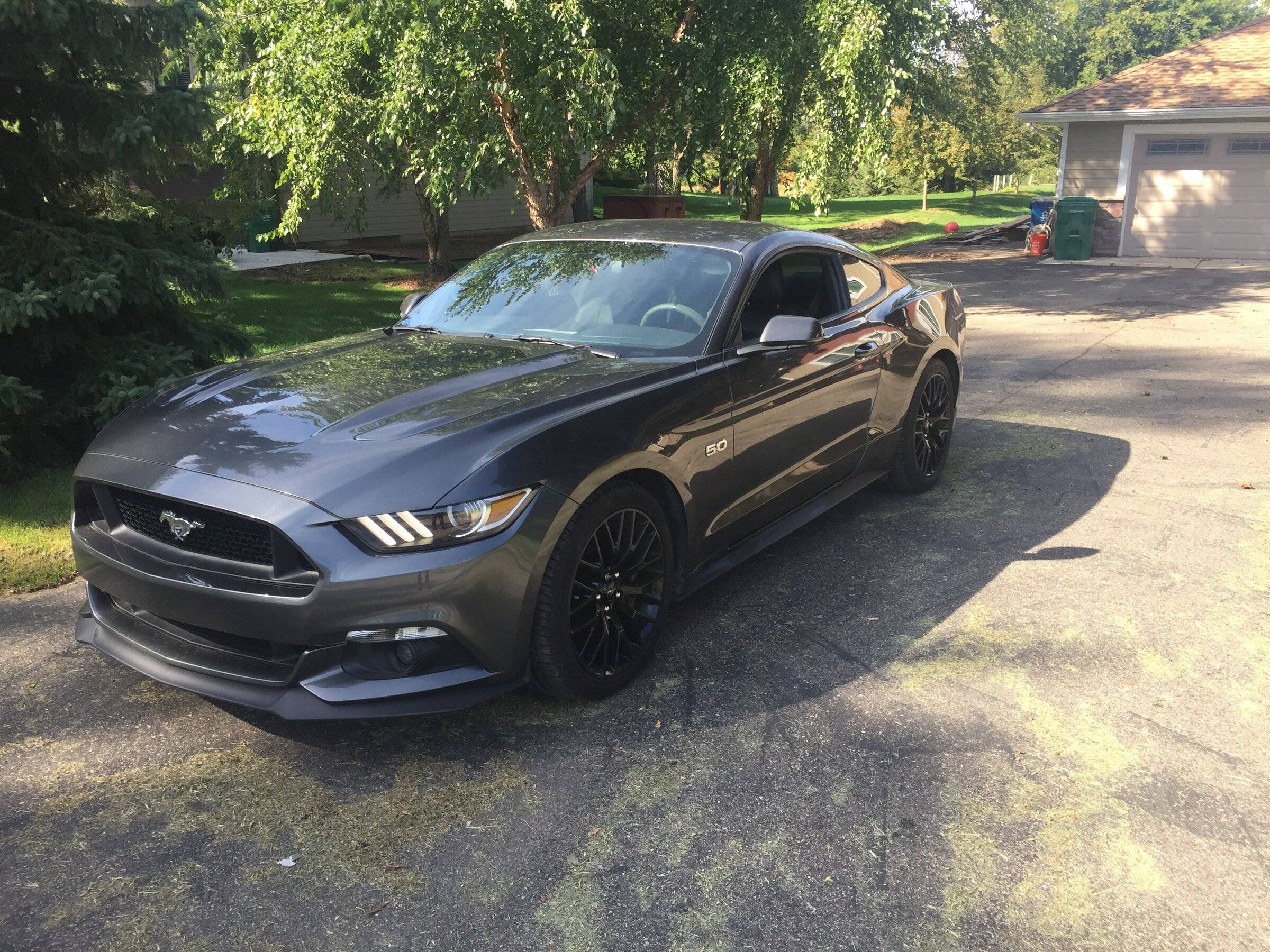

Here is the Mustang the day is what delivered.

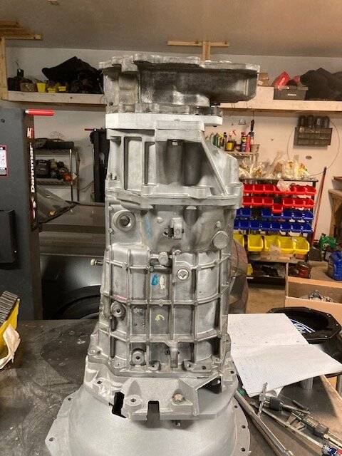

Transmission: TR6060

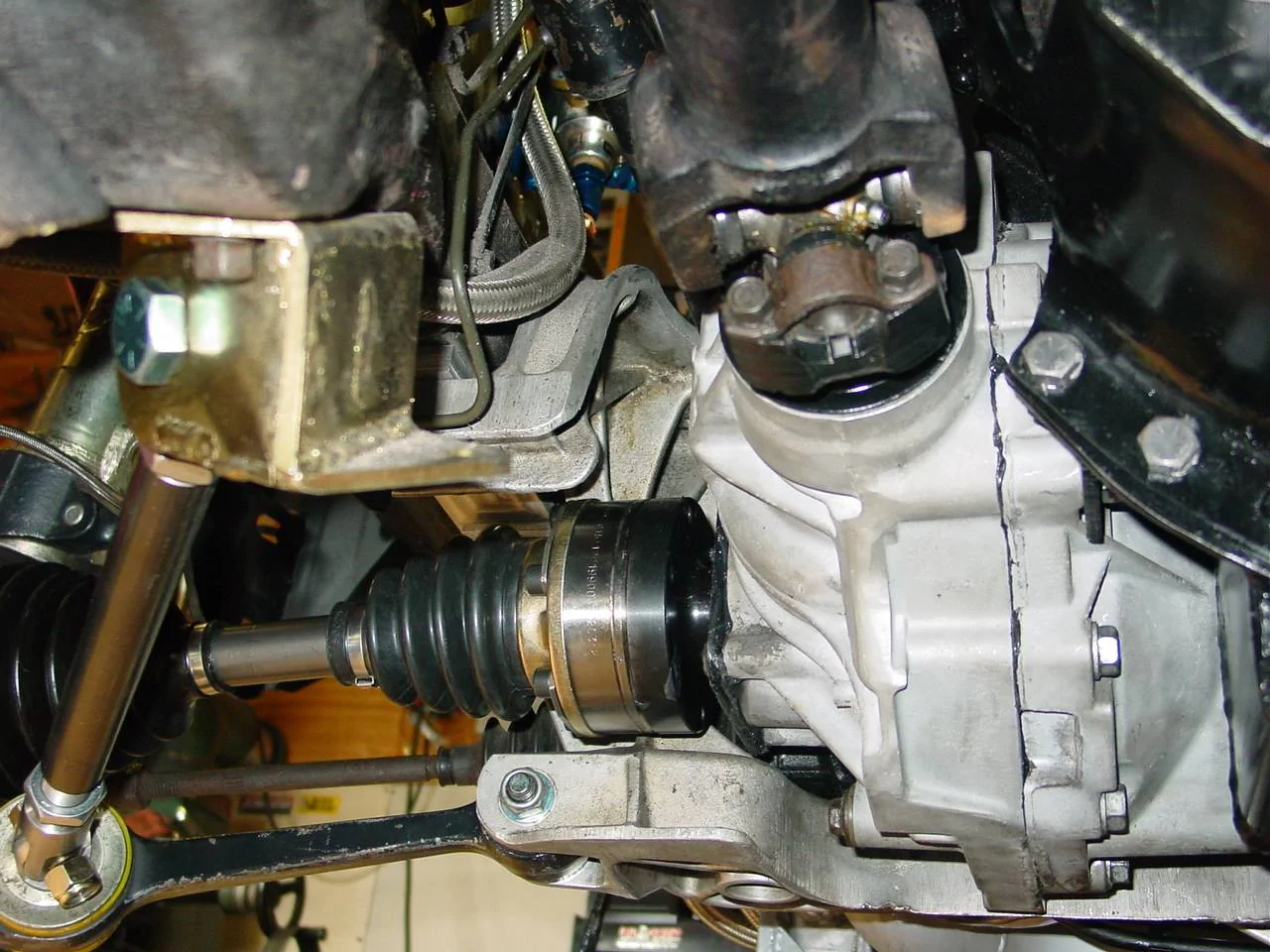

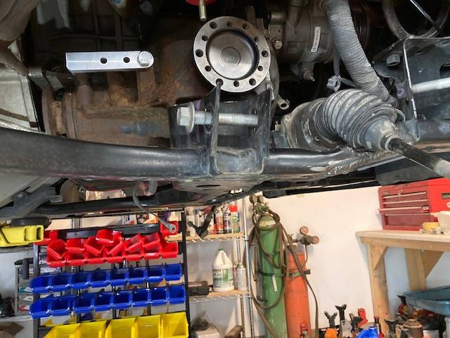

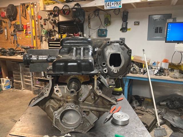

Here are some mock up pics.
I am basically going to start over again with a new front crossmember and oil pan.
More to come!
