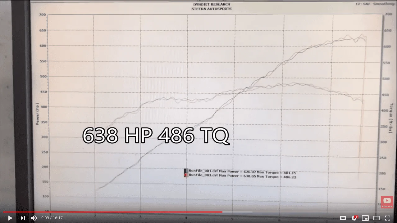

Here is some Dyno's from actual customers and some known names of the stage 1It’s very simple, it does ok, but it doesn’t actually match the Roush, VMP, KB nor our system in boost vs power at pump gas, race gas or E85. Making more power at lower boost is always a good thing.
I don't see how, see above replywhipple dropkicking edelol in the face... again
Again, your talking about a 2018. The graphs you show, the difference is timing. 1deg of timing on our system is 22-28rwtrq, 2deg more and you would be in the low 500's. Our original cal, which this has, was extremely conservative on timing at lower rpm. We released an update a few months ago that significantly picked up power. We've got a new update coming next week that is even a further refinement after thousands of dyno hours with cylinder pressure sensors, etc.Here is some Dyno's from actual customers and some known names of the stage 1

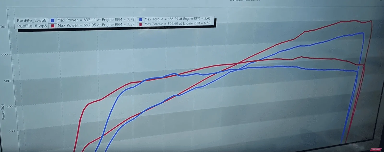

Here is a Stage 1 Whipple(blue) and a stage 2(red) that PBD did on their youtube channel. The 132mm TB helped a lot, but if you look at the torque, you once again see the stage 1 struggling to make more 500wtrq where the Edelbrock has no problem doing so at 3000rpm. WHP is about the same as what I made in 7th as well. So stage 1 vs stage 1, the My Edelbrock makes the same whp as a stage 1 whipple, but about 100wtrq more(60wtrq more if you wanna use my 6th gear numbers).

The Palm Beach Dyno numbers were with their tunes for both the stage 1 and stage 2, so it's not as conservative as the include calibrations with the kit, part of why I also included their numbers. The guys at PBD know what they are doing too. It will be hard to do apple's to apple's bc of all the differences between the 2 though so for now this is all we can go off of. My goals for my personal car is a good 950-1000whp, so we'll see if I can get it done. They had one L und did that made 960/869, so 1000whp should be achievableAgain, your talking about a 2018. The graphs you show, the difference is timing. 1deg of timing on our system is 22-28rwtrq, 2deg more and you would be in the low 500's. Our original cal, which this has, was extremely conservative on timing at lower rpm. We released an update a few months ago that significantly picked up power. We've got a new update coming next week that is even a further refinement after thousands of dyno hours with cylinder pressure sensors, etc.
But all this means very little since its not apples for apples. Our test was on the same car, same calibration, same cam schedule, same timing, same lambda, same air density, same temps, same exhaust, same cooling system. We showed that if you take out all those variables and just test their best SC available vs ours (at the time for both), then that's what you got. The core product is not as good as others on the market, before you factor in other deficiencies in the system. It doesn't mean it can't meet expectations so it fits with some.
Using some other car for any comparison is your first mistake. I don't know anything about what PBD is doing, they do a great job but I can tell you what we know. They did one the other day that did 540/710 so you can't compare that car to your car.The Palm Beach Dyno numbers were with their tunes for both the stage 1 and stage 2, so it's not as conservative as the include calibrations with the kit, part of why I also included their numbers. The guys at PBD know what they are doing too. It will be hard to do apple's to apple's bc of all the differences between the 2 though so for now this is all we can go off of. My goals for my personal car is a good 950-1000whp, so we'll see if I can get it done. They had one L und did that made 960/869, so 1000whp should be achievable

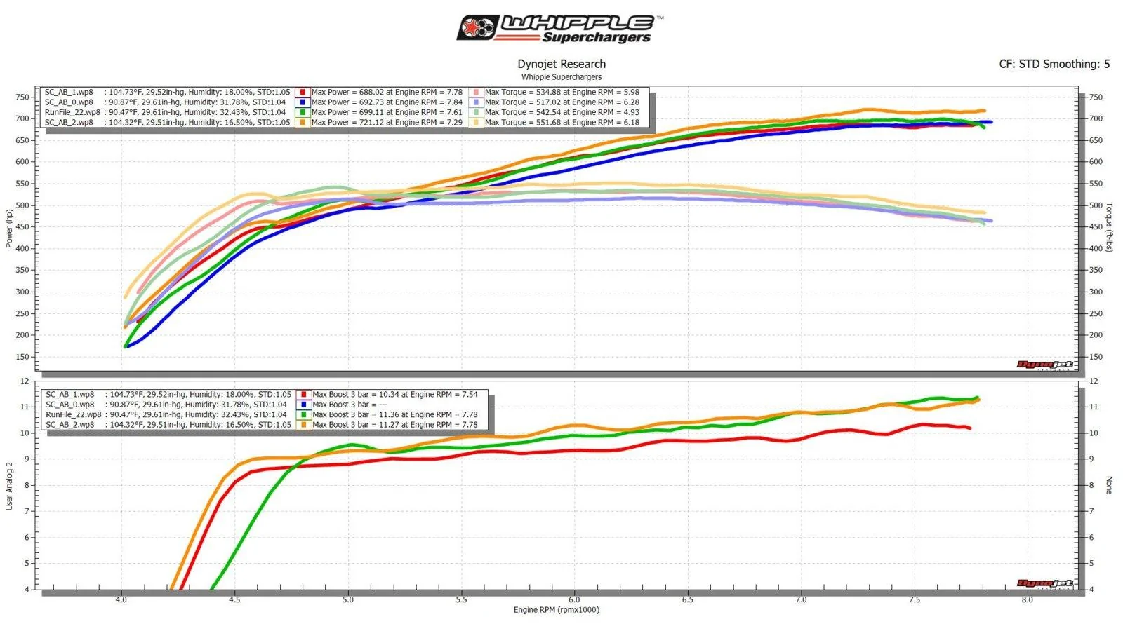

Here's an example of an 18 here while we were doing air box testing. Plenty of low end torque. These are PD devices, they pump more than enough air at low RPM, its all about cam control, timing, lambda to optimize low end torque.

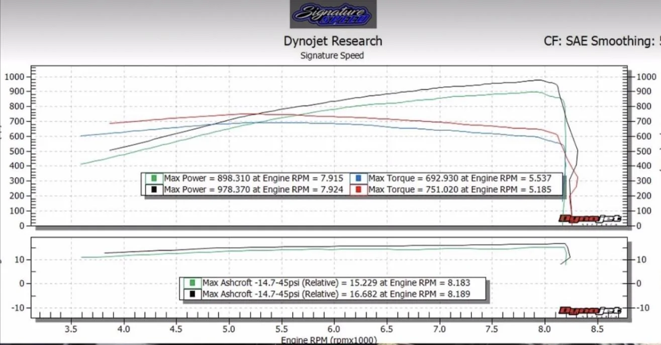

Not for me to get into a fussing match at all but I want to share what I have.
2018 Manual GT
100% Stock engine except Boundry OPG/CG
100% Stock 6-speed trans and clutch
Full MBRP LT headers, 3” H-Pipe with their high flow cats and their chambered mufflers
Full FORE fuel system with controller etc.
Shaftmasters aluminum driveshaft
Whipple Gen5 Supercharger
Standard HE
10 Rib kit with 3.75” & 3.625” pullies
ID1050X injectors, stock DI injectors
20% OD balancer/Pulley
132mm Throttlebody
PBD tuned on E85
The 898 pull was the 3.75” and IMO would have been 900 had it been pulled a little more.
The 978 pull was the 3.625” and again IMO would have been 980 had it been pulled a little more.
I say that because it dips after he is letting off the throttle. The bottoms end TQ on the street is almost unmanageable until I put the drag radials on so if the Edelbrock is making 100+ more torque good luck keeping it hooked because I can’t imagine more than what I already have. I do admire all blowers and other power adders out there and what they have to offer. At the time of my purchase the Whipple was readily available for the ‘18’s so that’s what I went with plus I’ve seen a few now run 9.0’s@157 and as of a few days ago a guy just ran 8.87@157 with his Gen5 so I think I made a good choice. I’m sure the Edelbrock guys will make headway with their product as well. Good luck to all with your cars. Just thought I’d share my data.
