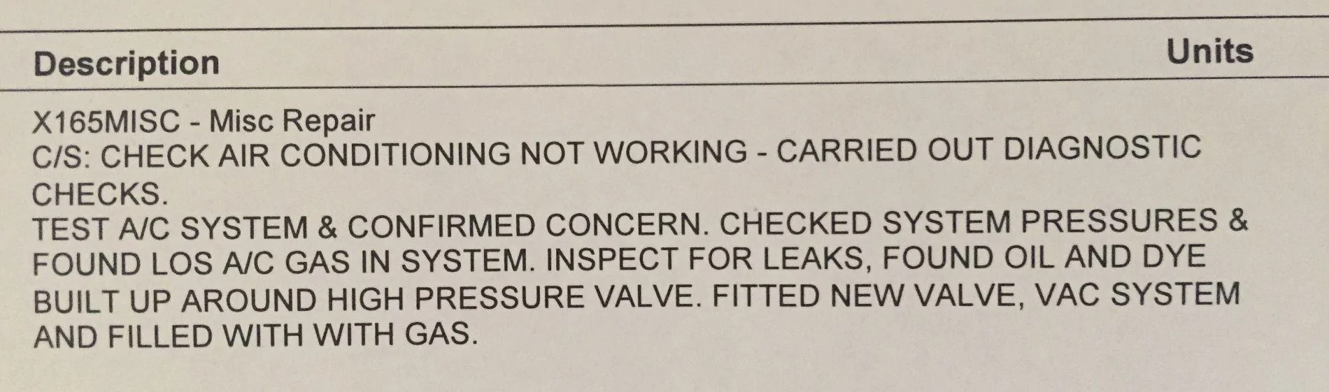

Took it into the dealer today for the second aircon failure.
Told the service advisor that I was aware of the widespread evaporator issue and he agreed that this could well be the case.
This, however, was the 'fix' (he did say that they removed the glove box and checked for dye on the evaporator unit and it seemed to have no leaks).
It's already blowing at inconsistent speeds, so I know I'll be back again soon.
