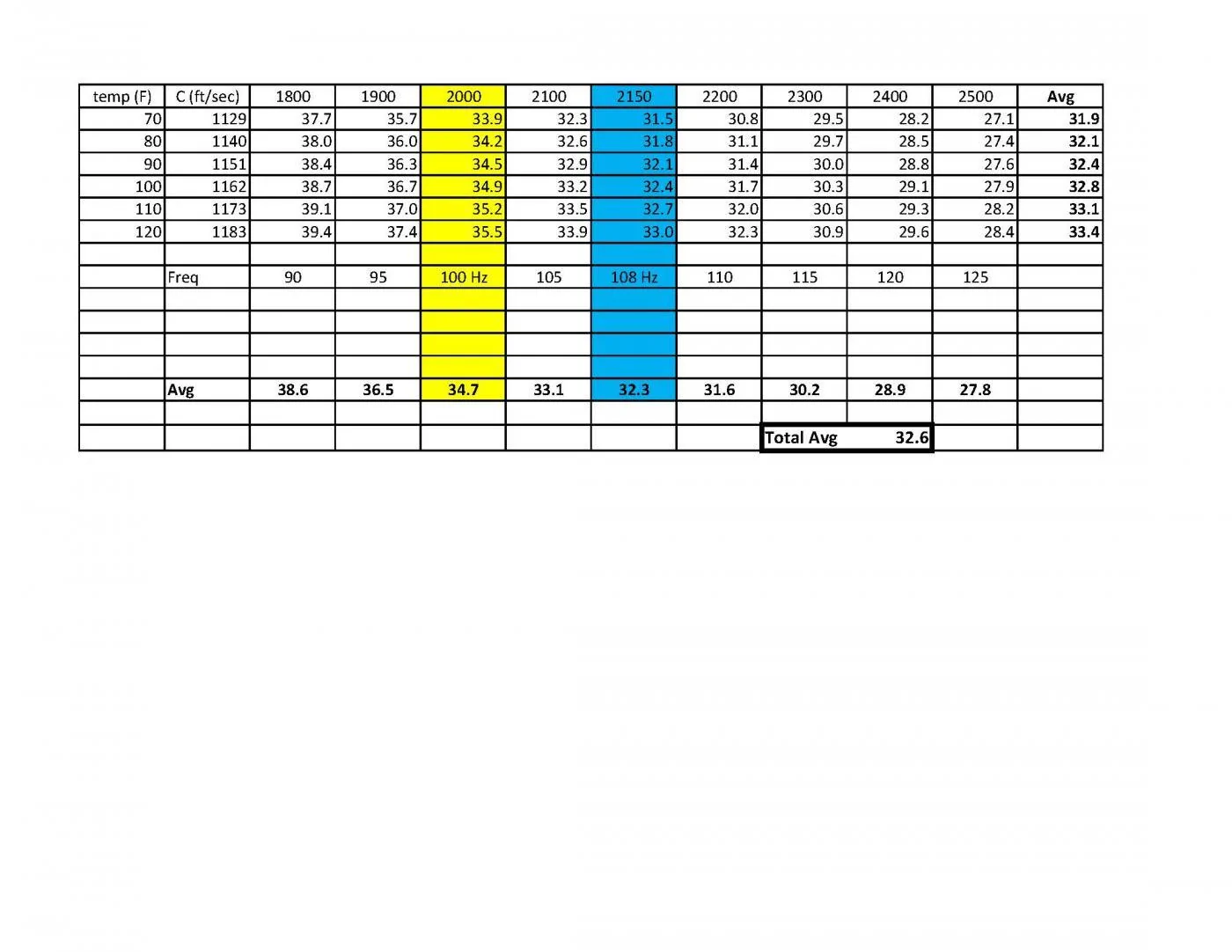

I did not know apps could do this. The one that showed at the top of Playstore list for me was 'Frequency Counter' I'll try it tomorrow. Mo' data, I love it.I just grabbed a free app for my phone called "FrequenSee" - honestly just the first one I saw on Google apps - it just shows the sound spectrum on a continuously moving graph. When it droned I could look and see that there was the large spike at 100 hz. No bells, no whistles, no options or recording or anything.
