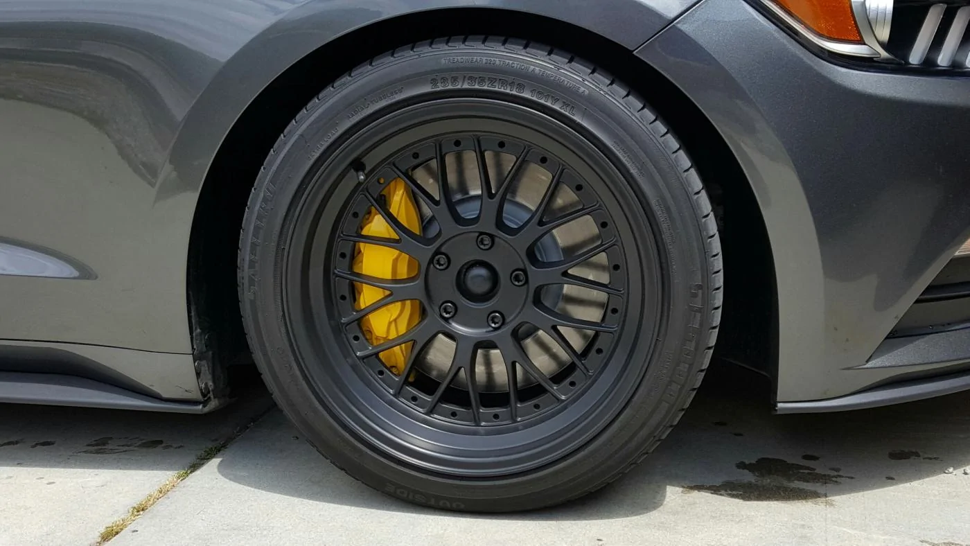

They will however clear (521/18inch wheel) the non PP GT brakes, the 4 piston brake caliper will clear with a small spacer in the front. Great looking & priced wheels for Base GT guys, V6 guys or Ecoboost looking for a winter, DD, track or drag strip setup.spacers wouldnt matter on the 521's, the wheel diameter is too small, brakes hit the barrel of the wheel.
