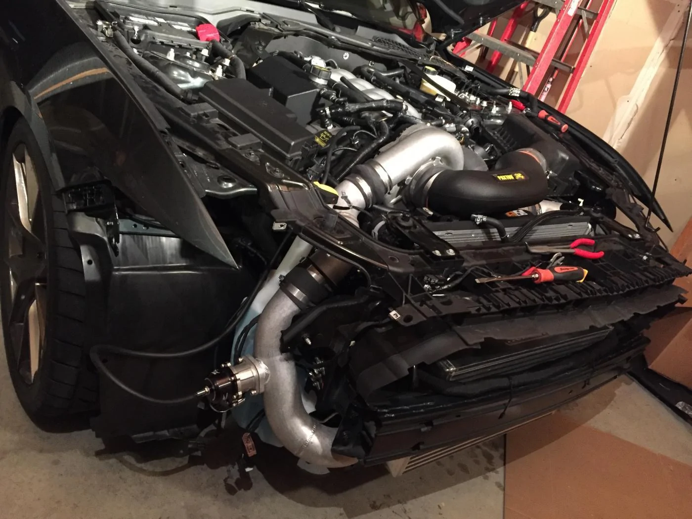

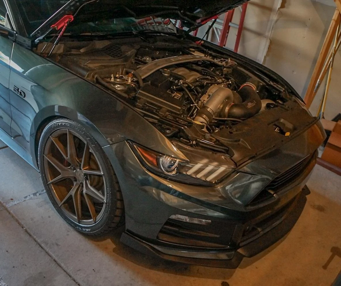

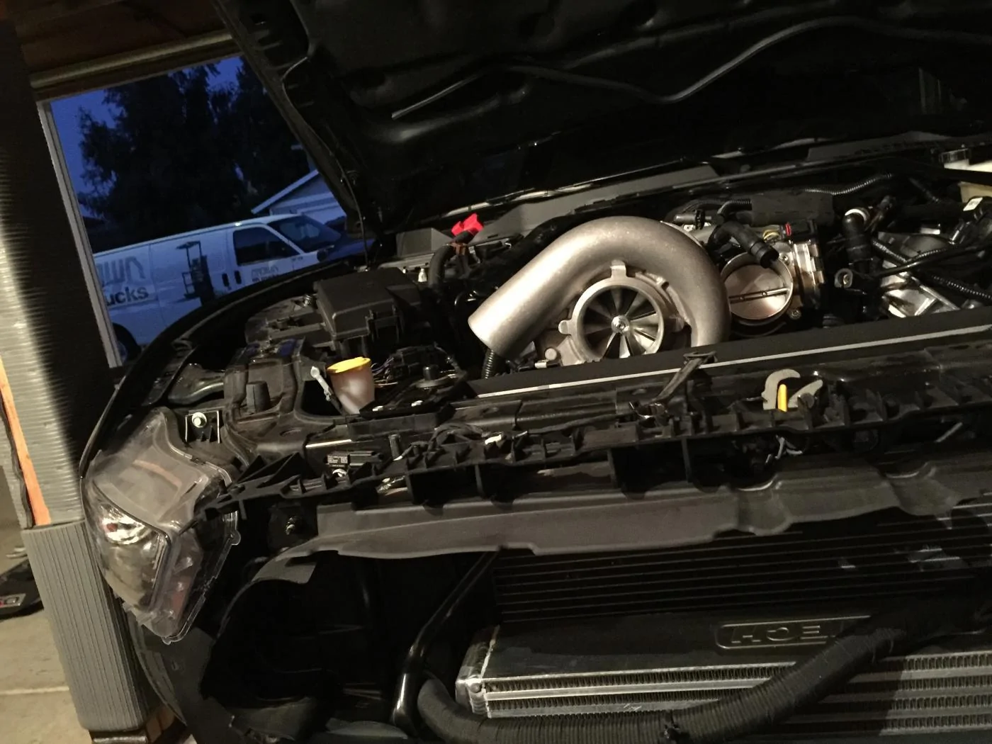

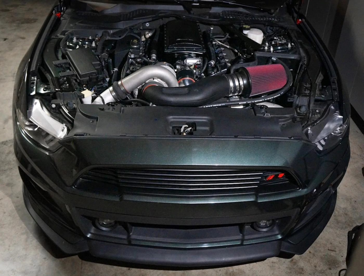

So figured I should start a build thread (probably a little late in) just to show some of the things I've done so far. Had to do a few one off things as some of my mods didn't bolt on with others so here is a list so far:
Exterior:
Roush front fascia
Roush rear spoiler
Painted black roof
Premium rear bumper (still need to install)
Roush quad tip valance (still need to install
Roush hood vents
Suspension:
Eibach sportline lowering springs
BMR cradle lock out kit
Wheels and tires:
Verde Axis wheels 20x9 front 20x10.5 rear
Nitto nt555 275/35r20 front
Nitto nt555r 305/35r20 rear
Engine:
Paxton supercharger

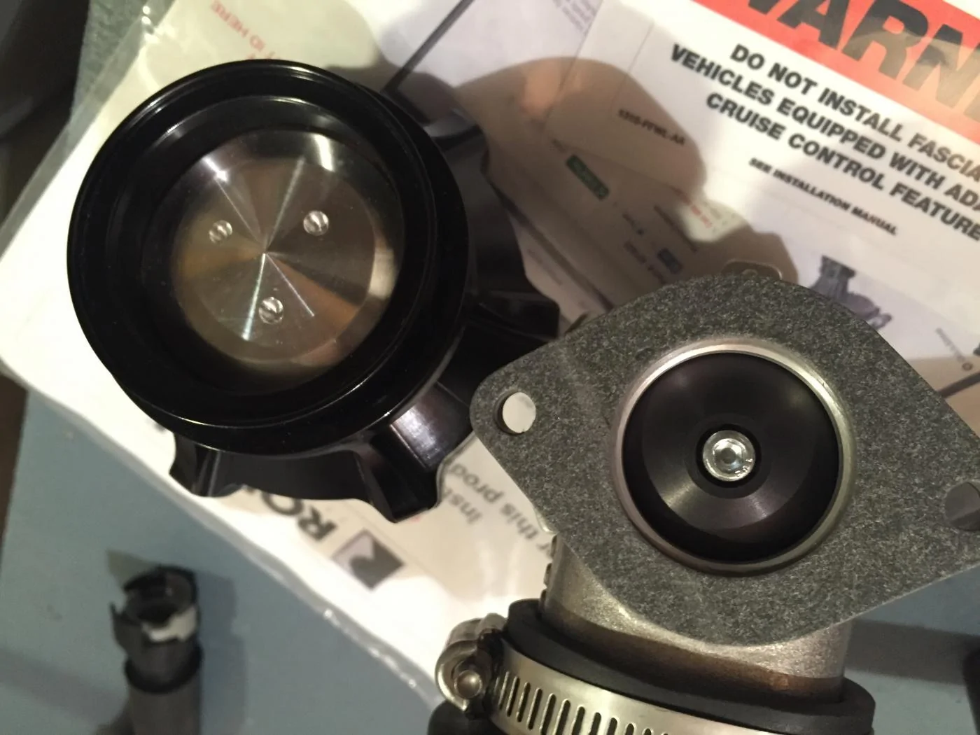

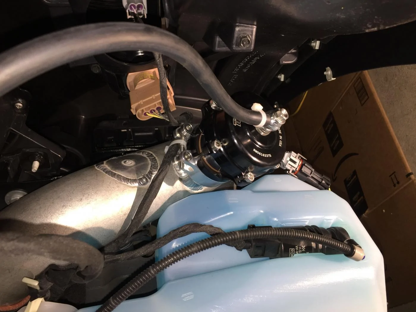

Custom Tial BOV (needed to custom weld to work with roush front fascia as the factory Paxton BOV mount will not work)
3.6" Pulley
Comp stage 2 blower cams
boss 302r primary tensioners
Boundary oil pump gears
TSS timing gear
ID1000 injectors
Holley Hi Ram intake manifold
Gibson exhaust
Stainless Power Long tube headers 1 7/8"
JLT intake for Paxton
UPR oil catchcans with custom air box mount
NGK 1 step colder plugs
Drivetrain:
Steeda clutch line
MGW race spec / X spec shifter
Mcleod twin disk RXT clutch
Mcleod lightened steel flywheel
Currently in progress:
Magnaflow mufflers with custom tips as I will be making my own quad tip exhaust setup to work with the new Roush valance
I have done all the work on the car myself and ran in to a lot of random times where I needed to do some custom modifications which is cool as it made it more one off. I also do a ton of work on other mustangs in my area so I'm always running in to something random. Feel free to leave any comments or questions for me!
