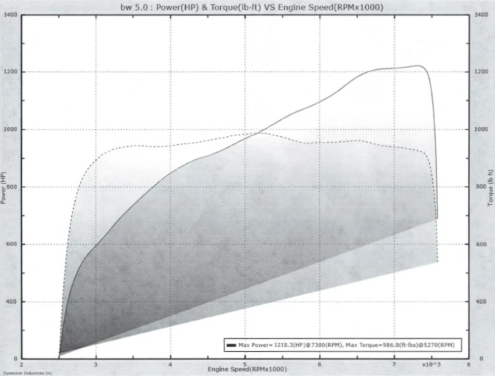

We're going to go ahead and claim the highest HP supercharged S550 on the planet.. After a pulley bump, we've nudged up to 27psi and 1218whp/986wtq!
[ame]
This is only the beginning, as we are going to be switching to a 4.7L compressor (from the 4.2L), and running a dual 106mm TB straight into the back of the compressor inlet. This will require a cowl hood, and some belt/pulley changes, but we think that we can eclipse 1400whp with the bigger blower and some changes.
Stay tuned!
